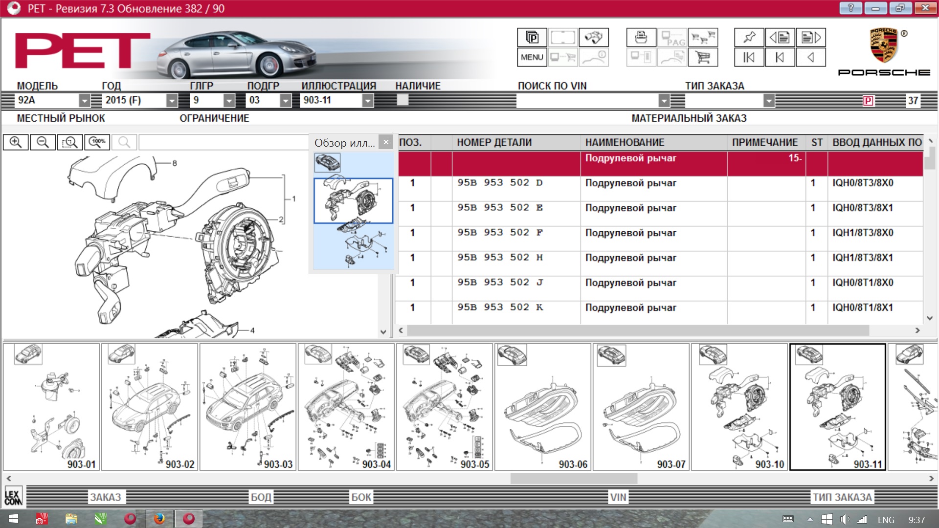

dont hurry up with selling. buy and install control unit behind steering wheel - it need to be also 2015 version. and only then all buttons will work - but after proper coding.

not the clockspring, but control unit with levers. but since it can be bought only together with clockspring - you almost right.
correct coding means that dealer need to be pushed to work hard as they payed )). new unit need to be coded for your car, no more. PIWIS II isnt best workshop tool for upgrading a car because of complicated menus, dont know what will be with PIWIS III which I beleive will come instead in month. but! it can be done, and already done for hundreds here in Russia.
