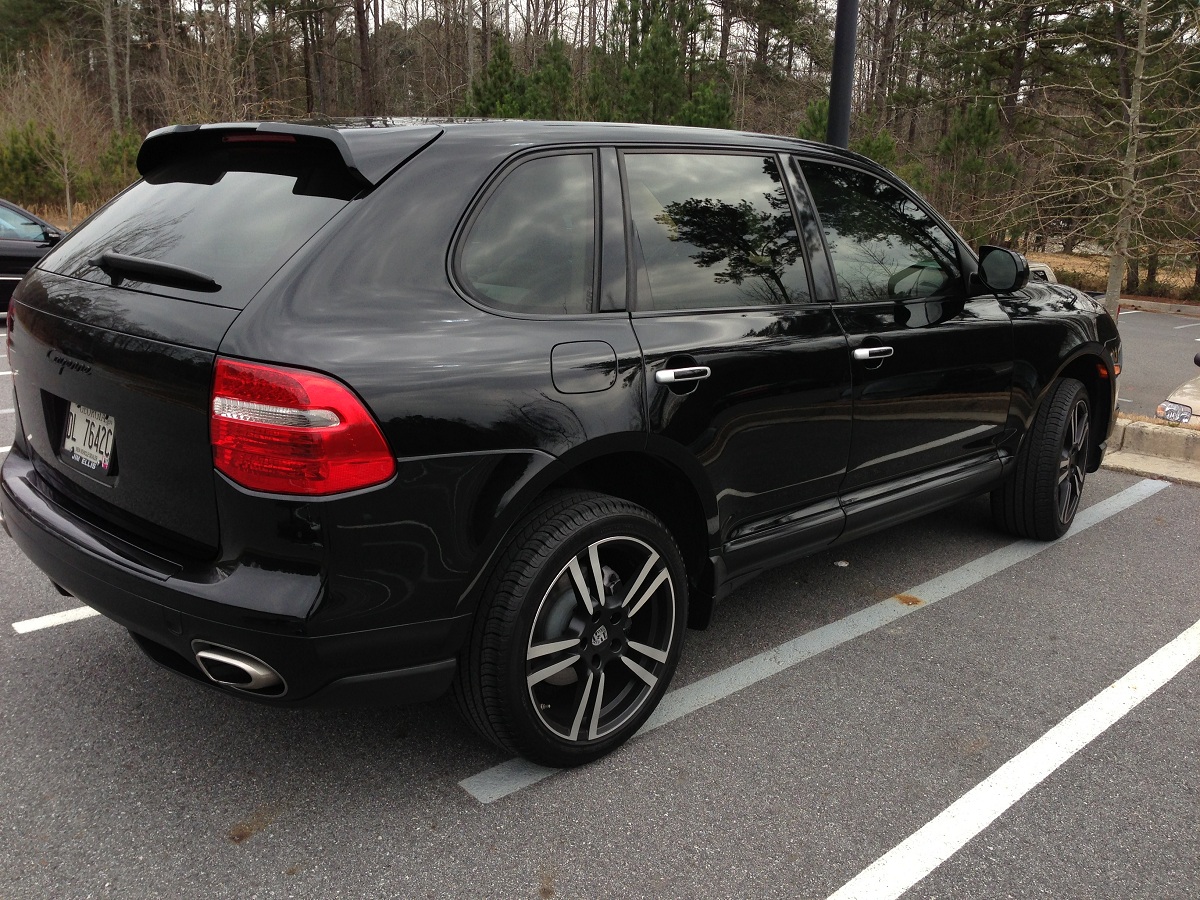

Any suggestions on Lowering Springs for a 2010 Base cayenne, I would like to keep the same ride (not firm it up) just lower the body.

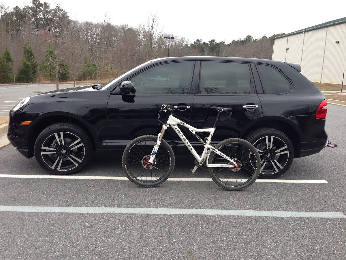

Does replacing the springs VOID factory warranty?
I think I need 2" minimum. Can I do more?
