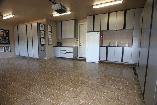

I'm thinking very seriously about installing actual Porcelain Tile... It's durable, long lasting, and washes easily. Buy non slip, and you can make your own designs. Should last the life of your home, if done properly... Oh and Yes it's STRONG
