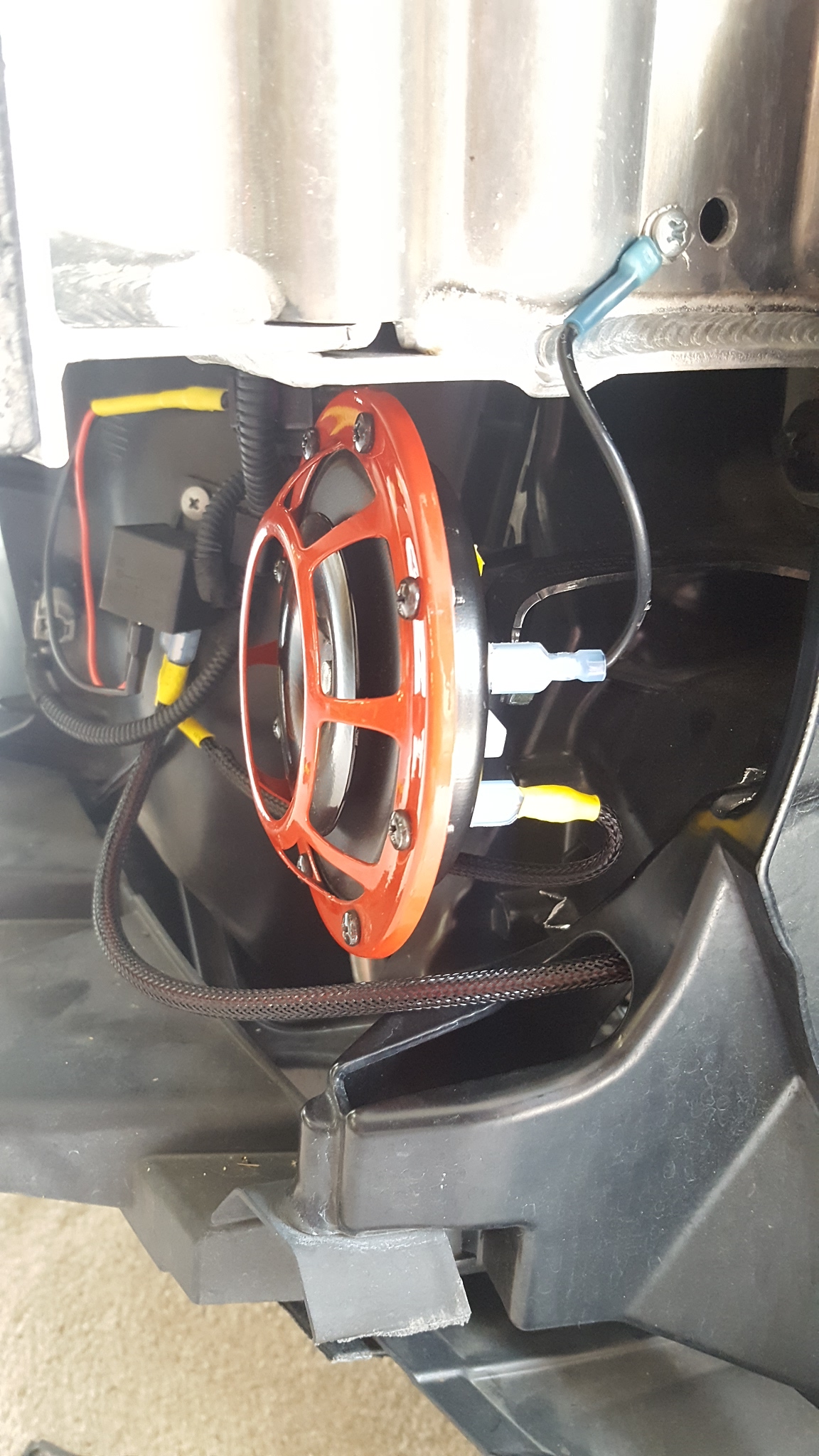

Never mind...I figured it out. I replaced the cheap OEM horns with Hella Super Tones. Since the current provided by the horn switch at the horn electrical connector was weak, I added a dedicated relay to provide a better 12V source straight from the battery. I used the OEM horn wiring to energize the relay. It sounds so much better now.
