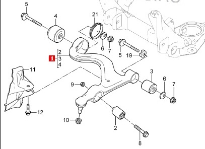

Originally Posted by amgpan
Put it up on the hoist, and discovered the front lower control arm bushes (forward ones) were shot. Fluid leaking out from them.
which ones ? No. ??
Old Apr 17, 2017 | 07:16 PM
amgpan's Avatar
Joined: Jun 2016
Posts: 210
From: Sydney
amgpan is infamous around these parts
Pretty sure it was No. 4
Old Apr 18, 2017 | 01:01 AM
negb's Avatar
Joined: Oct 2015
Posts: 480
From: E.U.
Rep Power: 30
negb is infamous around these parts
Yes, you are right, only this one in lower control arm is hydromount, that's why it was leaking, I've missed that out from first time reading ....
But I see strange code 140245 on old hydromount ... OEM is 97034124502 and 97034124521 from year 2014; hmmmm how to understand this ?
like in this short video on second 14 you can see OEM part number 97034124502:
What you have bought from FCP Euro ? OEM or aftermarket replacement ?
I see only OEM:
https://www.fcpeuro.com/products/por...or-97034124502
Item Porsche Control Arm Bushing (Panamera) - Genuine Porsche 97034124502
Qty. 2 Total $186.58
or aftermarket LEMFÖRDER 35729 01, in Europe at least 3+ times cheaper then OEM
