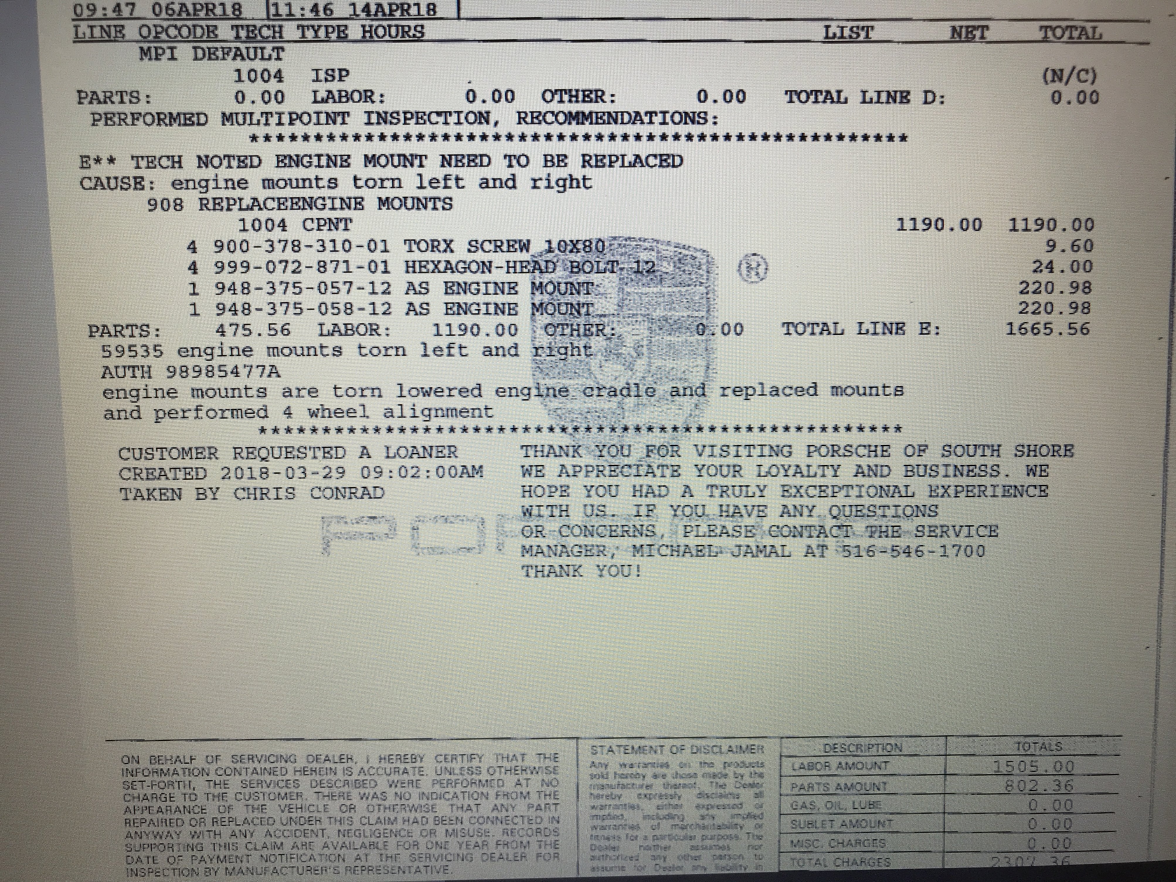

Just had it done at the dealer which cost $1665 plus tax. Which was cover under my Fidelity warranty with $250 deductible and they also change the sway bar links for both side cause my car was feeling a little lose and i thought was the control arm issue again, car runs solid again after mounts and links are change. Attached is the service receipt and had all the parts number. hope it helps.
