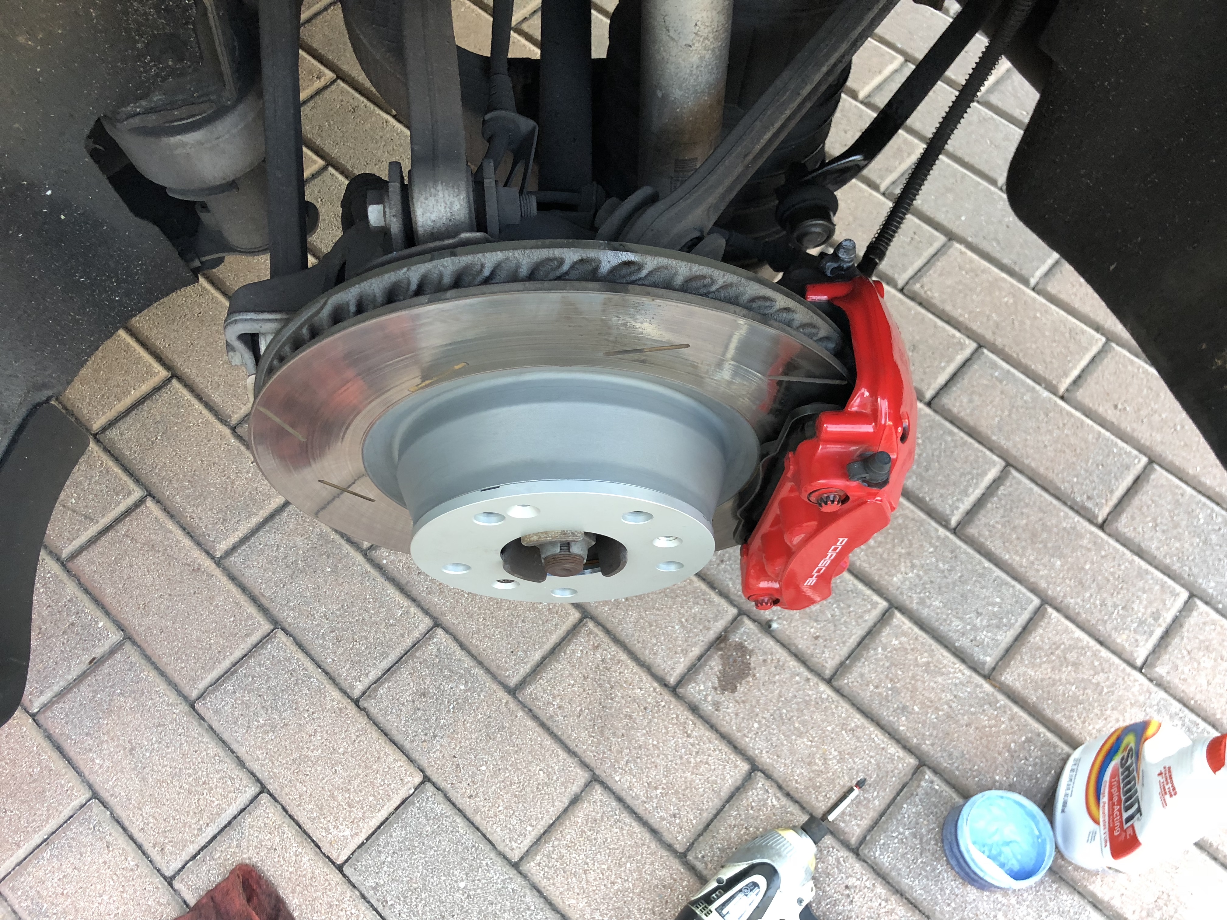

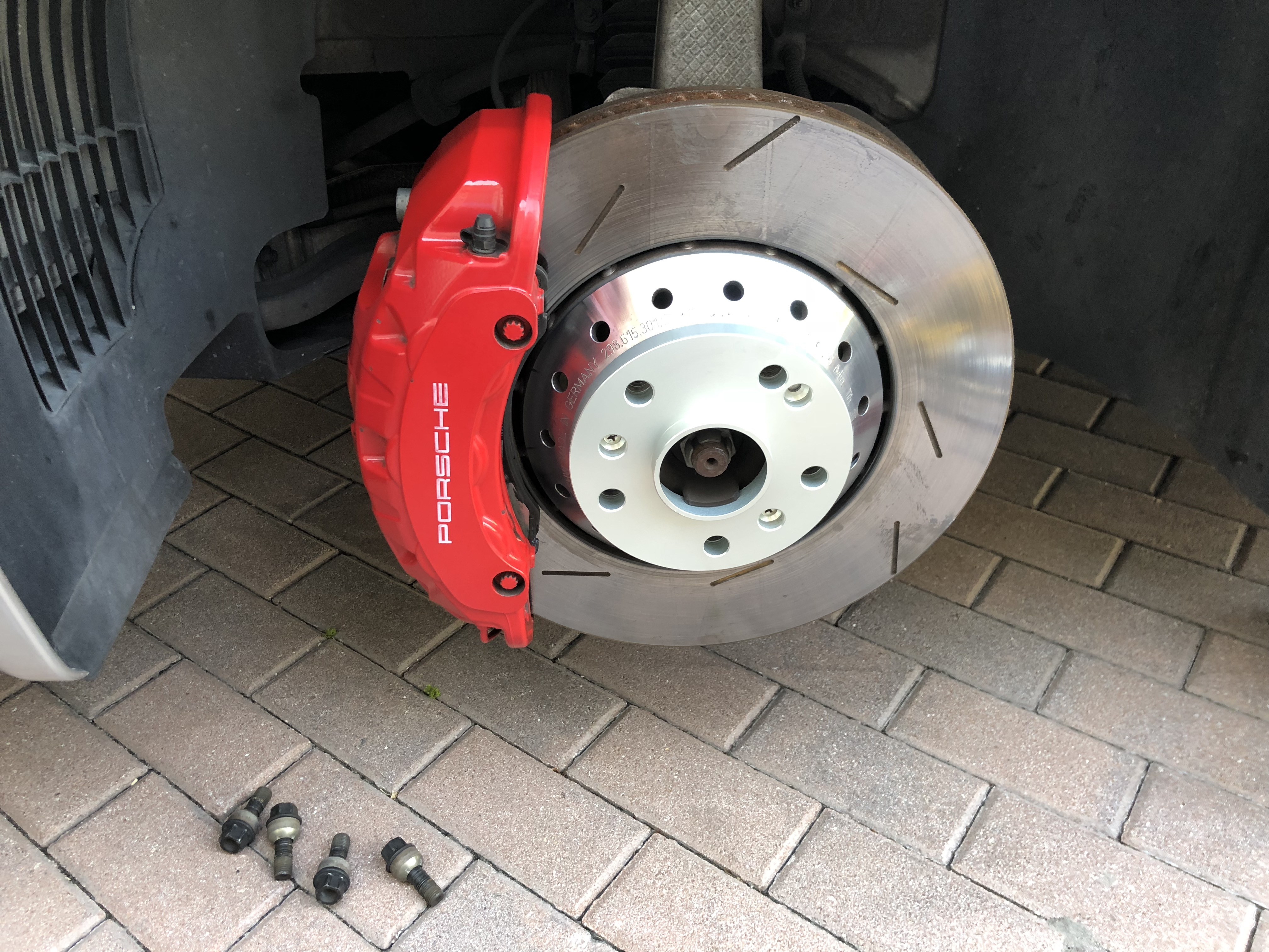

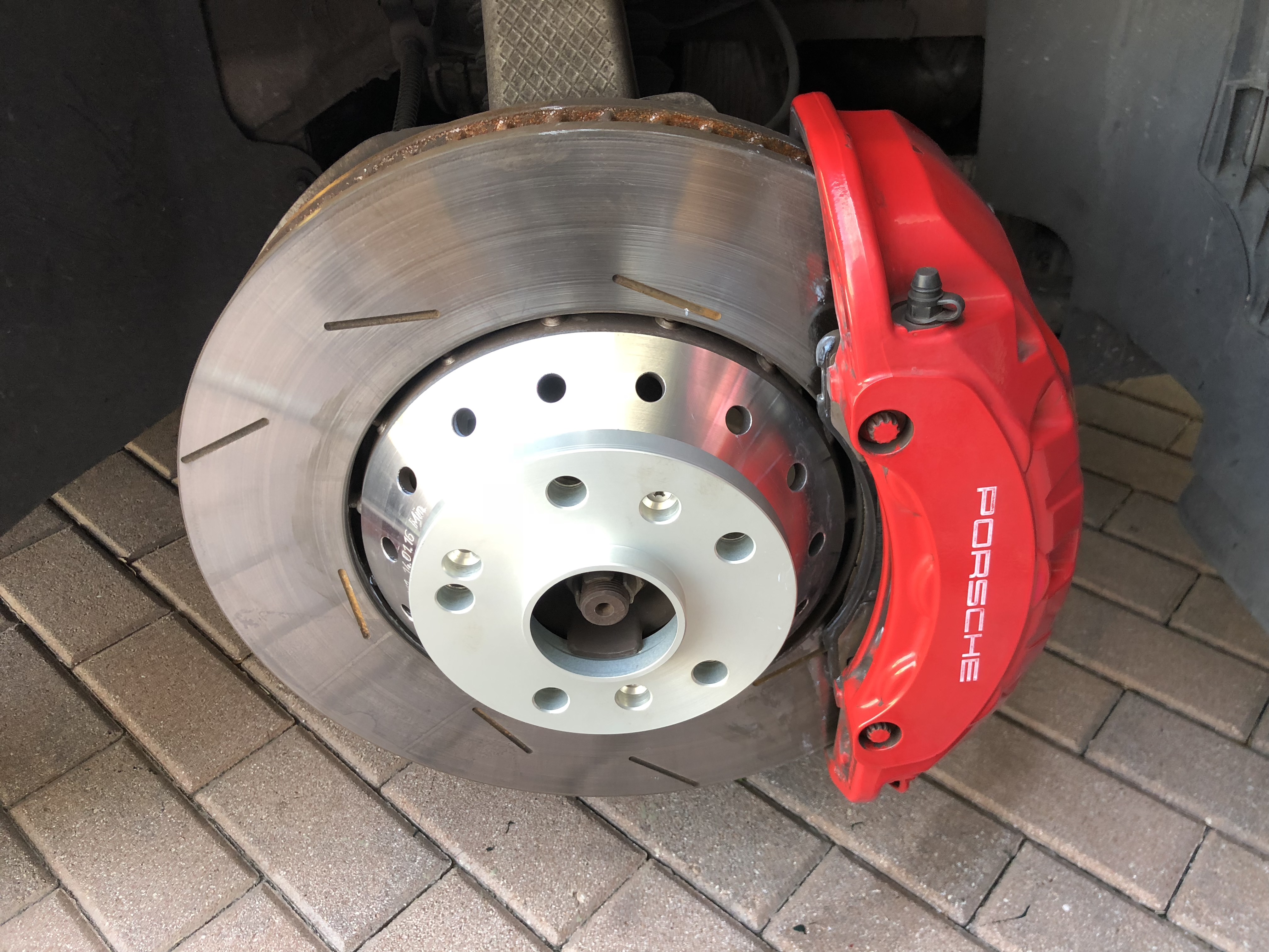

Just installed some wheel spacers from Suncoastparts to Sport wheels, 7mm to the rear and 15mm at front. I noticed significant vibrations to the steering wheel after. Anyone had this issue? Maybe 15mm up front is too much......

Thanks Ciaka for the thorough explanation, the only thing that I can think of is to take off the front spacers and see if they are the culprit. As there were no debris between the spacers and wheels and I did star torquing. I will report back soon.

So I'm happy to report that the vibrations are within normal to none now. I removed the front wheels both left and right. The right side I did noticed something was off when I dry fit the wheel on hub without the bolts installed. I removed the spacer and separated the rotor from seating and sprayed compressed air all over. Then reinstalled the spacer without the retaining screws and mounted the wheel with all bolts tightened, then repeat the opposite steps with this time screwing in the retaining screws. Then retorqued all bolts at four wheels. Went for test drive, very little to no vibrations. Thanks for the input fellas.
