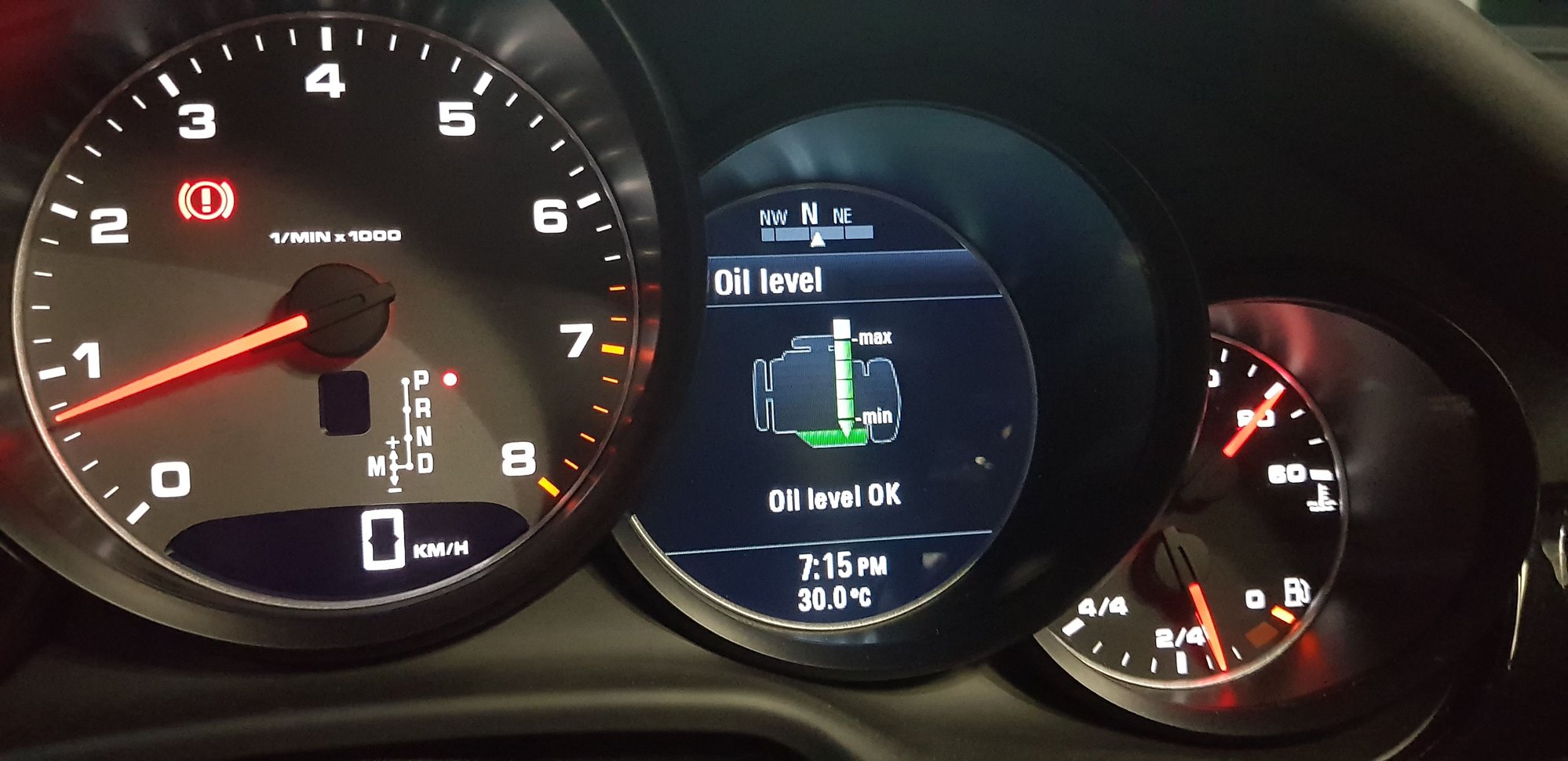

Quick question on segment of oil sticks on cluster display
Originally Posted by ciaka
yes, most already chimed in. 5W30 is not what I would use, but would not hurt the car short term.
Next oil change, use 5W40. I use castrol edge, had great experience with my other porsche and this one too.
Monitor oil as Panameras do consume it, and it varies car to car. Yours should consume less (non turbo).
Make sure it it topped up at least once a week, more often if you drive a lot.
Every segment of oil stick on cluster display, is about one glass full or 250cc.
If you monitor often, you can catch oil when it jumps down one notch. Then you know you are at top of the lower level of oil.
You add in increments of 250cc for each segment. Then, you can measure how many miles it takes to lose one segment. Gives you good estimate for next time.
Good luck. Chose a great car.

Yes red doesn’t mean you’re out of oil but close to a liter low. I remember freaking out when I first got my 4S and it showed red on the highway going back home. Not catastrophic but should top up ASARP.

That is exactly correct. Your interpretation on the picture is correct. Each of the 4 squares on the 'dip stick' picture represent 250cc each, for total of 1L or about 1 qt.
If your car gives you warning showing oil level below the 4 squares (colored little triangle), you are down about 1 quart. This is because engine parts need proper lubrication on all moving components, and specific levels are needed to ensure oil goes everywhere it needs to.
You can still have a lot of oil inside the oil pan, and still be causing harm to your engine, if level is low enough to prevent proper distribution inside engine.
I would always ensure that oil level is at top of upper most square and color of the gauge is always green. Check oil once a week or so and you will do well. My rule is I add 250cc any time I notice the level go down exposing upper most 4th square (my cars is a PTT - which drink oil more).
Good job being interested in your car. The more interest you show, the less hassle you will have later on fixing. Take care and let us know if you have any questions.

Hello! Just sharing my experience. Mine has recently showed 1 bar below max so I followed ciaka's advice: to Add 250cc of oil for a single bar down. That was pretty accurate! Oil level is back to max! Thanks!
