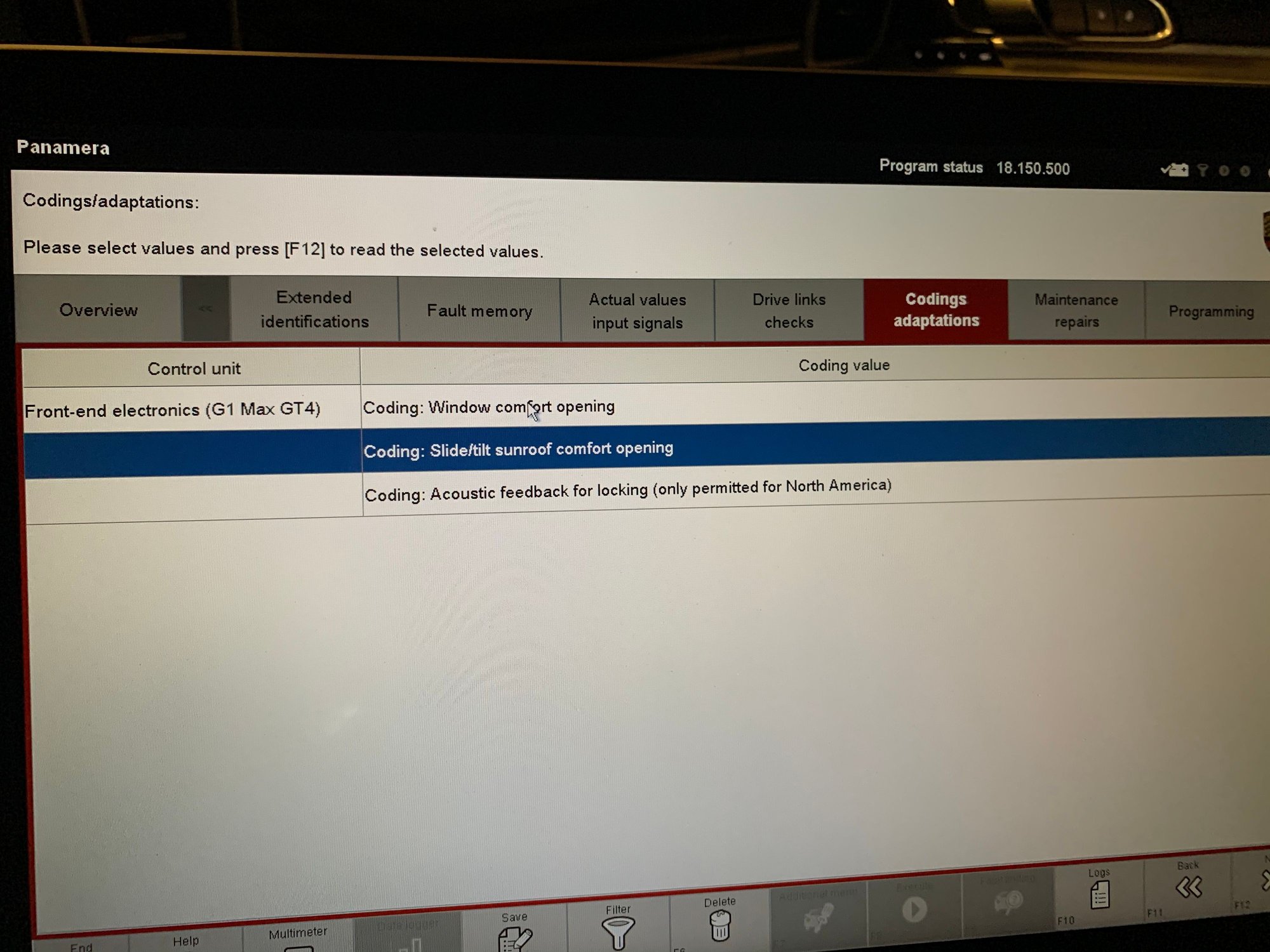

So I figured some of this out today while playing around with the PIWIS 2. It is called “comfort opening”. I figured out how to code the windows down and sunroof open with extended press of the fob unlock button using the PIWIS 2.
Make sure you have sufficient battery charge or, better yet, have a power supply unit (PSU) attached. I’ve written a DIY on making your own PSU for clean power (constant voltage) while coding. It can be found here:
https://www.6speedonline.com/forums/...is-coding.html
Coding comfort window and sunroof opening:

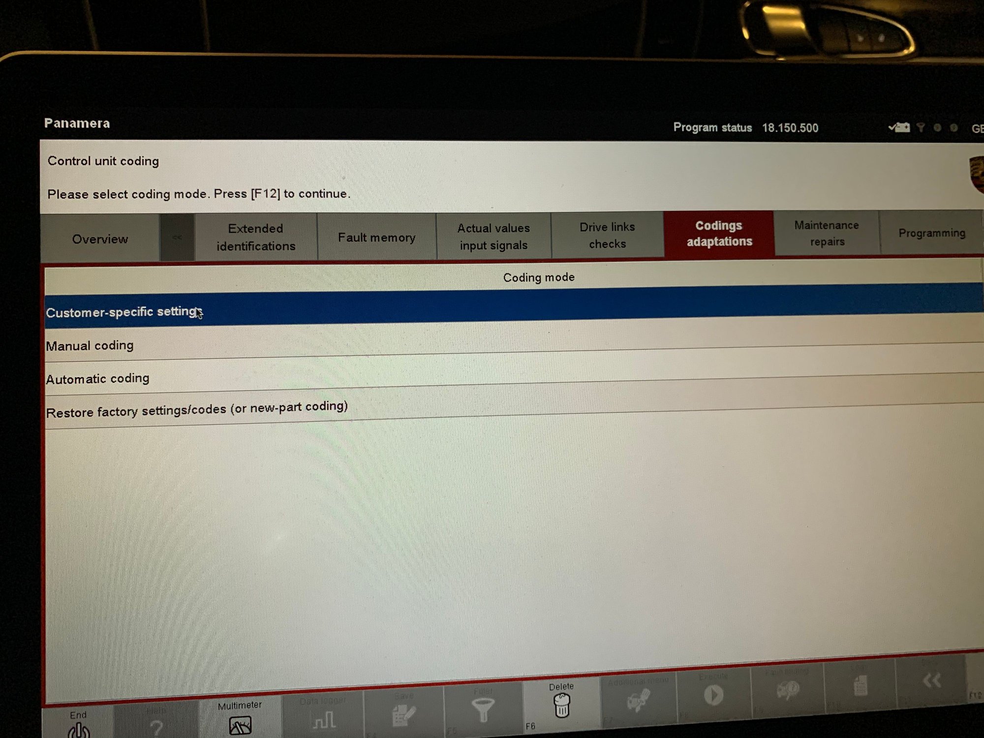

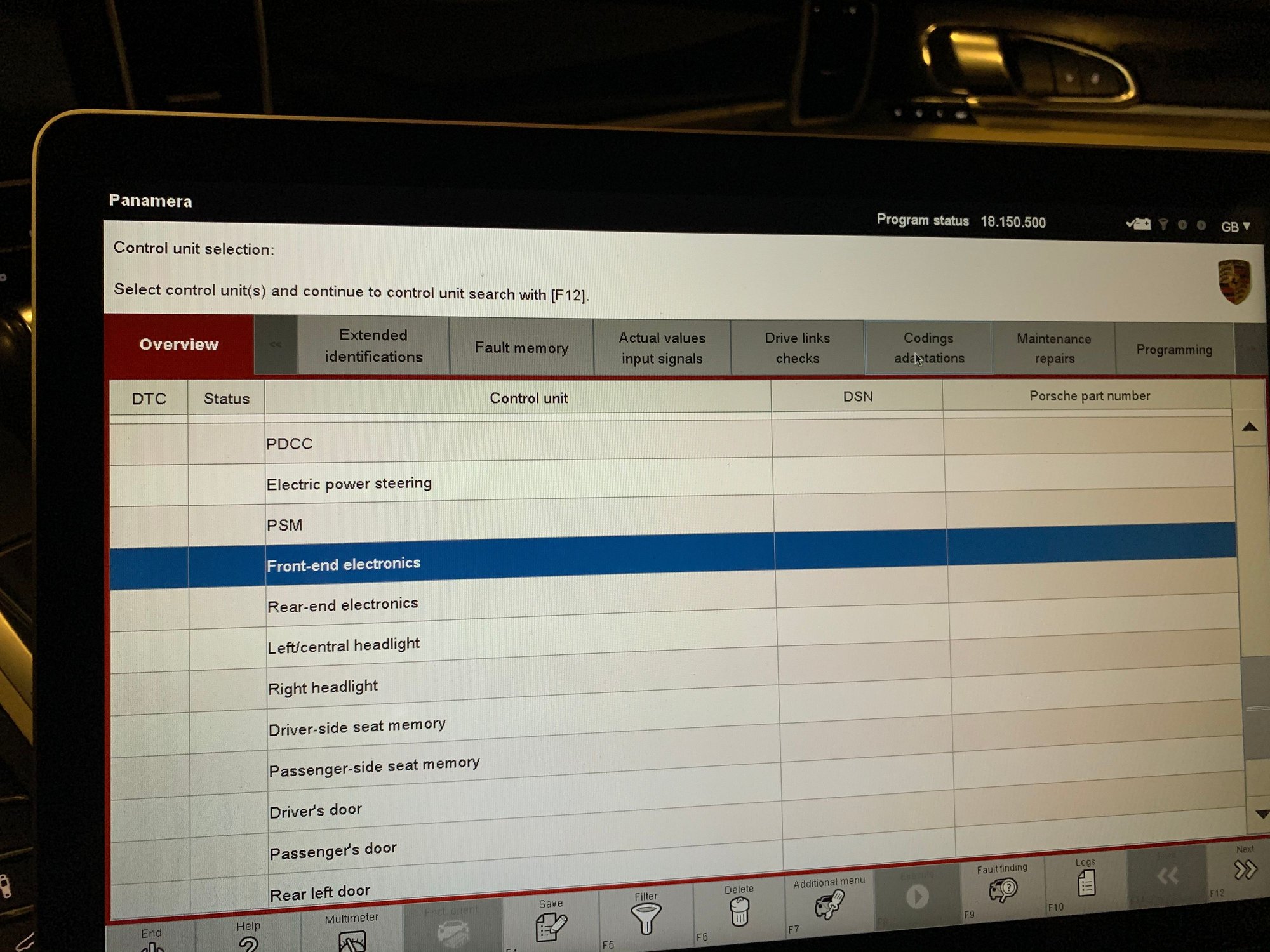

1. Select the Front-end electronics module and then click Codings/Adaptations.
2. Select Customer-specific settings and then click Codings/Adaptations.

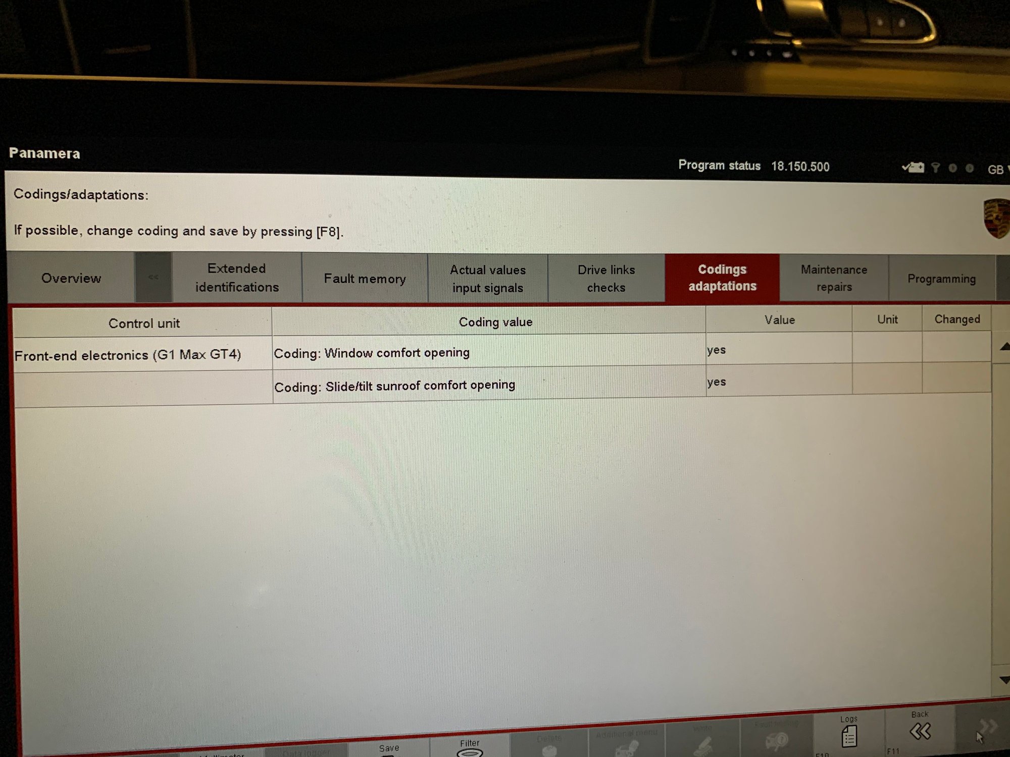

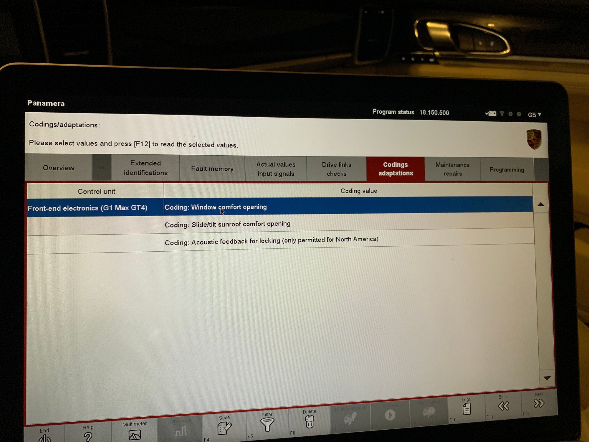

3. Select Coding: Window comfort opening and Coding: Slide/tilt sunroof comfort opening. Then click Codings/Adaptations.

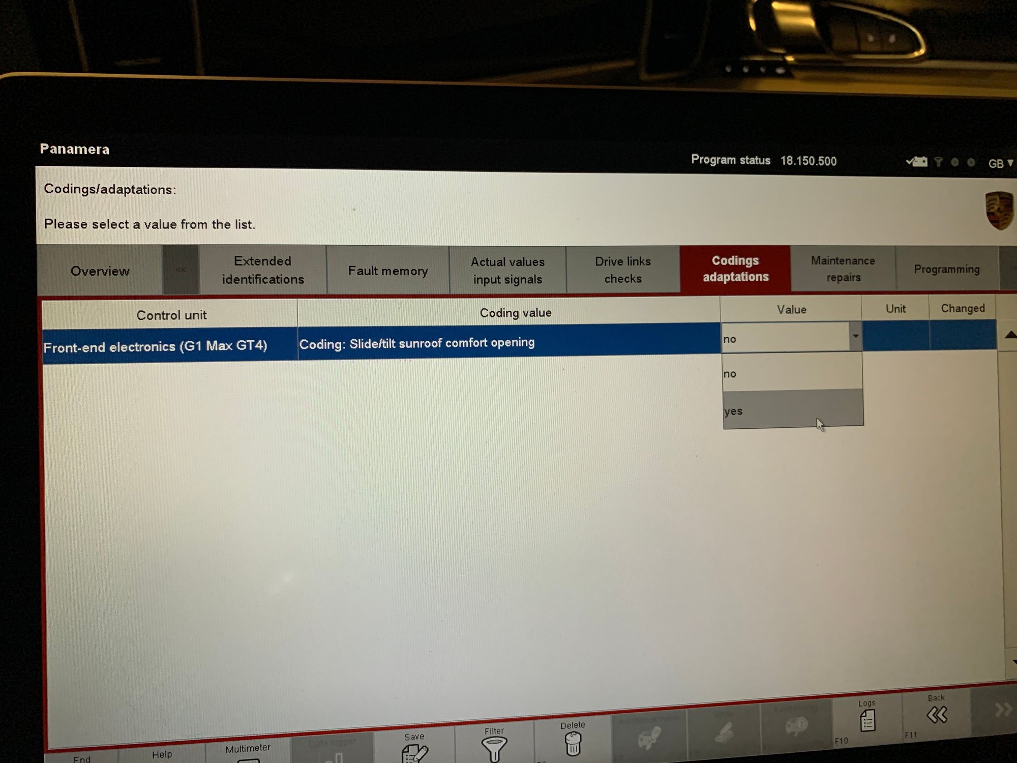

4. Under Value select “yes” for both of these. Along the bottom hit “F4 Save”.

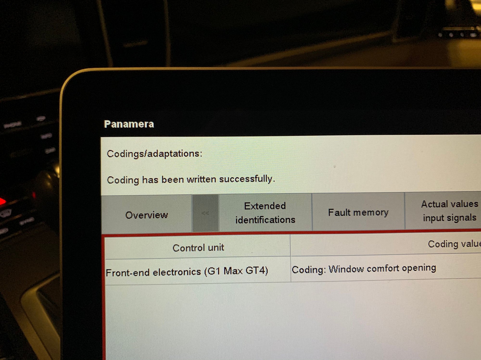

5. You will see “Coding has been written successfully” at the top left once it’s done.
Voila! As you approach your car on a hot day press and hold the unlock button on your car. The car will unlock and then all the windows will open and the sunroof will tilt!
Hope this helps others. Here are some pics to show the steps.
