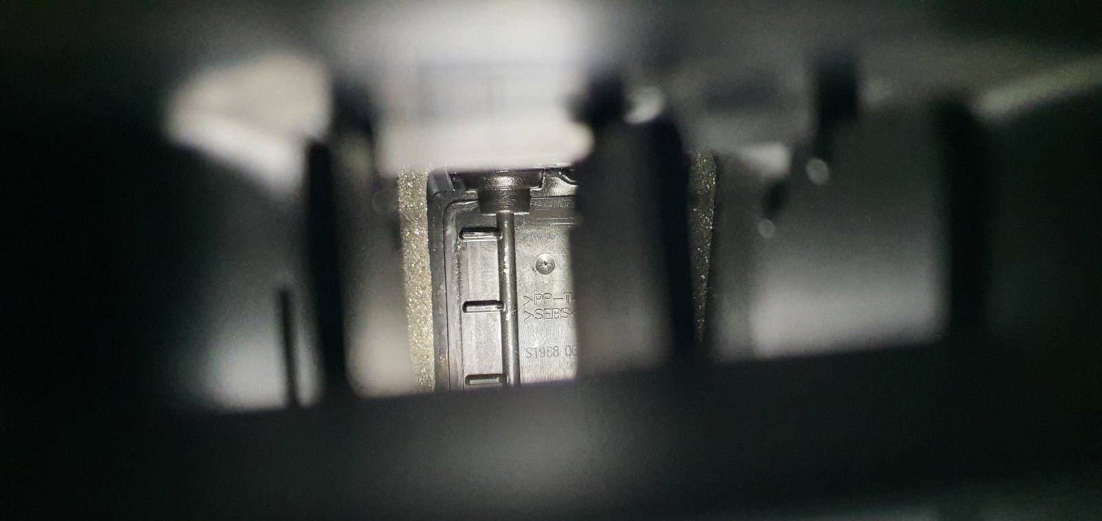

FRONT RIGHT CENTER VENT FLAP IS CLOSED ALL THE TIME (there's no dark space dark space on the left side of the flap? This flap also swivels counter clockwise to open and clockwise to close. It remains this way even if you turn the AC full blast or play around with all of the climate control settings!

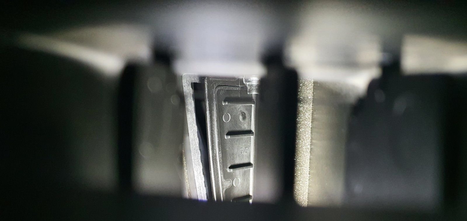

FRONT LEFT CENTER VENT FLAP IS OPEN (see the little dark space on the left side of the flap? That means it's open. This flap swivels counter clockwise to open and clockwise to close. It starts to open when you turn on the AC and gradually opens up more when you adjust for stronger airflow.

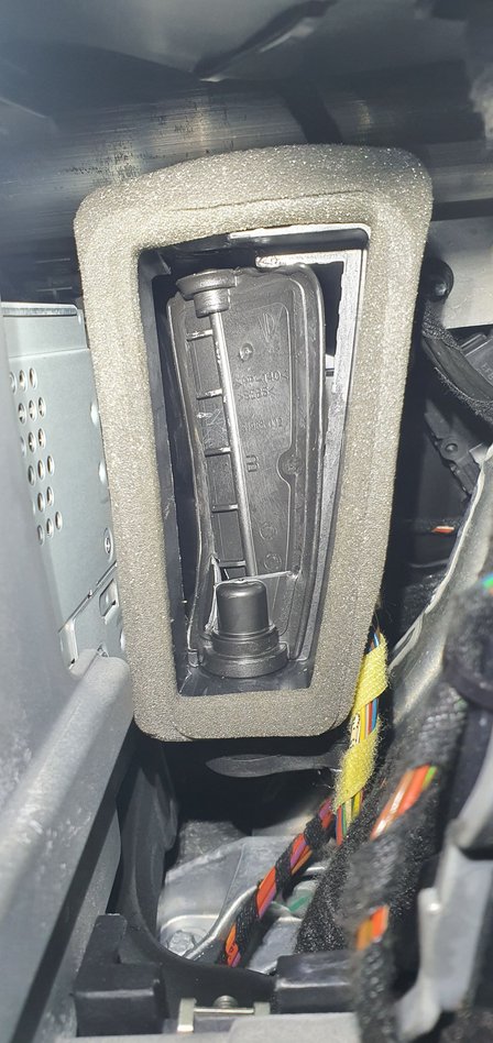

I was able to take out the front right center vent easily with the aid of the tools. Took me about 5 mins to do it.
The vent flap is stuck! Servo motor may be toast.

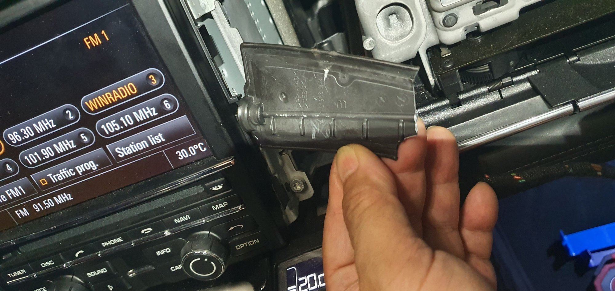

Now unfortunately, the vent flap's servo motor was really stuck. I tried to force it open using a long flat head screwdriver and ended up breaking the flap at the base where the servo motor is. The flap was made out of a very brittle plastic with rubber seals on its sides BTW.
Accidentally broke the vent flap! Plastic is very brittle.
So I just took out the whole vent flap using a long nose pliers since it was fractured into I think 4 pieces - 1 big chunk and 3 small broken pieces.
The broken vent flap.
