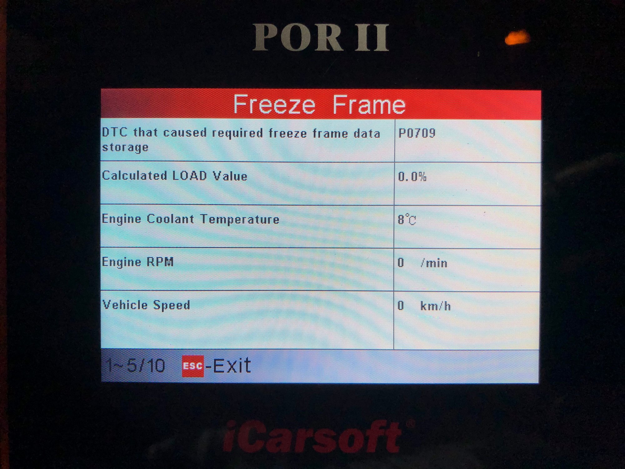

Freeze Frame data attached as requested - it appears the P0709 is causing the CEL.

I note you provided the freeze frame data and it is from DTC P0709 which points to the sensor.
I could be wrong in that one's focus should be on the 'U' codes. If the wiring is ok and you see no signs of water then consider replacing the sensor.

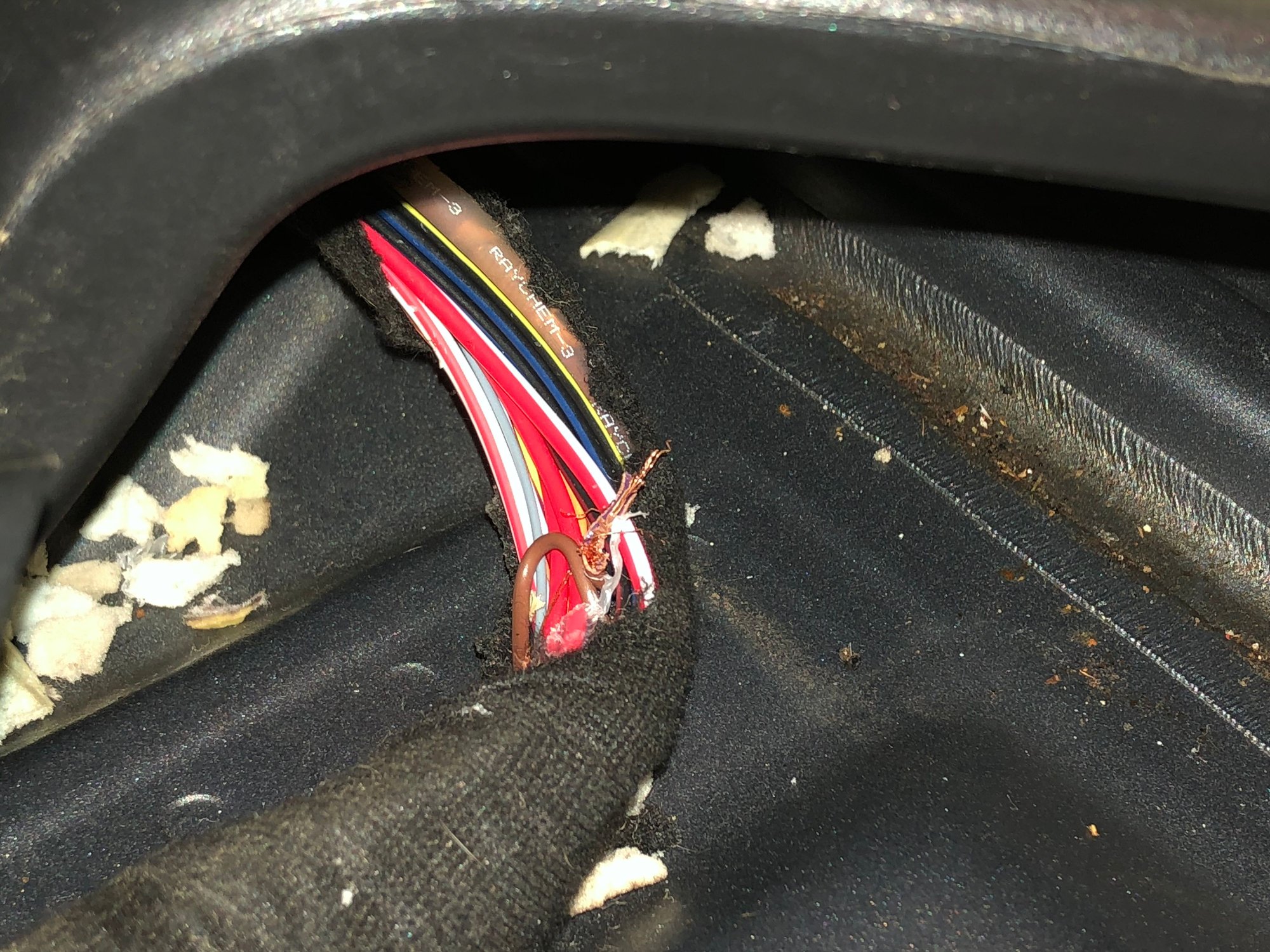

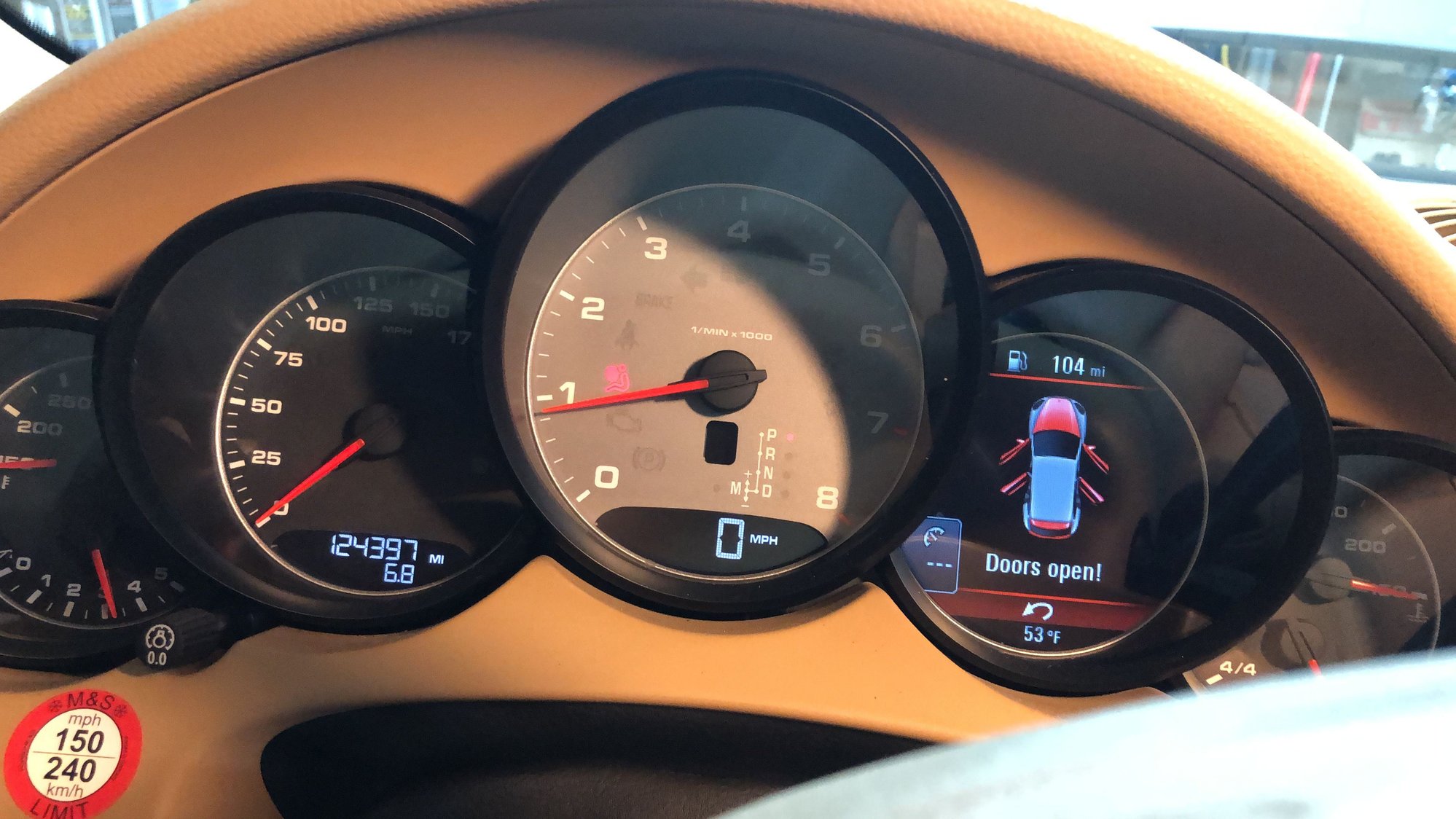

Problem solved!
Spent some time working on the car today and pleased to say I got this portion of it fixed!
it turns out that while the car was sitting in the salvage lot that a small critter may have made it his home and nibbled some wiring. Took the entire floor off the passenger side and repaired two chewed up sections of wiring harness and error codes are finally gone!
now on to getting the seatbelt replaced...
Thanks again for your help Macster.
Section of chewed wiring
More chewed wiring
Errors cleared off dash and gear selector finally working!
