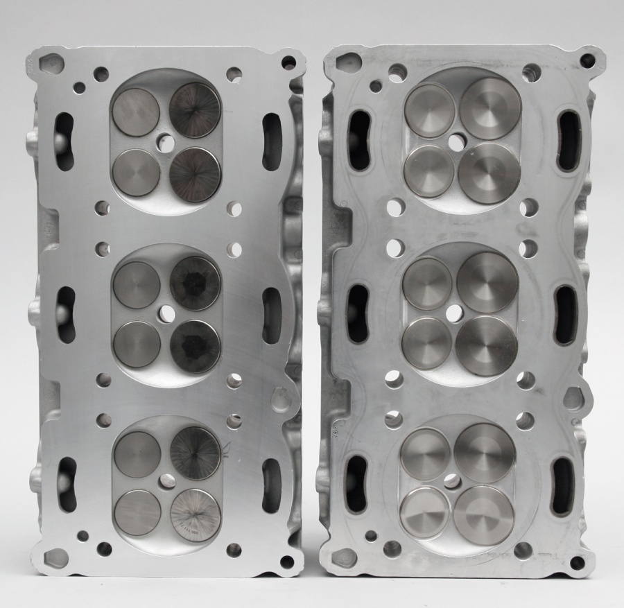

Hey Joe, who the port/polish work on those heads?

It probably wouldn't be appropriate for me to mention who Evoms uses for their work.If they want I am sure they will chime in.I hope you understand.

Originally Posted by art4iza
Joe,
It will be great if EVOMS can come in and chime in to tell us something regarding the specs of the head work.
what specs are you looking for ?They are a cnc'd turbo casting.The valve sizing is the same as the GT3 heads i had previously on the car.You can compare the difference in size to the stock valves compared to the new valves in the pic below.They outflow the GT3 heads i had previously on the car by about 15%.Do you want specific flow numbers?I hadn't seen yours posted so I would need to know at what spec they were flowed at in order to compare.Without that it would be like comparing two cars on different dynos on different days and you know how that goes.

The work looks great and thanks for all the answers. You have PM.
Joe,
I would be interested in knowing how your flows compare to mine. I have had mine posted for some time in my thread, but here they are for those who have any interest.
You say GT3 valve ...... Street, Cup or RSR. Taking a gander from the pics they look to be Cup size.
Flowed at 25” water. Inlet bell and Exhaust outlet used. I'm showing the flow for intake and exhaust at the corresponding valve lift.
lift 0.050”, intake 52.3 cfm, exhaust 40.9 cfm
lift 0.100", intake 97.5 cfm, exhaust 92.2 cfm
lift 0.150", intake 144.0 cfm, exhaust 144.7 cfm
lift 0.200", intake 194.0 cfm, exhaust 179.2 cfm
lift 0.250", intake 237.6 cfm, exhaust 204.8 cfm
lift 0.300", intake 272.8 cfm, exhaust 225.3 cfm
lift 0.350", intake 297.3 cfm, exhaust 238.7 cfm
lift 0.400", intake 310.7 cfm, exhaust 250.9 cfm
lift 0.450", intake 320.9 cfm, exhaust 259.2 cfm
lift 0.500", intake 324.5 cfm, exhaust 266.2 cfm
I was waiting for you to pick that out,because I know you have one.It is highly modded on the inside......I am not using nitrous like you so i can not reap the benefits of that "giant mixing chamber" ......so Evoms changed it to their specs which they felt were better suited to my motor and required some tedious fab work.John told me the reason for the change was after his calculations with the new heads and other bits we still needed to flow about 250cfm more are through the intake.Here's a question for ya Chad....Do you have any idea as to what mph a stock bodied 996 will take flight?I think we are geting closeand I know you are definetly gonna be there when your done....stock bodied or not.
I guessed something was done on the inside judging from the welded up "window" that I observed.
I have been in a 996tt in Germany at 236 mph. I have been told these cars can develop lift issues anywhere above 225 depending on the road and wind conditions. I was also told 242 is really looking for trouble in good conditions.
