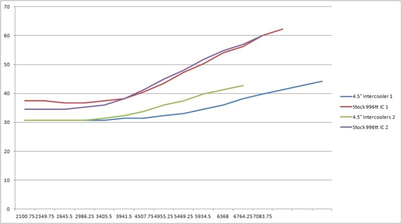

Just for comparison here are my log graphs from my 4.5" coolers. 20deg C delta at 1.3bar. Shows how good the 997.2 coolers are for the money! I wish we could see at what power level the 4.5" units would take over.
What gear and what ambient temp? I've got a bunch of .2 logs at 1.3 bar with 16gs I'd like to compare.

3rd gear about 75F outside and I'm at sea level.
Seems like a good bit of temp gain for both coolers in that short of a pull. Any chance of a boost leak or something?
Here's a 3rd gear .2 cooler log @ 84F:
IATs don't really start moving until 4th/5th.
Regardless, glad the car runs better -always satisfying to knock out a DIY with results!
I guess my responce didn't go through the other day.
I'm not surprised that it cools better. It has a higher internal fin density restricting the air flow to allow better thermal transfer. It's one of the important variables of an intercoolers functionality.
I guess it depends how you plan to use the car. Road racing use where you are not full throttle all the time and don't need max flow, i can see the benifits of better cooling for sure. For street use (short bursts of max power), 1/4 and half mile runs, i see flow being more of a benifit. Turbo size also would also be a factor too. A K16 car would benifit greatly with a 997.2 setup IMO.
