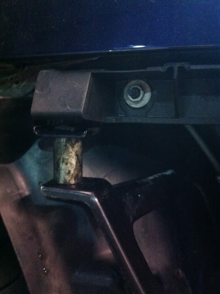

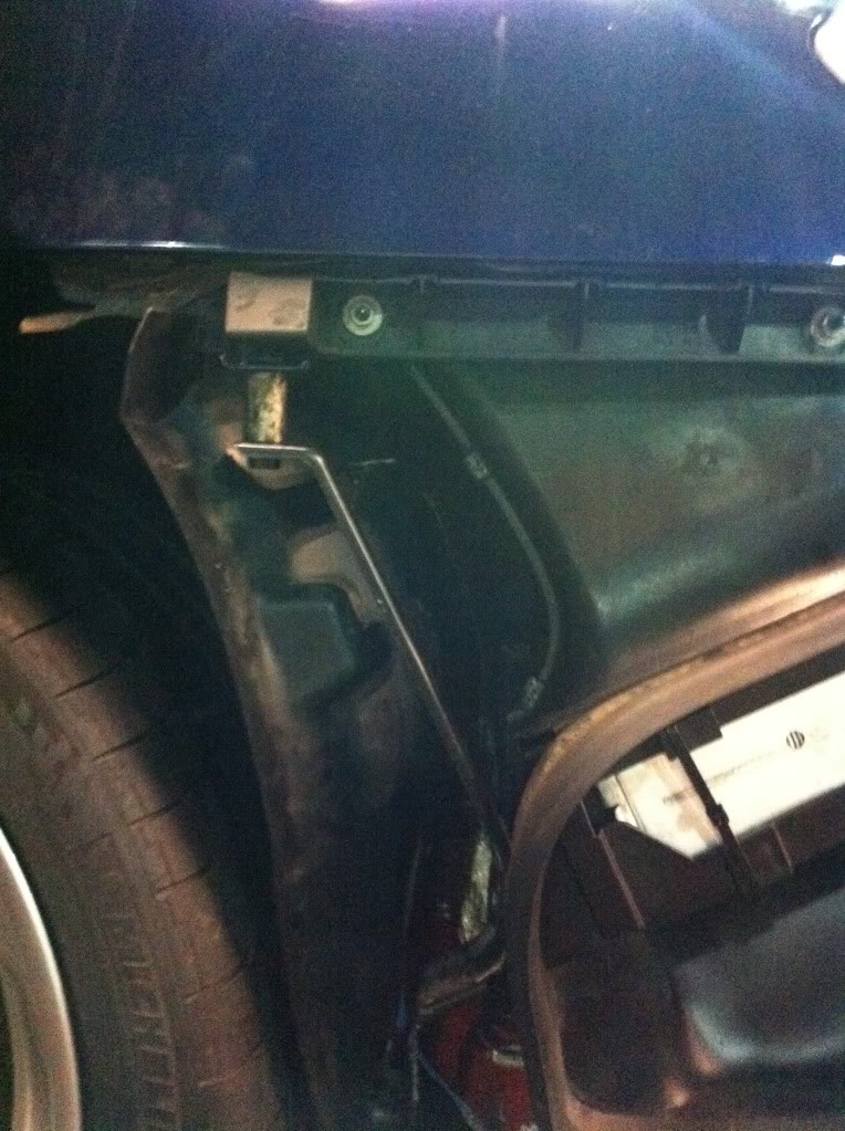

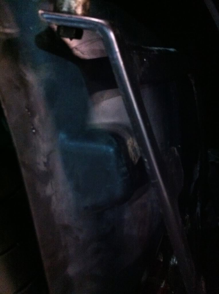

Guys My GT2RS Intercoolers from sonnen dont fit well!! WHat am I doing wrong

Originally Posted by Yazz911TT
With that spacer in above the mounting bracket, it is never gonna fit properly

I had to put the spacer because the bracket wouldn't go any further up. Pushing it hard causes pressure on the end tank on the opposite side against a curved bit of body metal and will result in damaging the end tank!
