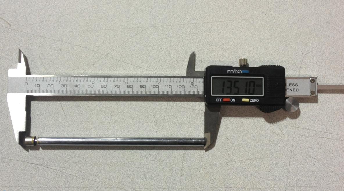

Why not just use an expandable pen magnet and a micrometer? Way, way, way easier.
