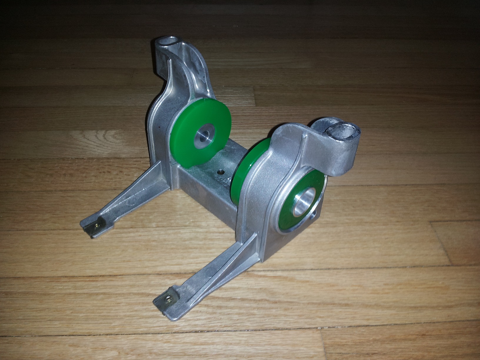

I just installed the Cantrell Motorsports 60 durometer (green) urethane transmission mount inserts. It actually seems quieter / less NVH than my totally shot stock mounts.
Your stock mounts must have been completely gone then.
The ones that I had were also the Cantrell greens. The guys at Cantrell did the install (and de-install) for me actually. They are a quality part and they definitely made it shift better, but for a street driven car with a LWFW, it was too much noise.

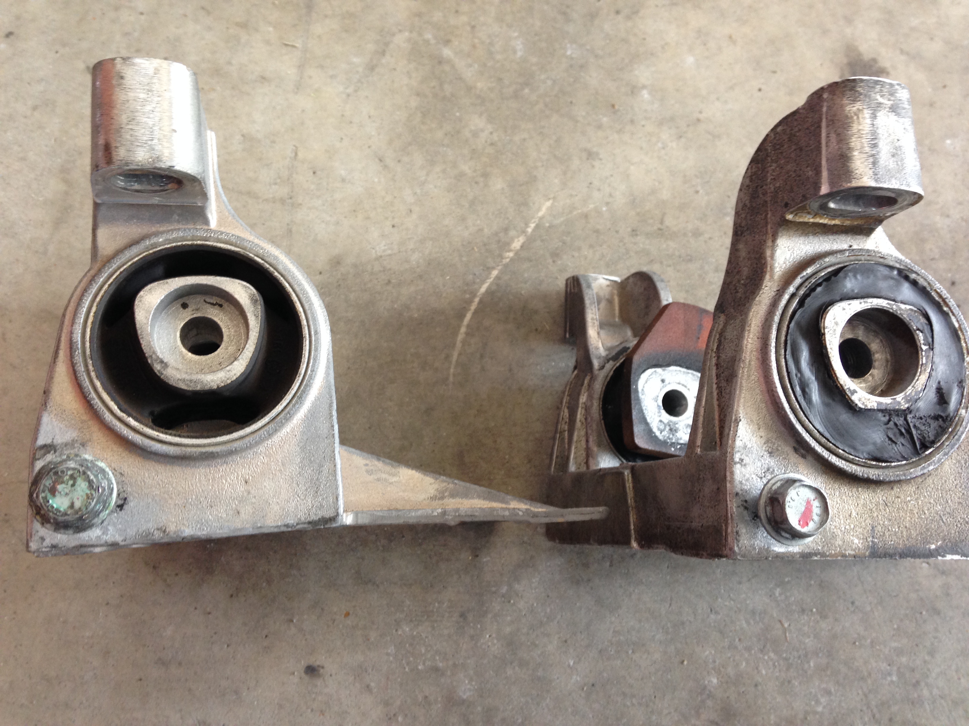

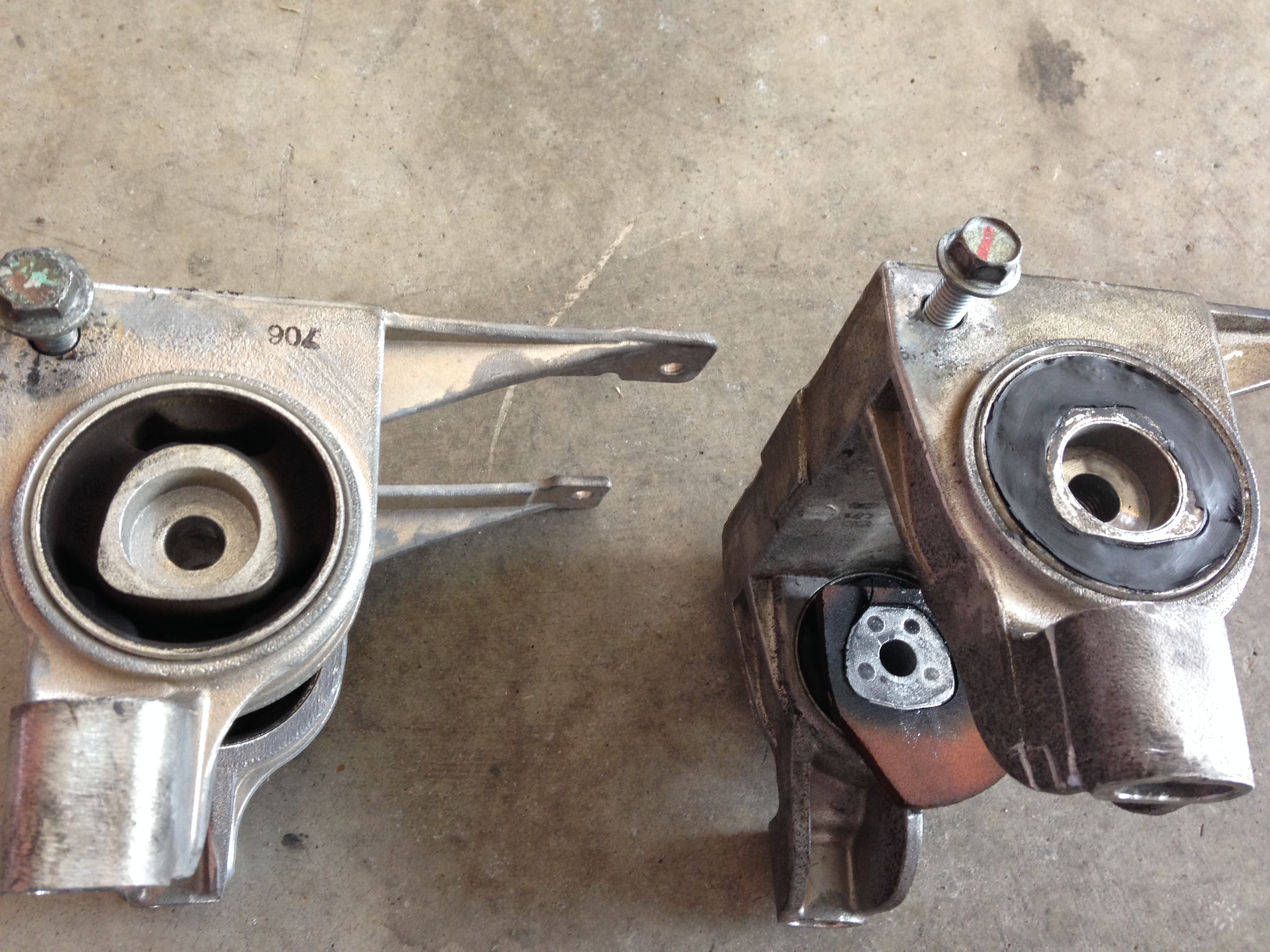

i have pulled my driveline out of both cars this past weekend. the car i just bought has a new 997 trans mount. looks just like the old 996 mount. my old mount that i did a window weld mod on 3 yrs ago is still intact and going strong. no wear at all. 20$ mod that can't be beat.

which filler did you use?
its a 74 durometer rating from home depot. its in the caulking section and just says window weld on the tube
