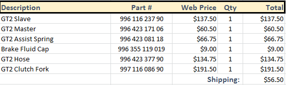

Slider Is a GOD !Slider Is a GOD !Slider Is a GOD !Slider Is a GOD !Slider Is a GOD !Slider Is a GOD !Slider Is a GOD !Slider Is a GOD !Slider Is a GOD !Slider Is a GOD !Slider Is a GOD !
These are all the parts I needed for Tap & drill GT2 clutch slave.
All the other parts in the previous list are for the clutch.
