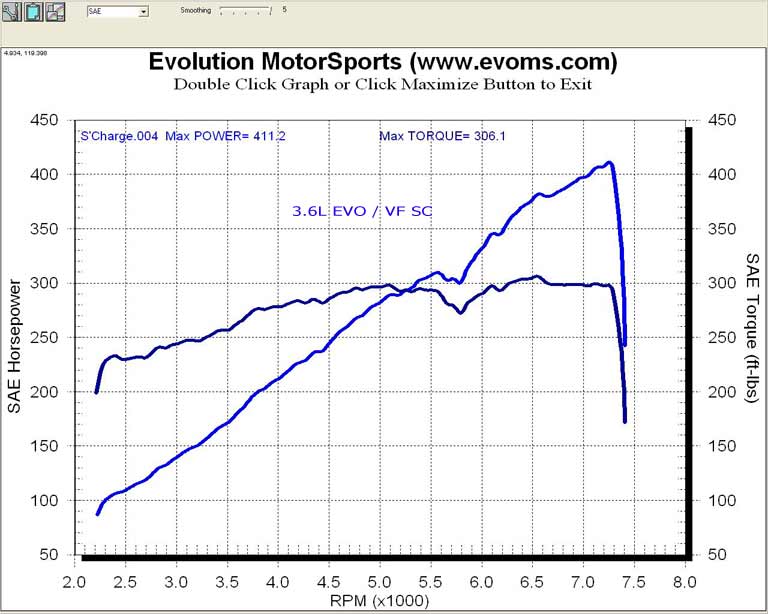

I will review the dynos of our current system later today. As I stated, I am not convinced that the graphs posted are an accurate representation of what is actually happening. Centrifugal superchargers replicate a factory type power curve. We chose to use this type of supercharger for a few reasons.
1) Because it replicates a factory power curve, it is not as hard on the OEM drive train and clutch.
2) Centrifugal superchargers typically are installed on lower displacement higher revving engines. Other tuners such as Dinan use the Vortec unit on the E46 M3 etc for this reason. You will find the positive displacement supercharger on V8 engines that are use generating a tremendous amount of bottom end TQ, unlike the Porsche 996/997. We feel that the centrifugal is a better fit for long term reliability on this specific engine.
3) The Vortec unit has proven itself to be a very reliable as has the Eaton.

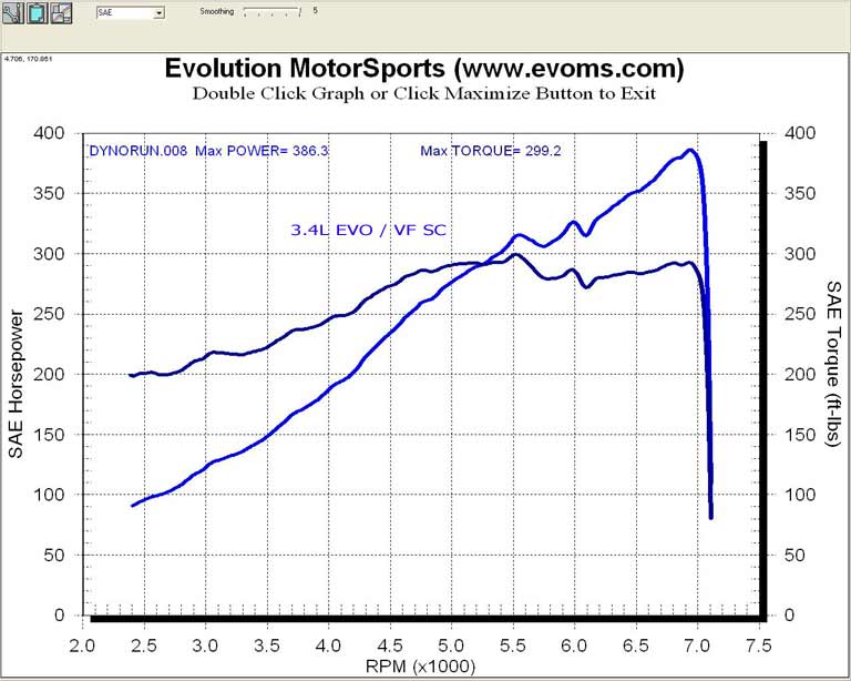

This is a current 3.4L 996 Supercharger Dyno in 4th gear

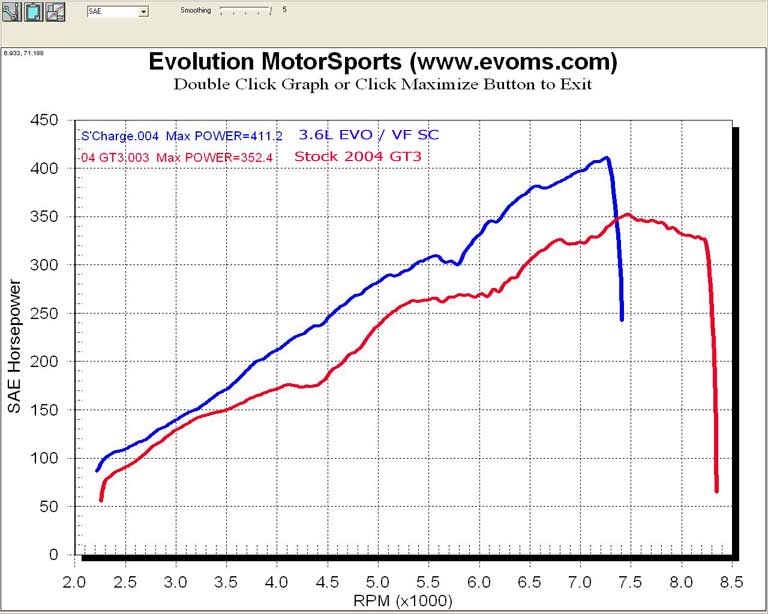

This is a current 3.4L 996 Supercharger Dyno in 4th gear VS a stock 2004 3.6L GT3

This is a current 3.6L 996 Supercharger Dyno in 4th gear

This is a current 3.6L 996 Supercharger Dyno in 4th gear VS a stock 2004 3.6L GT3

Nice power peaks....but the GT3 holds its power much longer (becuase of the higher redline)...and a TPC SC'ed 3.6L makes SIGNIFICANTLY more torque throughout the entire powerband than the EVO kit. (I don't mean to start anything here but thats just simple facts looking at these posted charts**) The TPC kit makes a peak of 360+ RWT as oppsoe to a little over 300 for EVO and it does it throughout much more of the powerband....hence, a much faster package*
