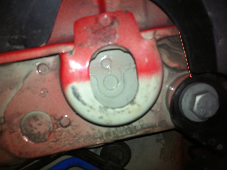

Does anyone know if the jacking point is simply bolted into place, or is marked area adhesive? It does not appear to be welded.

99.999% certain it is welded (at least spot welded).

Isnt it spot welded w body sealer over it for noise?

For noise but based on what I've found with my cars for corrosion protection. The under body metal is painted with what feels like an epoxy based paint that is very resistant to chipping.
It is so important that the lift points be protected by something to prevent this paint from getting crushed and developing cracking. This will be an entry point for water and eventually corrosion.

The only jack points/lift point are the duplicates of the one pictured. Based on my references Porsche doesn't support (no pun) lifting the car any other way, save of course, by the tires/wheels/suspension.

The flange is bent.
Originally Posted by Macster
Take the car to a body shop that works on these cars. It may be possible to drill out the spot welds, remove the lifting point pad, and do the same to another car (a wreck) then weld on the new lifting point pad and repaint.

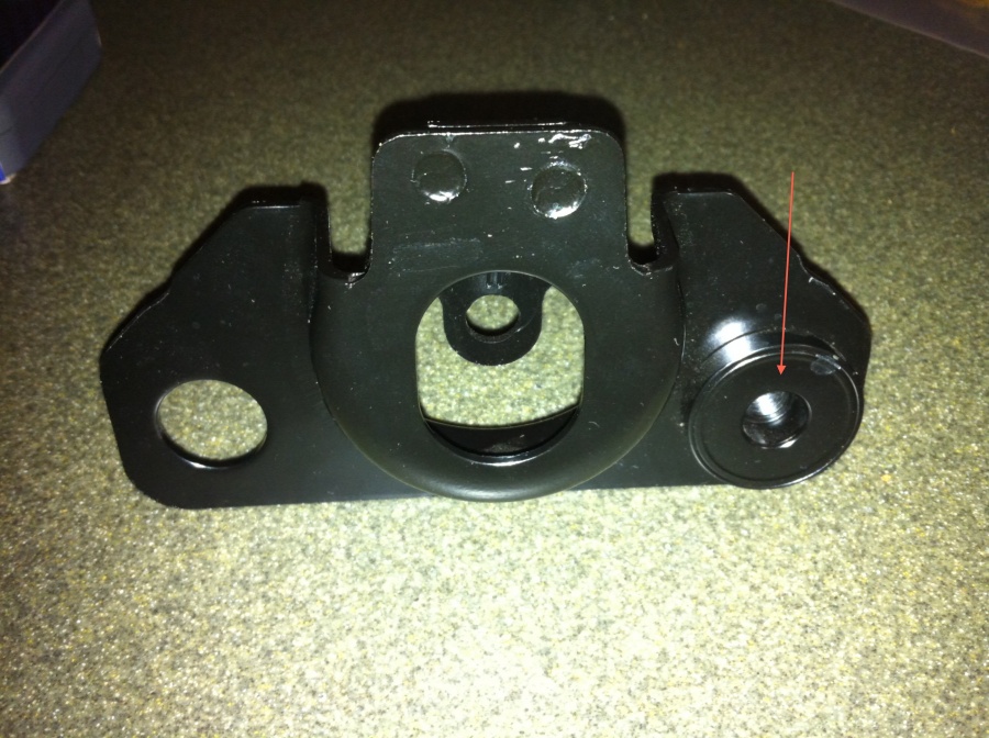

Thank you for your reply. The part is a readily available replacement part, and the lift pad has a threaded insert that is bolted on the corner.
As I mentioned on my previous post, there appears to be epoxy adhesive holding the opposite corner, but the indentations look like spot welds. I have no problem drilling out a those spots, but I was hoping that someone who has done this repair could confirm that they are spot welds.

It's spot-welded and then the seam sealant is sprayed on there to stop rust. The entire area needs to cleaned (remove the paint etc..) and weld a new one on. You can buy a new piece from Porsche.
