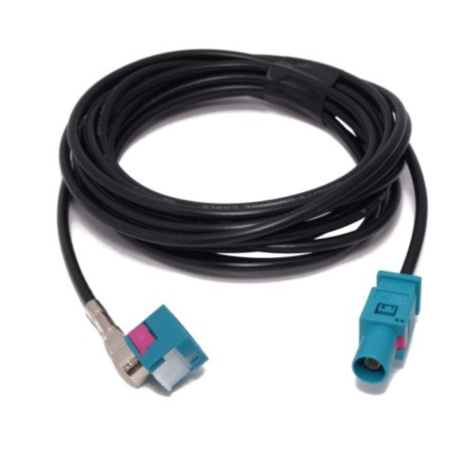

This one should match, right?

Yes, both correct

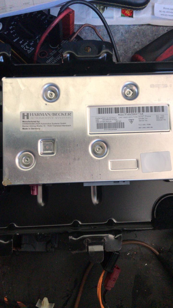

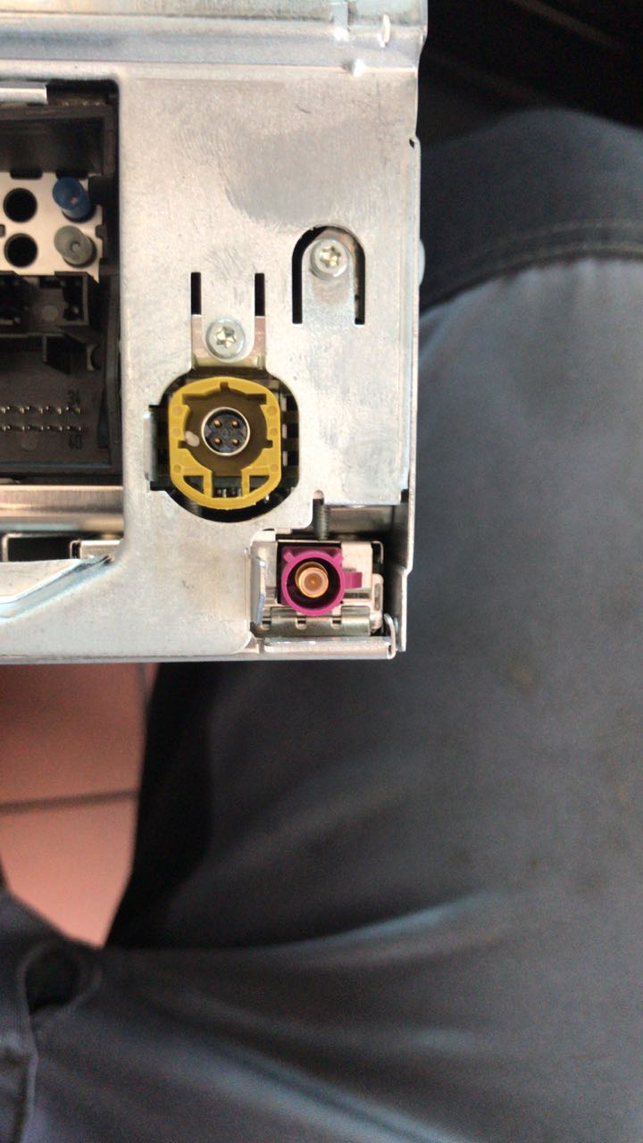

@Serg124: I saw you are using a USB AUX connector in combination with the PCM, right?
Those are original Porsche parts, Connector device and cable to it?
- could you provide the part number maybe?
- the yellow plug on the backside of the PCM3 is the USB?
Am I correct that the "telephone antenna cable" which is going at the moment to the "telephone box" is later going directly to the PCM3?
Is there an extension needed as well, I think so.
Same for the microphone, the box is under the passenger seat and I have to wire it from there into the PCM3, right?
Can anyone provide a back view of the PCM with a kind of a pinout because there are 2 connectors with 12 pins and i don't know which one is "C" and which one is "D" from the wiring diag.
Thanks again for helping!!!

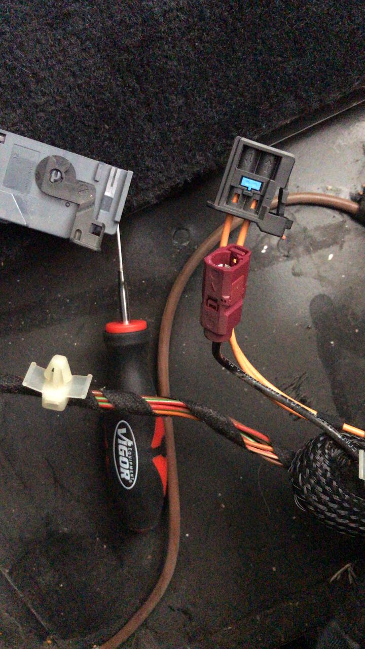

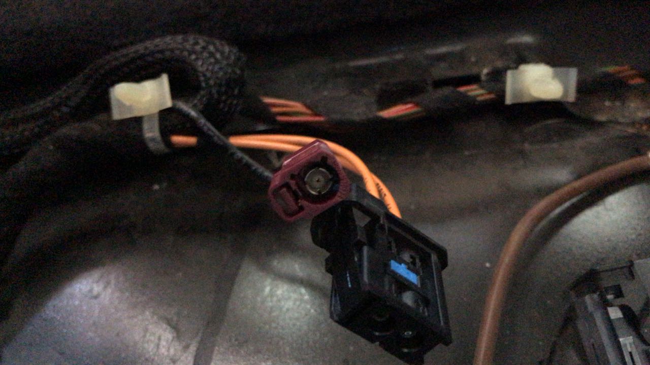

this are the connectors from the old telephone box and the new one from the PCM3.
Is there also a angled one necessary because of the space behind it?
- i can't find a red angled one.
the yellow one at the back of the PCM3 is USB?

Old Apr 21, 2018 | 02:19 PM
  #580
Serg124's Avatar
Joined: Mar 2013
Posts: 567
From: Russia
Rep Power: 74
Serg124 has a reputation beyond reputeSerg124 has a reputation beyond reputeSerg124 has a reputation beyond reputeSerg124 has a reputation beyond reputeSerg124 has a reputation beyond reputeSerg124 has a reputation beyond reputeSerg124 has a reputation beyond reputeSerg124 has a reputation beyond reputeSerg124 has a reputation beyond reputeSerg124 has a reputation beyond reputeSerg124 has a reputation beyond repute
JUsb aux is porsche kit, number 99704490234
Yes, reroute or extend necessary cables... Use universal connectors if colour coded is impossible to find. They are turquoise, can be bought from bmw
Yellow round plug is usb
Where is C and D plugs - look at your last photo - there numbers near pins. All pins throughout numbered - A is 1-8, B is 9-16, C is 17-28, D is 29-40, so on photo is part of plug D

Usb is a D plug

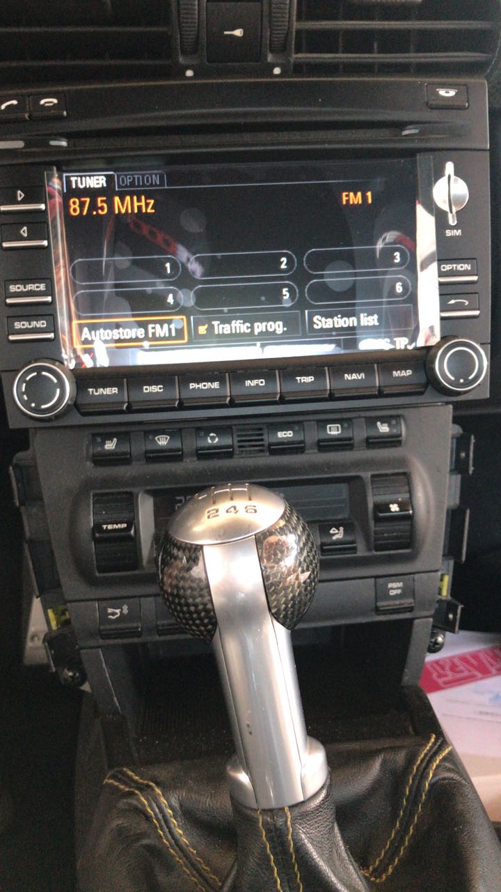

Thank you Serg.
Thing is powered up

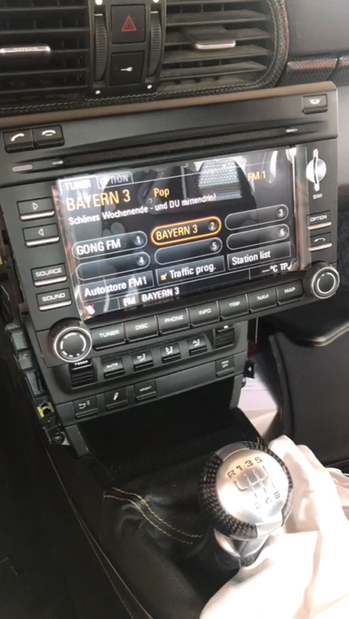

sound is also there, nice
