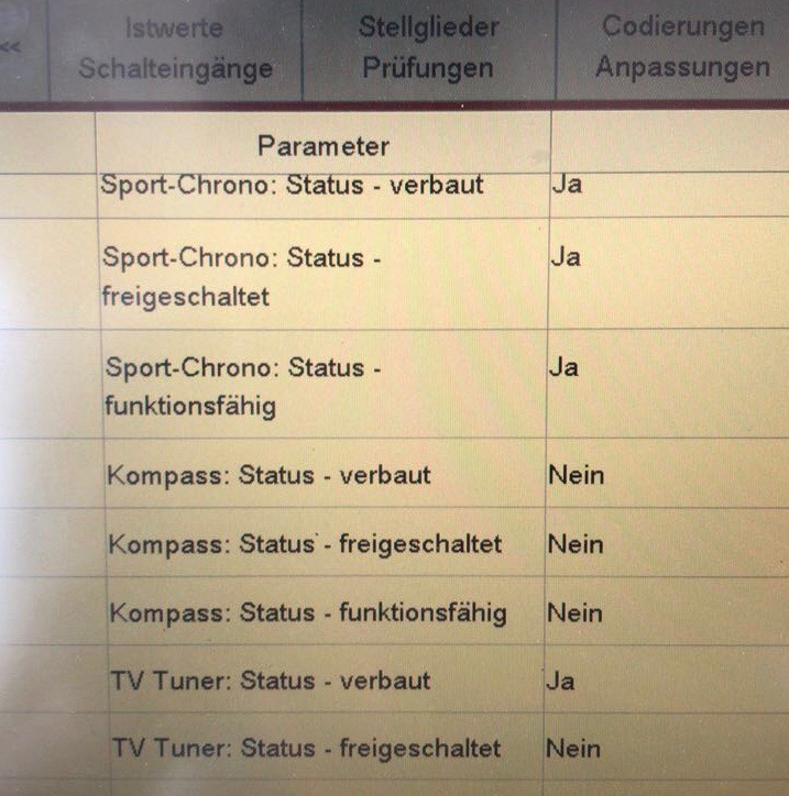

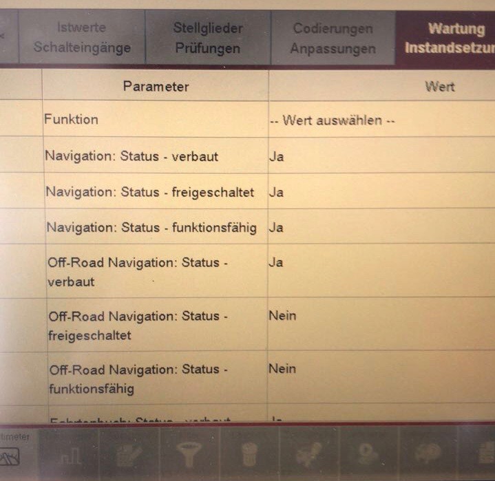

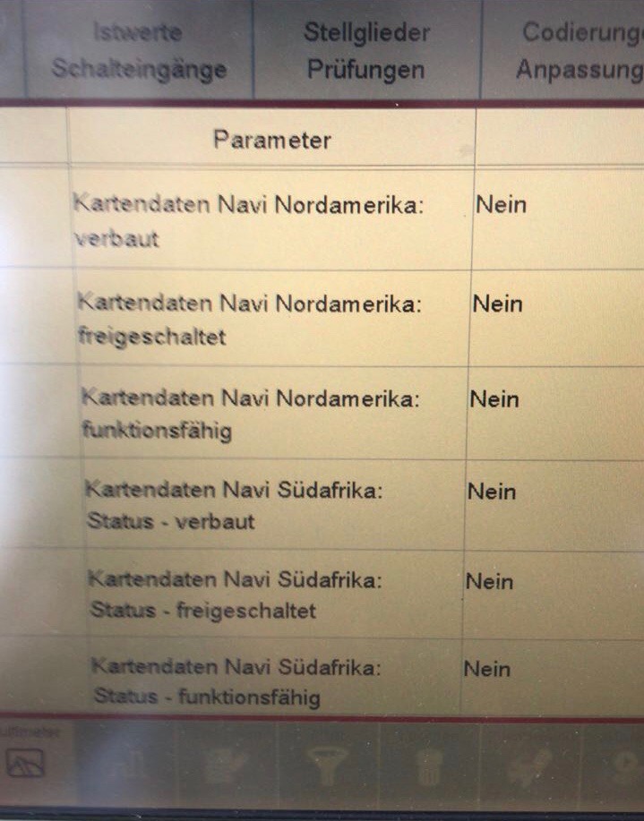

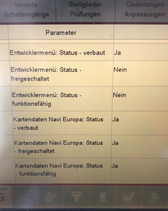

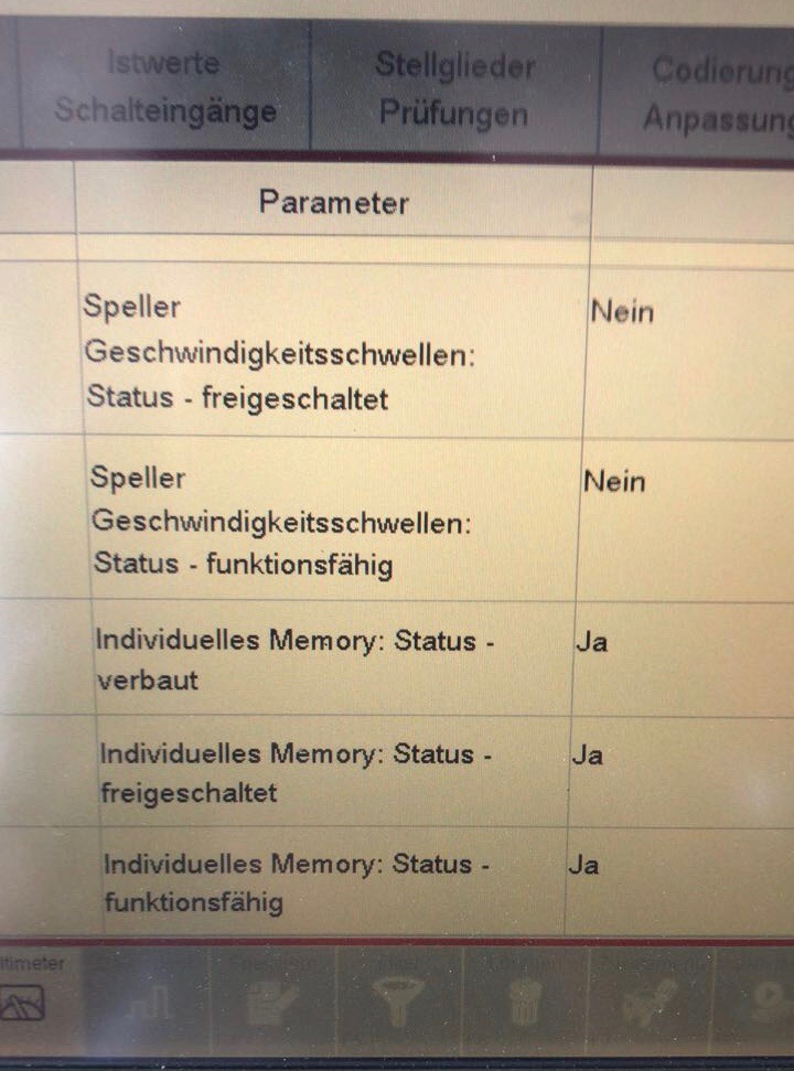

Hi guys, strange question.
Sounds stupid, but I think I do not need codes!?
- is this possible?
As I have a new, never used PCM3 it is not attached to a car and within PIWIS I can see all options active and working.
So it seems I have the complete conversion done and ready just need the connector for the switch panel, rest is working.
Regards
David

See this:

How is that - pcm3 not connected to a car, and with PIWIS you see all codes activated? Where you see this?

See the pictures above.
All is installed completely, installation is finished.
Cheers

))) You missed something in this topic. Yes, this is possible. Unfortunately not for long. Ain't you think you are luckier than everyone else who done this job before? )))
By the way - do you really have tv and speller installed? And did you already load map?

I was just wondering why all those functions are available within Piwis and thought that maybe with brand new PCMs no coding is needed, maybe only if the device was already attached to a car.
So just a question of someone never had done this conversion before but thanks for making this clear.
No, this is not installed, but need to finish setting everything correct within the next days.
D
