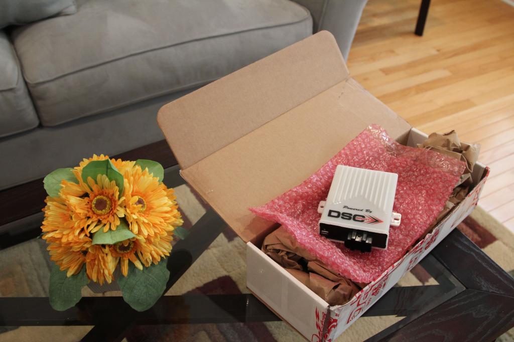

The DSC module

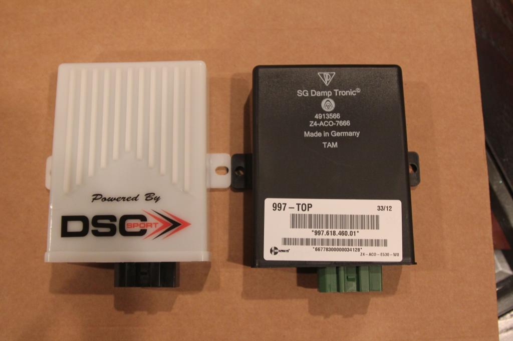

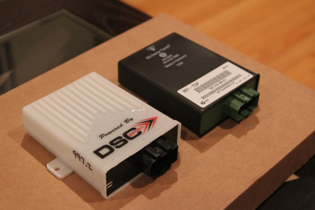

A few shots vs. the Porsche OEM PASM box

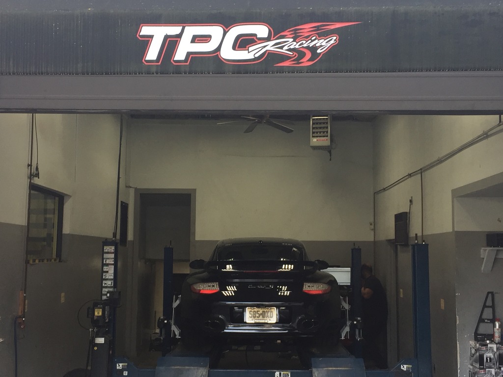

UPDATE (11-29-16)
There comes a point, (if you track your car with any frequency,want to improve your lap times and generally have a desire to keep up with the ‘competition’) when you will need to upgrade some of the stability and suspension bits in our 997.2 TTS! These 991 GT3’s and ever increasingly present Cayman GT4’s are hardto keep up with through corners at the track (although they’ve got nothing on aTTS in the straights)! Solution: a visit to TPC racing for (i) TPC Racing adjustable sway bars, (ii) track alignment and (iii) DSC module firmware update.
DSC module firmware update – the technical details of the DSC module firmware update were quite extensive when speaking to Mike Levitas (more on Mike later). The two cosmetic changes that are immediately apparent are (1) the DSC module now only has 2 modes (instead of 3) and (2) the lights on the PASM button are either OFF (mode 1 or “Normal”) or ON (mode 2 or “Sport”) so no more full ON, 2 blinks and 3 blinks to indicate the selected mode. This is similar to the stock PASM lighting system, but that is where the similarities end, the underlying programming is quite a feat to behold. I will try to explain but will likely not do it justice.
First, the module’s source algorithm was completely reversed.The initial algorithms started with “street” car settings and were subsequently adjusted to incorporate “race” car characteristics in modes 2 & 3. The revised algorithm STARTS with “race” car settings and comfort is progressively dialed-in. According to Mike, where the change is primarily felt is that now, there is no compromise in the transition from comfort to sport. Apparently in the prior version, there were ‘gaps’ in the algorithm which compromised how the system engaged the damping response (Mike showed these to me as empty boxes in the algorithm). These no longer exist and have been addressed. The revised algorithm now also incorporates variables for speed sensitivity and also improves the braking application.
The difference between modes 1 & 2 is simply that in mode 2 “Sport” the engagement threshold is lower (i.e., the damping stiffening occurs much sooner/quicker when the module senses or detects aggressive application at each wheel). I will leave it to Mike to answer specifically why the 3 distinct modes were eliminated, however on the street, I find that the new mode 1 “normal” is a nice more responsive blend of the old modes 1&2, while the new mode 2 “Sport” is a more responsive progressively linear version of the old mode 3. Each performs great in their respective applications (street and track).
In a nutshell, the prior version was intuitive, now the DSC module is almost telepathic in its ability to respond to both road surface imperfections and driver inputs.
Mike and the guys at TPC Racing are true suspension and carguys who refine their products on both the track and on the street. These guys know their stuff. I am told that the revised firmware vastly narrows the gap between our 997.2 TTS damping characteristics and that of 991 GT3’s. The chassis certainly felt more connected to the road at VIR after the upgrades. Mike is truly passionate and extremely knowledgeable. Having the opportunity to spending time talking with him plus getting a peek inside the fantastic algorithm operating the DSC module was a privilege and a lot fun. I’m certain I’ll be back to TPC Racing for more “goodies” as I strive to continue keeping 991 GT3’s and Cayman GT4’s in my rear view mirror at the track!
TPC Racing adjustable sway bars – This is basically TPC Racing’s 997 Stage 1 suspension kit without the Drop Links (the 997.2 stock drop links have sufficient tolerances that upgrading to adjustable drop links weren’t deemed necessary + additional benefit was being able to retain the rubber insulation boots which keeps the cabin quiet). The goal for the upgrade was to achieve greater cornering balance and stability to enable me carry faster speeds through corners (specifically higher corner entry speeds).
Track alignment – the goal here was simply to dial in more/max negative camber, particularly in the front tires to increase the contact patch thus increasing the tire grip/limit of friction to combat understeer characteristics mid-corner.

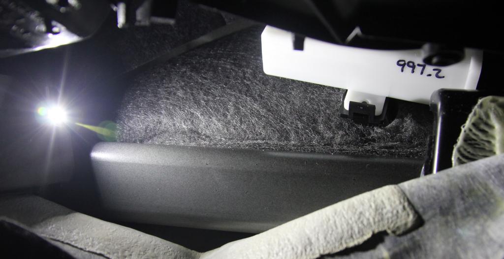

Can someone please show me where the module is located?
Old Jan 20, 2015 | 08:17 AM
93ls1rx7's Avatar
Joined: Nov 2011
Posts: 800
From: Sumter, SC
Rep Power: 130
93ls1rx7 Is a GOD !93ls1rx7 Is a GOD !93ls1rx7 Is a GOD !93ls1rx7 Is a GOD !93ls1rx7 Is a GOD !93ls1rx7 Is a GOD !93ls1rx7 Is a GOD !93ls1rx7 Is a GOD !93ls1rx7 Is a GOD !93ls1rx7 Is a GOD !93ls1rx7 Is a GOD !
He described it in the first post
"the OEM PASM control box is located in the upper area of the passenger footwell, just below the glove compartment behind a foam like housing. Simply remove four plastic screws, located the OEM PASM box, (I had to pull back the upper section of the carpet in the passenger foot well area but not by much and it sticks right back) and replace. The boxes are held in place by a set of clips. It took me 25 mins to switch it out but only because I was going extra slow to avoiding causing any permanent damage. It could be done in under 10 mins"
Gladly, however I'm in the office right now . If no one responds by the time I get home, I'll take a picture and post it for you.
If you look at the spot above where a passenger's feet would normally be, you should see a dark grey foam covering with 4 plastic screws. Remove the screws and foam cover and the OEM PASM box should be visible in its bracket with the wires attached/plugged in. I had to peel back some of the adjacent carpet (near the top of the passenger footwell) in order to safely remove the module. Simply pull back on the bracket clip to release the module. Hope this helps.
I just wanted to add a little clarification for Jako. Once the foam panel beneath the glove box is removed, the carpet that needs to be pulled back is on the right side of the passenger footwell. I was uncomfortable peeling this carpet panel down, but with some persistence it did come loose and it was then just a matter of unplugging the old and plugging in the new - easy beasy, and the carpet easily pushed back into place. If I recall accurately, someone posted pictures on a thread awhile back. A search may help.
Here you go,
Beneath the glove box, the dark area is the foam like cover, which needs to come off first. The carpeted area to the right of the foam cover is where you need to peel back to access the OEM PASM box
Here is a shot of the module in place, what you see at the bottom is the carpet peeled back. It goes right back into place however when done. Note the black plastic clamps which hold the module in place...be careful not to snap them (although they are fairly sturdy).
