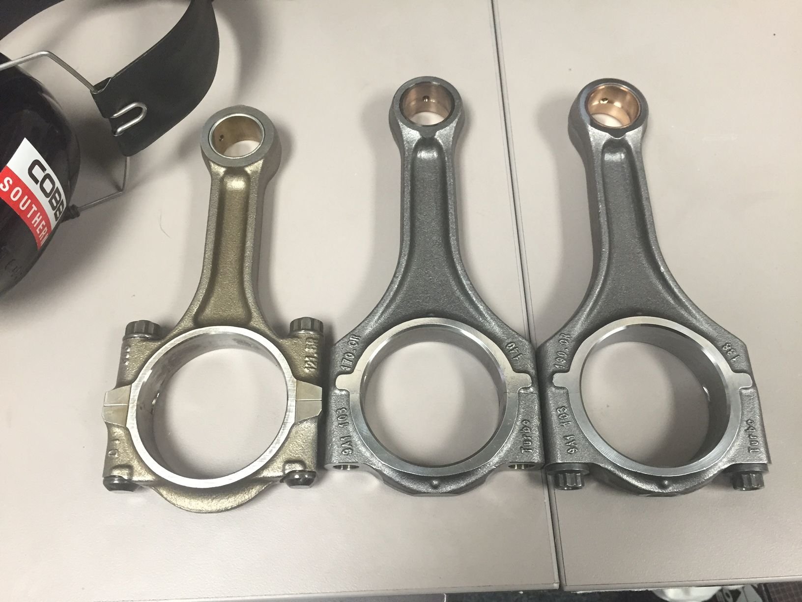

Congrats Adam! I am looking forward to seeing the results. We know quite a few big names in the industry that are independently working towards a reliable modern solution for the 991 and 997.2 Turbos. I.E. Not simply just adding an injector at the throttle body. I'm sure they will post up when they have empirical data showing it works.
Originally Posted by longboarder
I understand the 997.2 rods are even thinner/weaker than the rods from the 3.6 Mezger..
This has been a common misconception over the years, not sure how it got started, but the 997.2 rods are near identical to the 991 rods which have been shown to take 800+ ft/lbs of torque to the wheels. We have conducted quite a bit of R&D on the 991 rod to ensure things stay safe.
https://www.6speedonline.com/forums/...cting-rod.html
Left: 997.1 Mezger 3.6L, Middle: 997.2 3.8L, Right: 991.1 3.8L
Stoked to see what your car can do with the new setup!
-Jon
Hi Jon, good to hear from you hope all is well!
Great to hear the rods are about the same. Thx for the pic. I don't know where I heard the info about the rods but maybe I can push my car a little more. I was literally asking for only like 5-10 more HP on the top end just so it's more stabilized since I was right at the fueling limit. Maybe I can go a little higher on the power still with plenty of headroom on both the fueling and then of course the motor and PDK.
Part of why I frankly don't want to push it is because I don't need two of these cars and looking to the near future when I part out and sell this car, I want it to be in good working order and I don't want to bend a rod to have a slipping PDK to deal with. If I had unlimited funds then maybe it would be fun to see where the motor or PDK busts but that's for someone else.
