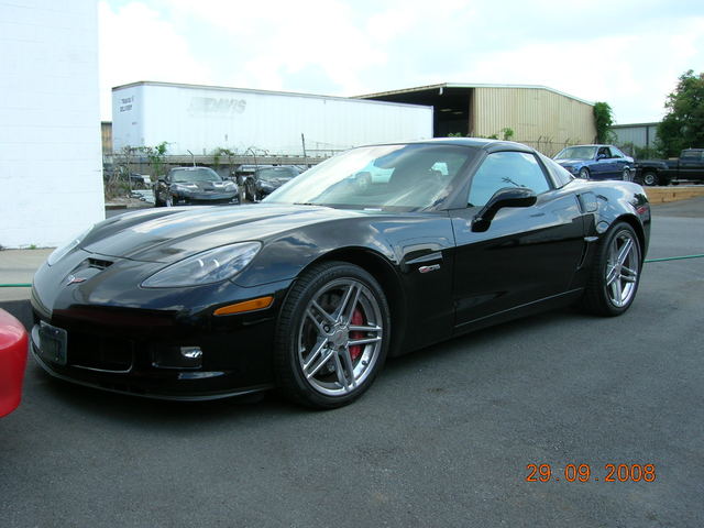

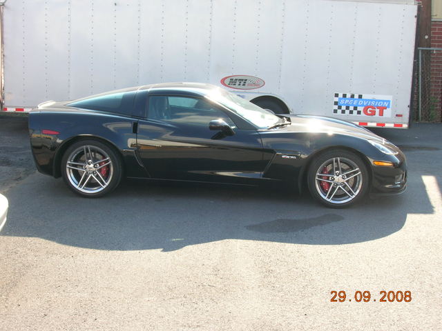

Here's a few pictures of my bone stock car upon arrival at MTI. More to follow in the days to come...
