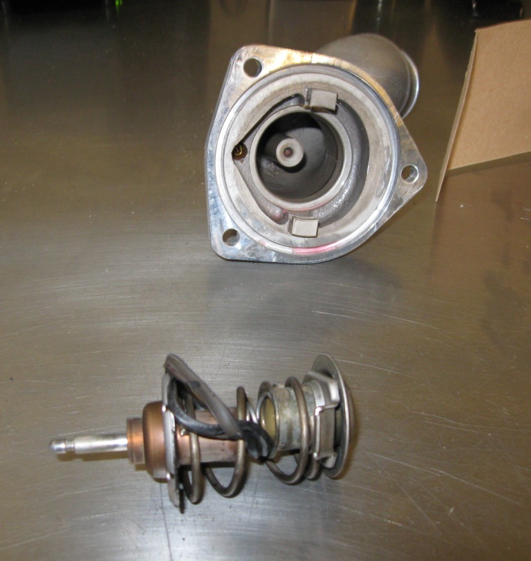

Captain Greg,(and telum01)
You have the classic problem with these thermostats. The rubber gasket around the thermostat comes off and keeps the thermostat open. Just replace the thermostat and everything will go back to normal. (Note: even at very low outside temps, like below 0, the temp should still read in the middle of the range).
Name:	Old Thermostat.JPG

Do a search on "thermostat repair". There are a couple of good threads on how to do it. I changed mine out on my previous V8V with the equivalent Jag part. It's a pretty easy DIY job.

Do it your itself?
There is a very helpful, complete step by step description of this repair on this forum. I used it successfully.
The Jag V8 component kit cost is less than half of Aston's but performs the same function. The Jag internal spring, however, is at least half again as difficult to compress, according to my AM/Jag dealer mechanic who works on both cars.
If you personally are going to do this job, save your fingers, use the AM part. The fasteners in this R&R task are hidden beneath related hoses and covers, but is doable by a novice.
