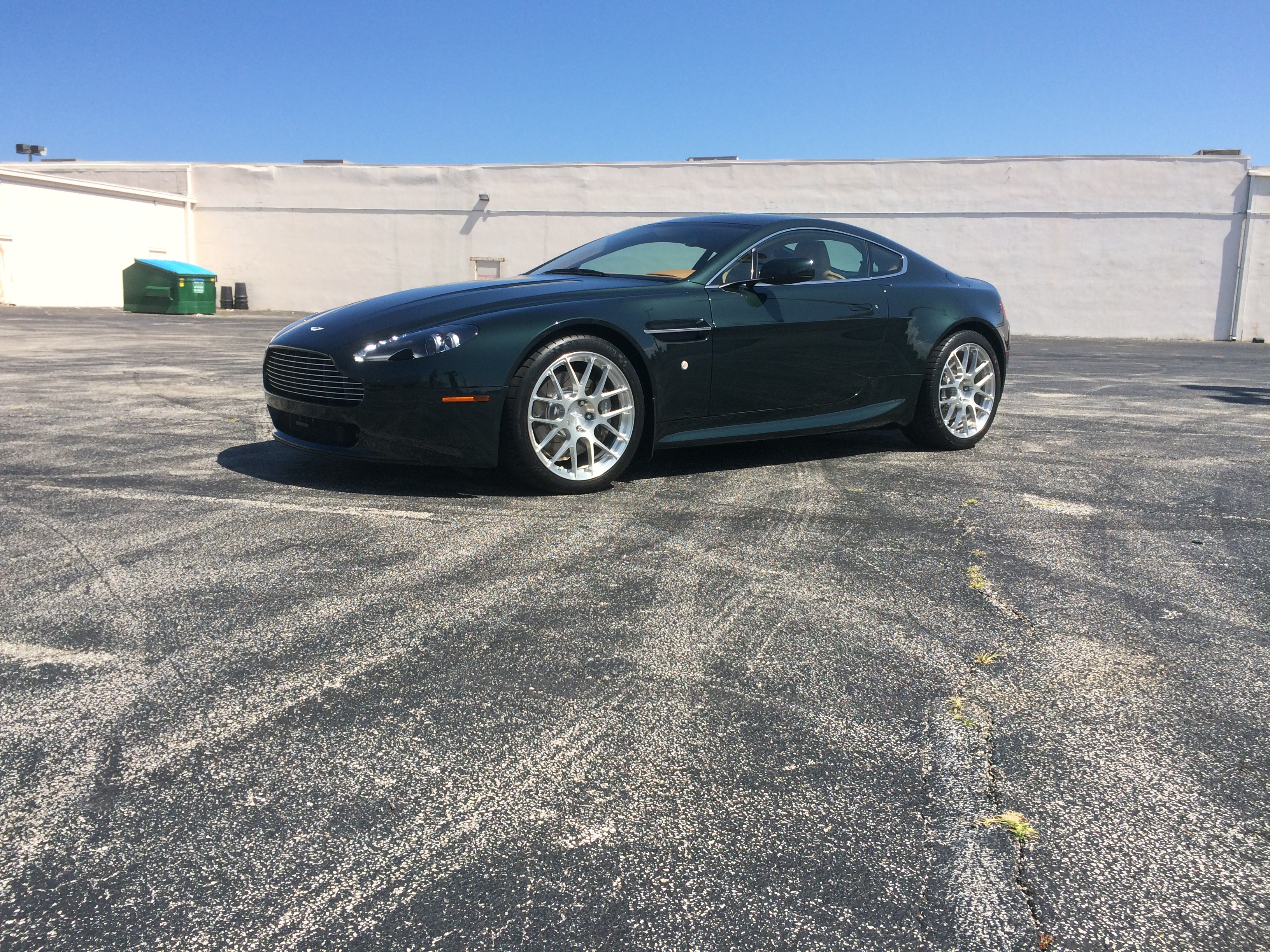

+1 on the BC Forged wheels.

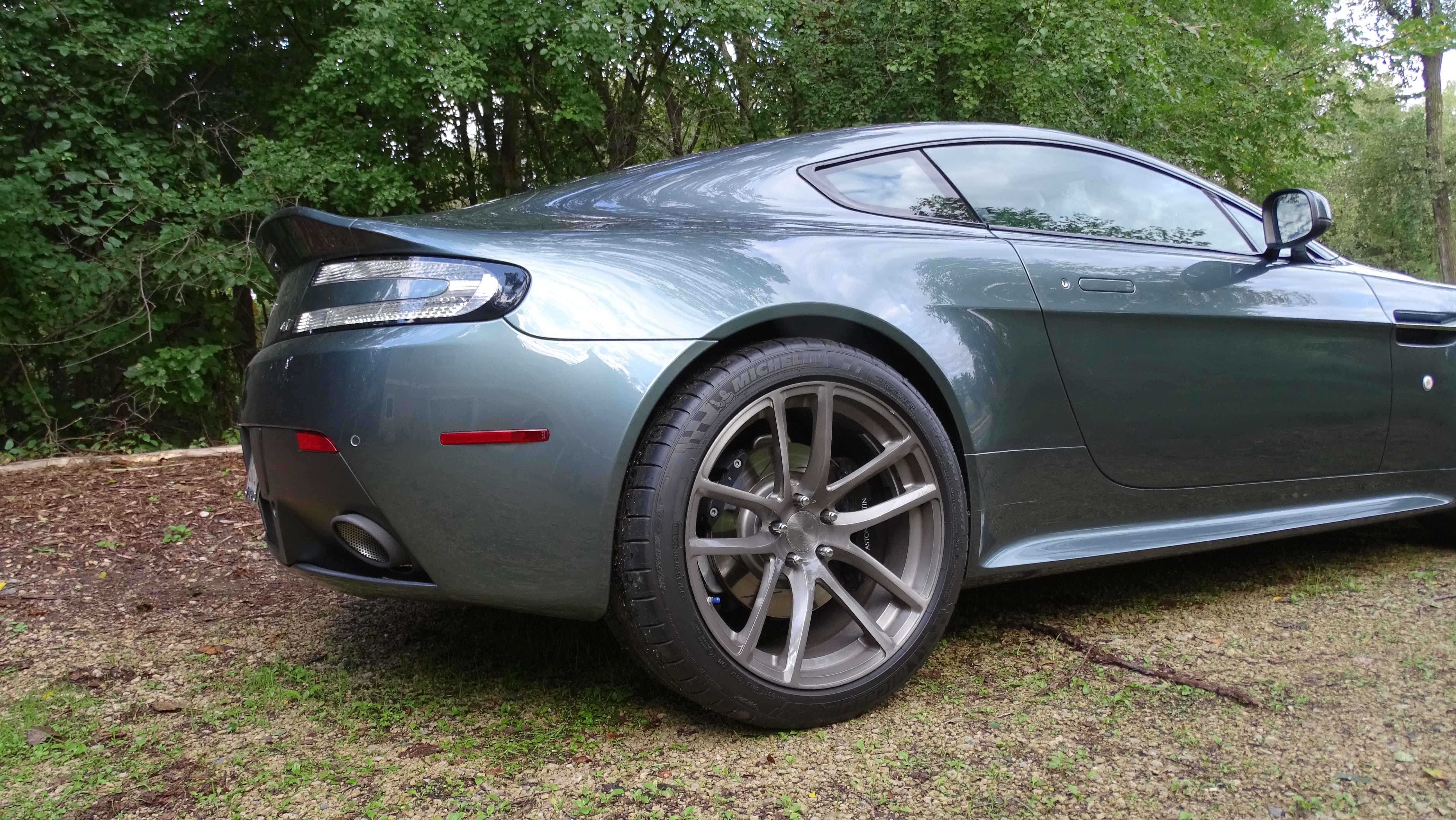

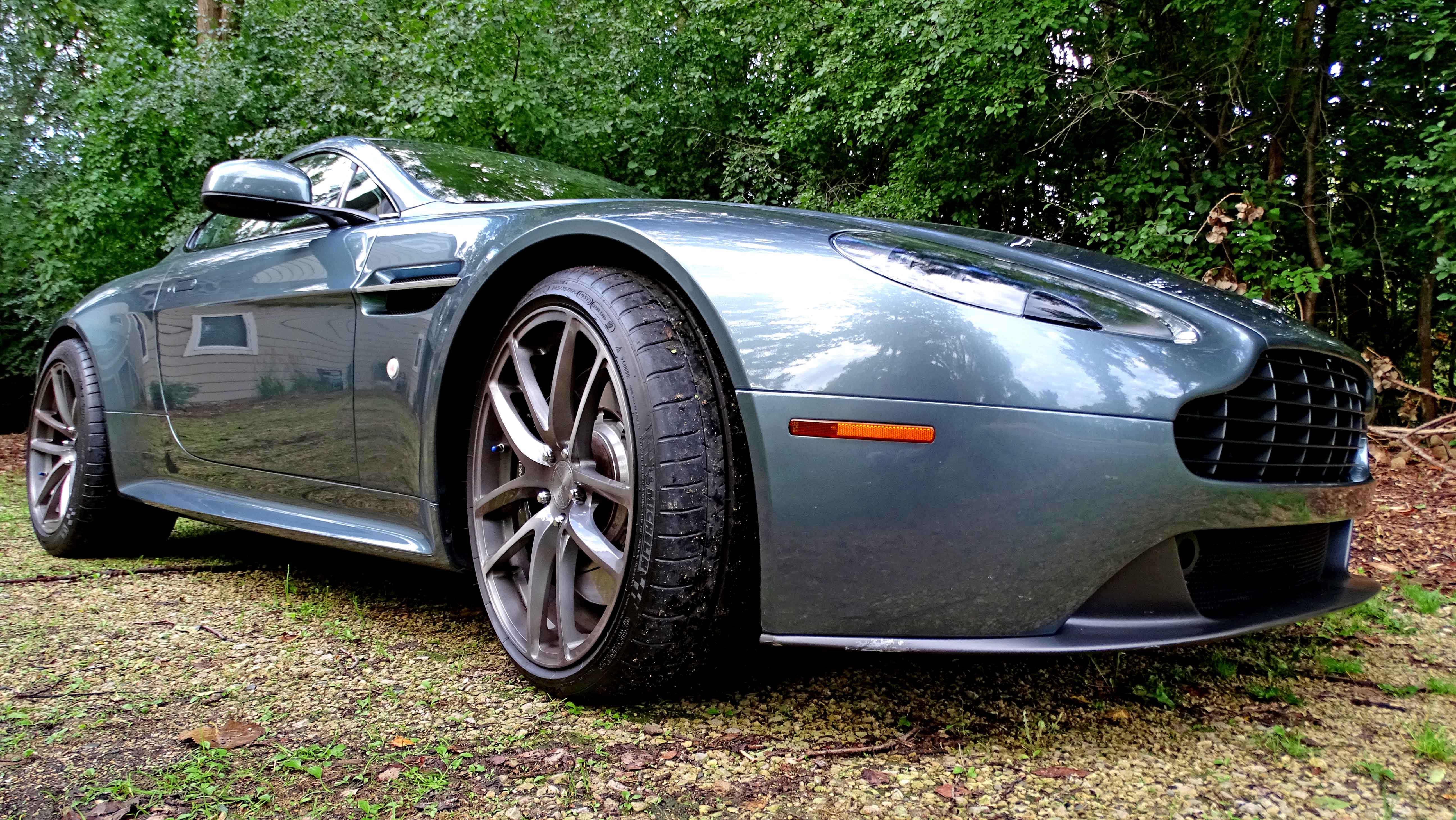

I liked the 20" Modulare Wheel Style, but when I got it I bought new tires and the tire shop fitted the rear tires with oversized diameter that I had on my 2009, then put them on my 2015 GT. As you can see below, the wheels and tires did a great job filling the wheel wells, like the 2019 Vantage. I was amazed that there was never any rubbing of the tires against the body - ever.
If I took a corner hard, I'd cringe, but never a problem. The 2015 GT went through two (under warranty) computers that controlled the sportshift. After a while I thought maybe the 1.5 inch oversized diameter was screwing up something in the system, so I changed the rears to the correct diameter which also helped the car site more normal. After seeing the artist rendering of the 2019 Vantage I thought now was the time to find a 2015 V12S and trade. I really like the standard V12S wheels, and the Modulare wheels needed (two of them) to be fixed with curb rash, so I sold the wheels and tires for what was essentially the retail of those two rear tires. In hindsight I should have kept them, fixed the two wheels. The inset of the tires bothers me more than the gap between tire and body, so I'm leaning towards the spacers.
