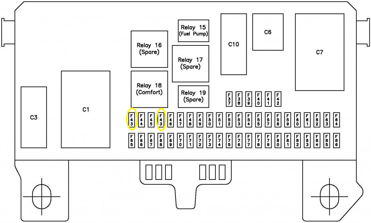

Well this doesn't help... F43, F44, F45, F43 again...., F46, F47
So are F46 and up labeled wrong on the workshop manual diagram?

And...FIXED!!!
So fuse 47 not only runs the lights but the control circuit for the seats, but not the seat memory as the side view mirrors still returned to program.
Had 2 things going against me on such a simple task.
1. The fuse numbers molded into the fuse panel itself were not even close to the correct numbers. The modled in number showed the last position to the left as F47, yet the WSM diagram shows it as F64 (Actually F65...)
2. The workshop manual showed F47 as 6 over from the right. However due to having 2 x #F43 on the diagram, it was actually 5 over from the right, 6.
