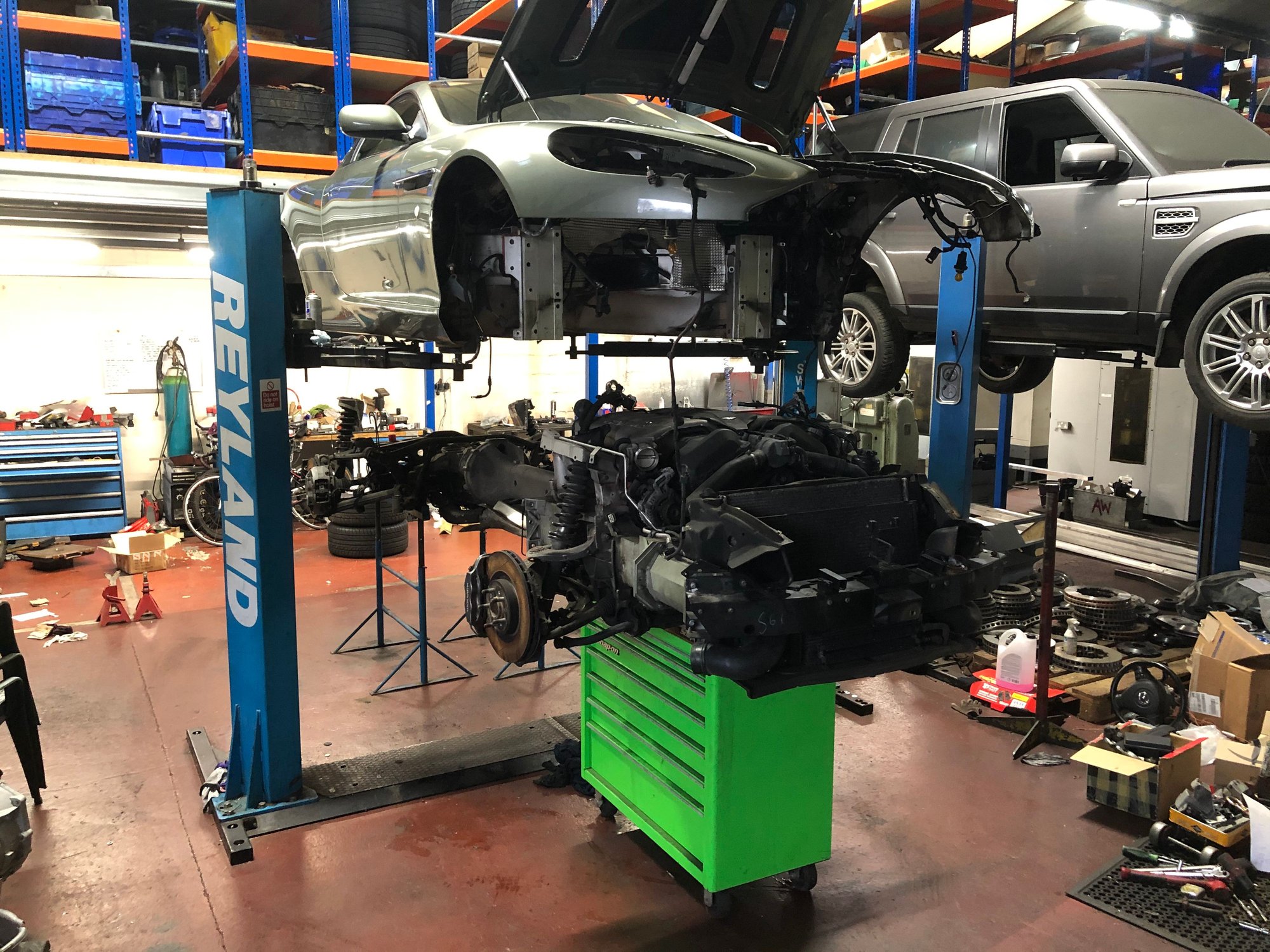

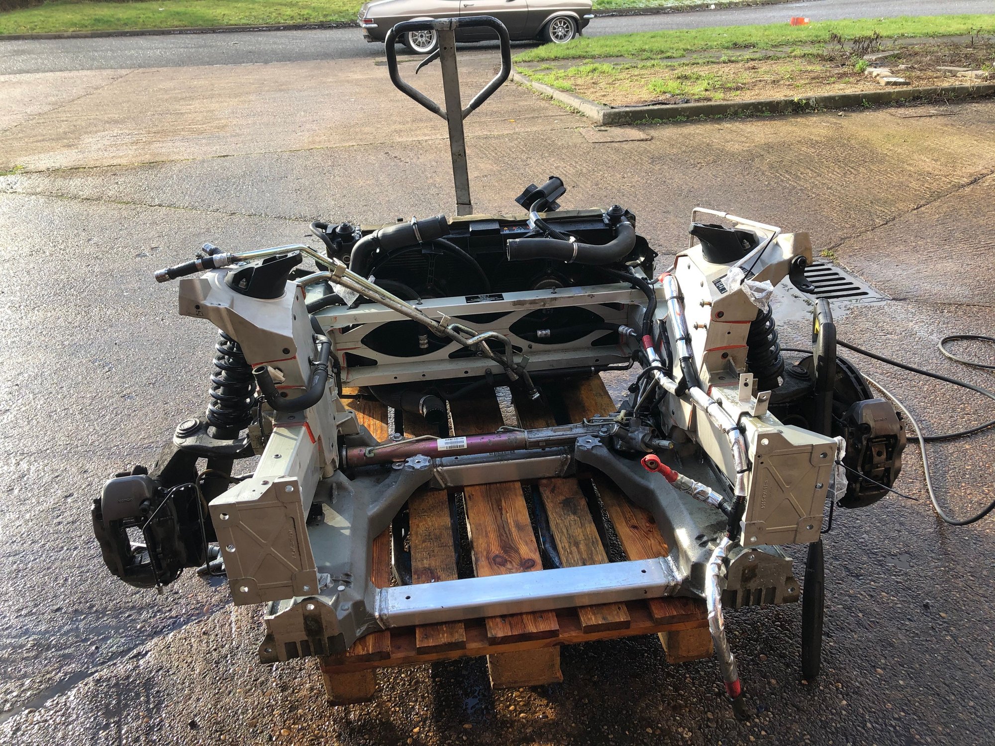

Hi everyone, new member here. Whilst searching the net for various DB9 related questions this site came up time and time again so I thought I'd join. I have a 2005 DB9 that I bought with engine trauma, thrown rods to be exact and decided replacement was better than trying to fix it so I found an 8800 mile 2007 engine with the same engine code and am in the process of fitting the ancillaries. During this I have noticed that the new engine has bigger diameter fuel rails (20mm) than the original (about 12.5mm) and the fuel pressure sensors are different, one looks to incorporate the fuel temp sensor as that's missing. My question is.. Does anyone know if I can I run the newer sensors on my car?
