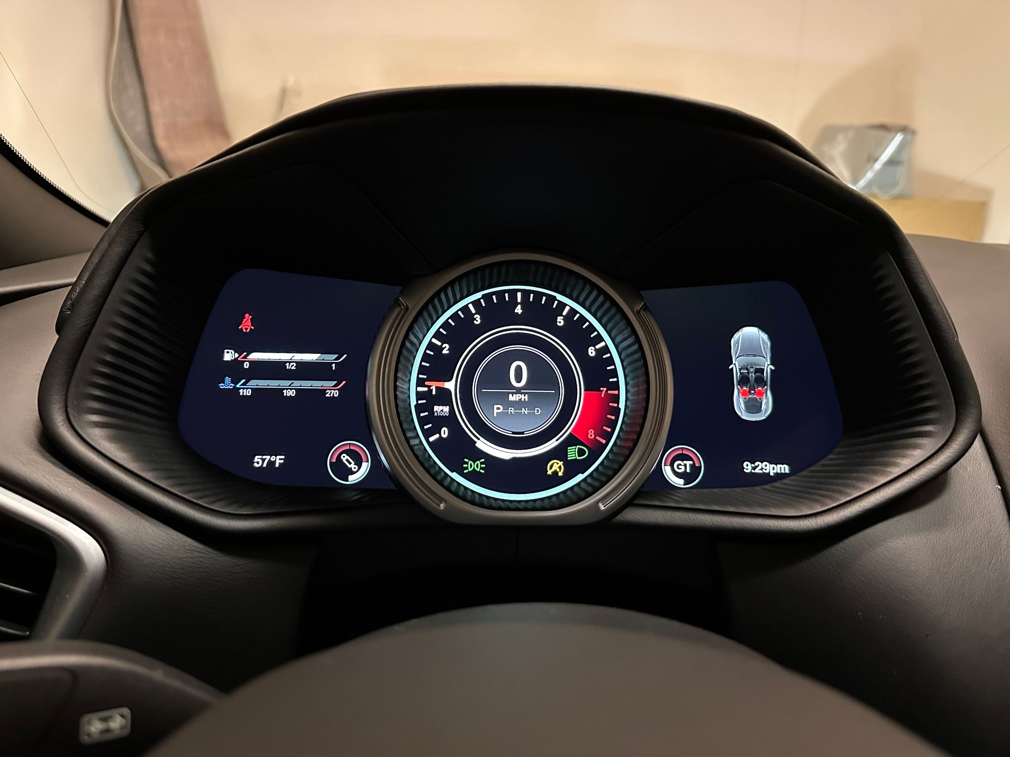

Hello everyone. I’m a long time lurker first time poster. Finally got my first Aston. The car is perfect except for one little thing. Every time I turn on the car, the dash shows an overhead interior image with the back seats highlighted in red. I understand it’s a seat belt warning for passengers in the back, but there is no one in the back. Nothing. Is this normal?

Connect both rear seat belts and then go for a short drive. Then disconnect both rear seat belts and cycle the ignition. Let me know if that clears the error.

I connected both rear seat belts, went for a short drive, disconnect both rear seat belts and cycled the ignition. Warning still appears.

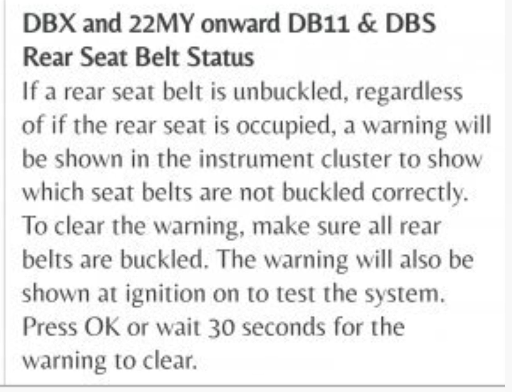

Keep the rear seat belts buckled.

The same right light happens on the DBX.
