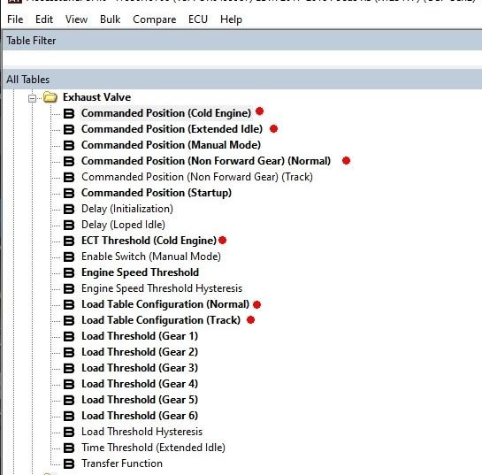

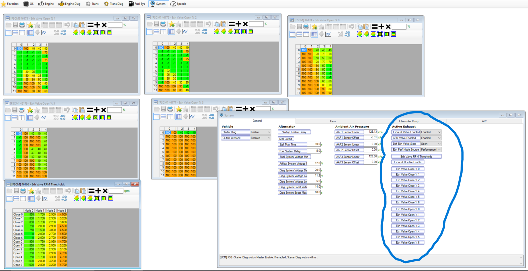

Now, the EMS completely controls the opening of the valves, via the ECU, based on numerous operating conditions as well as various driver selected options such as sport modes. The flaps use a servo type motor rather than a vacuum and there is an infinitely variable opening % given numerous engine/trans situations.
I quit tuning as these new systems were coming onboard, but a tuner who knows what he is doing should be able to make modifications. Here are just some examples of what a tuner is going to see in some of the data tables of typical systems which so many performance car models now use.

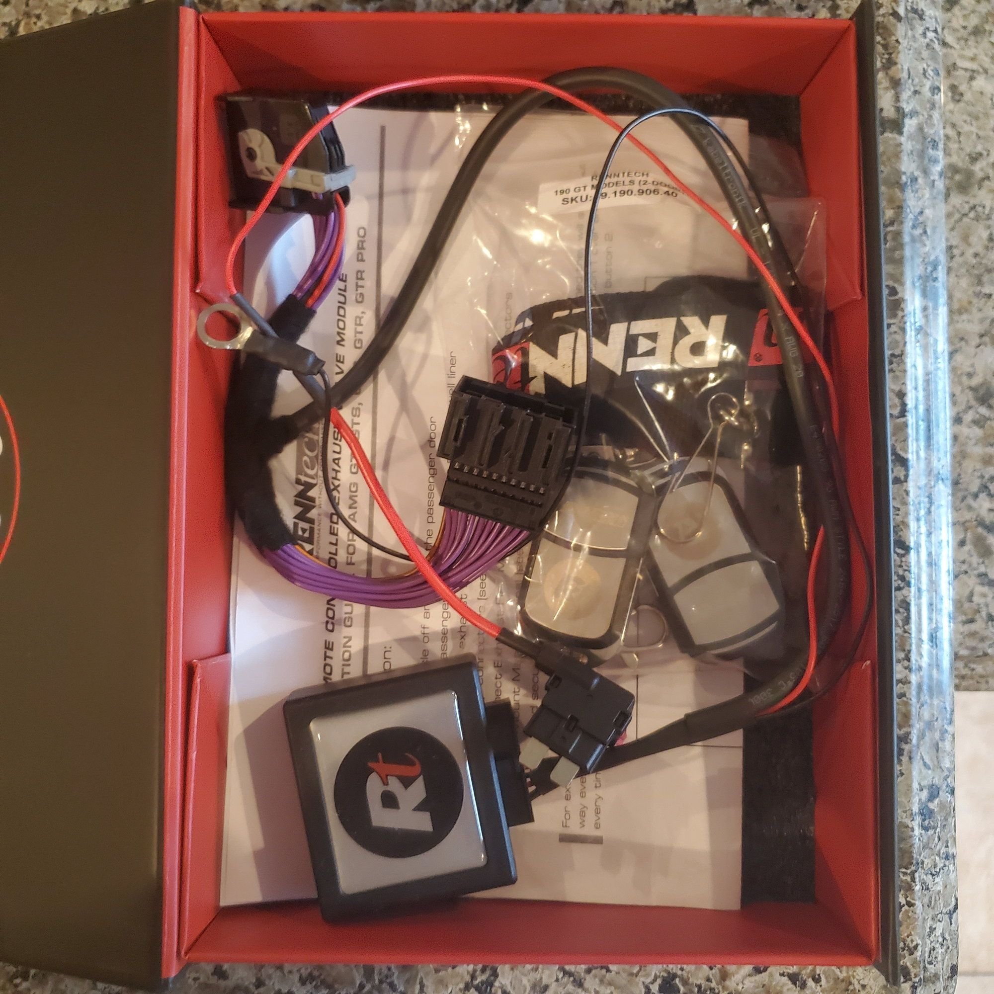

There are a couple of companies out there, Renntech and Cete, that have developed an aftermarket intervention on the MB M177 platform that overrides the ECU controllable functions and keep the valves at 100% open. When you hear an exhaust using one of these devices, you realize there is no time in the factory program that has the valves opened 100% at idle ,startup or cold start. It's that much louder.
These devices are pretty complex. They intervene in the system as a node on the CAN-BUS.
Here is a pic of the Renntech
I couldn't begin to describe where this could intervene on the AM platform, and would take a willing engineer at one of these two companies. They should step over and make an AM option since these systems are the same.

Excellent information BWings! I absolutely do not understand why manufacturers will not give us 100% control over the exhaust valves (along with leaving settings in the place we left them after driving). These cars should have a menu for exhaust that lets you control settings that stick, and a quick change button INDEPENDANT of other drive mode functionalities. Thankfully the new Vantages at least let you keep dampers soft while changing to Sport/Track mode, as my 2014 went into rock hard road ride with a sport suspension if you wanted the sharper throttle response/features of Sport mode.
If Aston is using the same muffler/valves as MB does with the M177, then I would think the Renntech product you mention could work (and this is exactly what I'm looking for)...

Well scratch that, I just got off the phone with an engineer at Renntech who says they have lots of Astons in and he promised me this https://www.renntechmercedes.com/index.php/products/mb/amg-gt/gt-2018/gt-2018/evm-190-detail controller will not work with Aston's valves. He said he's unaware of any ecu flash or product that will offer valve control in the Aston.
My local dealer is also of no help with this.
The AMG GT sounds fantastic in that Renntech video on idle, really sucks if there is no way to have the Aston in a true open valve all the time setting, especially since IMHO the secondary cat delete did not do all that much to overall sound level increase.
