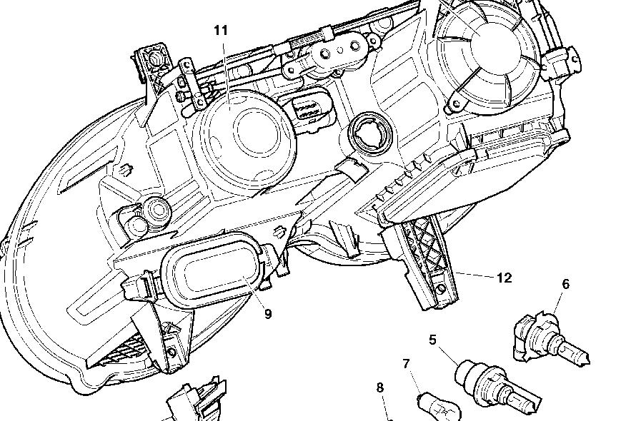

I have done these bulbs a couple times, it is possible, I NEVER put back that cover, never had an issue.
the passenger side is the real pain, once you pop that over off with your hand you are good to go. here is a pic of the cover you need to pop off, i did it by just removing the intake hose clamp.
number 9 is the cover you need to pop off first

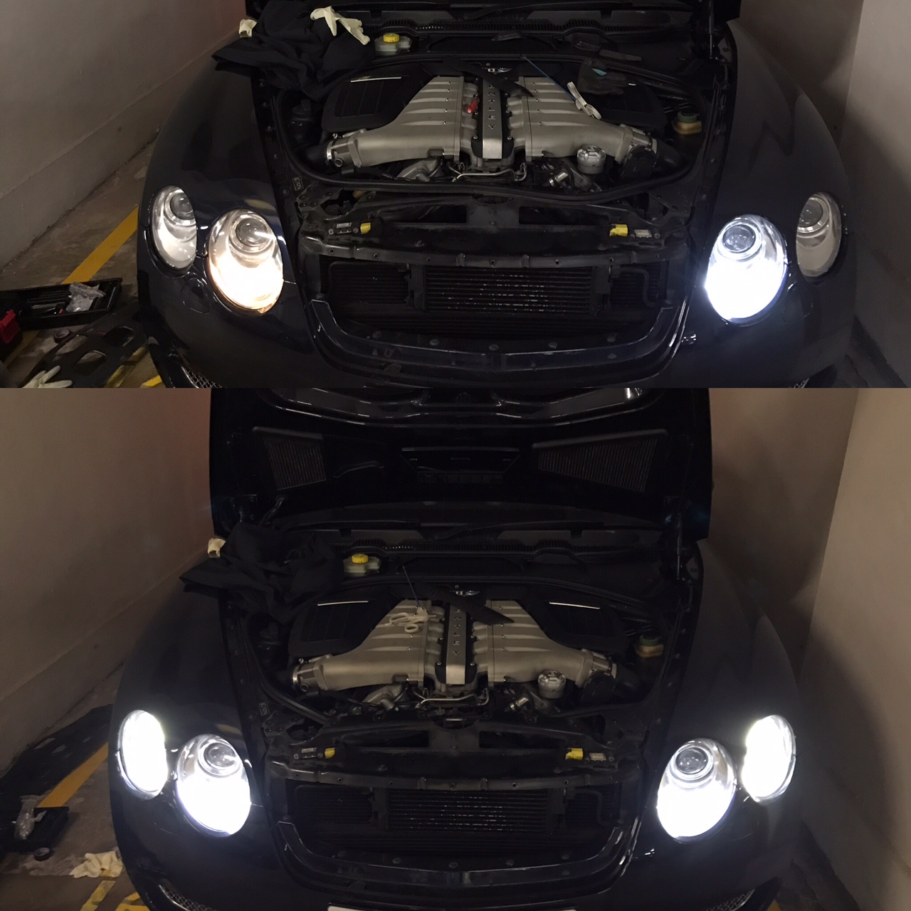

I've been following this post for some time (years) and have been putting off this DIY until I saw lilo post. Armed with this information I gave it a go and managed to swap both bulbs in 2.5hrs with lots of swearing, bruised hands and back pains. Those with big hands should think twice as its near impossible to get your hands down what little space there is. I lost the cover for the drivers side down in the engine somewhere as I just couldnt get the nib to lock on.
I removed the radiator slam panel, probably not needed to assist in removing the plastic intake ducting. This gives a lot more room to work and I dare say makes its easier for the pax side. The drivers side was a major pita even after unplugging return hose and connector. Once the cover was off I couldnt believe how far in the bulb was and I spent a good 30mins turning the housing with my fingertips without any luck. I finally found it was a PUSH FIT housing but without enough space to grab and pull I used a screwdriver and "flicked" the housing out.
Tips for those who want to attempt this painful DIY.
1) Remember the bulb holder is a PUSH FIT. Forceps could be used to grip and pull out housing.
2) Dont buy large LED type bulbs as they will not fix. I bought a single Cree 5w LED but the metal housing was too big to fit in headlight.
3) The bulbs when installed may still turn in its housing so be wary if you want your single/double sided LED to face a certain direction.
I installed double sided 8 LED canbus PCB type bulb that producing a 5000K white light as photos show. Top left shows OE vs LED parking lights only and bottom with all lights on.
Happy DIYing

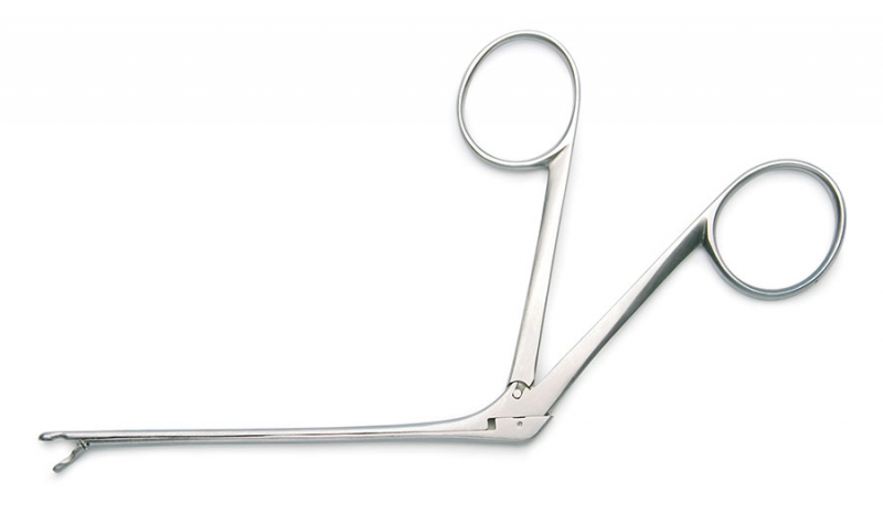

Reflecting back I think using some special tools would assist in removing the LED bulb. Such a tool would be an angled alligator forcep to grip LED housing and a flexible USB inspection camera to see where your working.
Angled alligator forcep.
