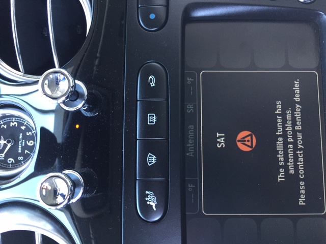

Love this place and the knowledge is amazing, I recently acquired a 2010 GTC and out of nowhere my sirius stopped working and I am getting the message "satellite tuner has antenna problems" contact your bentley dealer.
I searched the forum and was able to learn location of the tuner in the truck by spoiler, anyone have this problm before?
Thanks in advance , photos to come of the new ride soon.

When I worked at the dealer, we came up with a fix for that problem years ago, you will need to replace the stock Sirius/XM antenna with an aftermarket antenna. It is a job that can be done in under an hour.

Just a word of caution - I had crappy satellite radio reception in my 2011 Supersports. The dealer replaced the antenna and then some connectors/cables. The moral of the story is that the satellite radio reception did not improve after replacement, but i did get two nasty rattles after they took the headliner off and put it back on. One was in the drivers's side pillar and the other in the rear towards the glass. Since they they tried to fix it 4 times, to no avail.

We see this all the time too. SiriusXM Antenna will work as "Bentley tech NY" suggested. Simply replace and solder in the new one.

Did you ever figure it out? My 2010 GTC Speed has the same message/issue...
