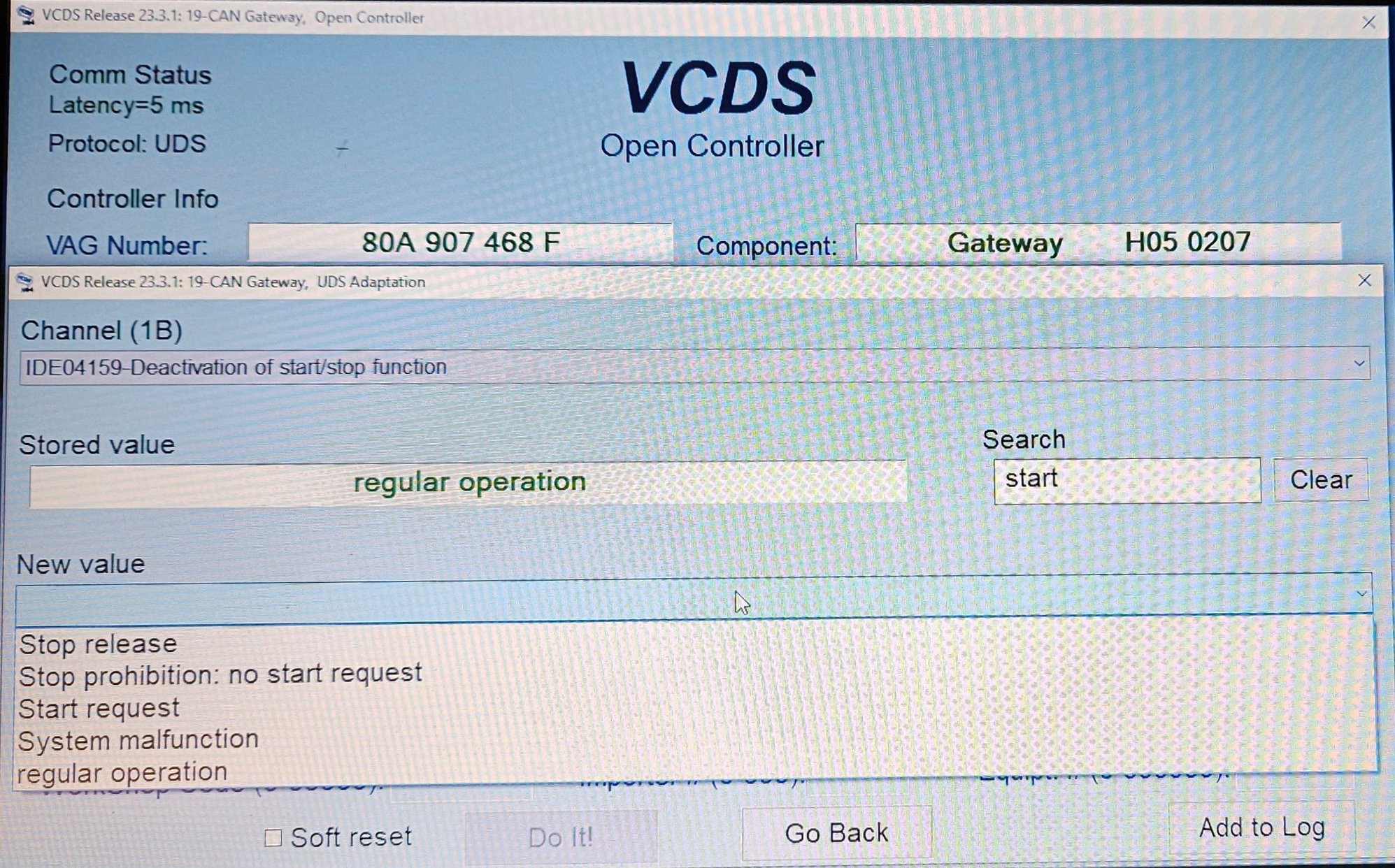

Well, the video above is older and not specifically for a Bentley so the option shown for the voltage threshold doesn't exist. What does exist is shown below but I'm not sure what each option will do. Any guidance is appreciated. If no one knows I'll just start trying them this weekend to see what happens.

Don't have any firsthand knowledge to offer, but I think I might try option #2 first - "Stop prohibition: no start request."

Yes, running 23.3.1 which is the latest. There's a beta but I haven't tried it. I received essentially the same response when I emailed them too. They did suggest I search the forums for an answer.
Latest update is that, unlike the Audi, Bentley doesn't have the voltage or temperature options (at least that I could find) so I tried "Stop prohibition: no start request," which did nothing - not even once. I may try the "System Malfunction" option next. After that, I guess I'll admit defeat until I can get my hands on a the 'center console wiring diagram' to identify the correct switch leads, but I'm not doing any mods till after the warranty is up. The folks at b2bfab.com said they'd like to work with me if I go that route.

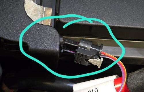

On my new-to-me 2020 GT the auto stop 'feature" is really annoying and I always forget to press the button to disable it (unless wifey is with me, she acts as copilot and does it on start-up!).
I needed a better solution and found it after disabling it on our '24 Infinity QX60. On the Infinity, there's a little cable with a plug that goes into a socket on the battery's negative terminal. You slide the little clip, pull the plug and, voilà, no more auto-stop!
Well guess what? There's a very similar little cable with a very similar plug and very similar little clip on the negative terminal on the Bentley's battery. I unplugged it, started the car and got a message saying that Auto-Stop is not functioning and I should contact my Bentley dealer. The message disappears after a few seconds and I can happily drive without the annoyance. This applies to Bentayga's too.
