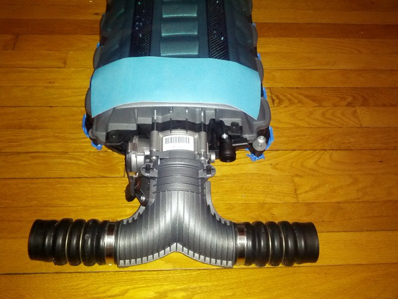

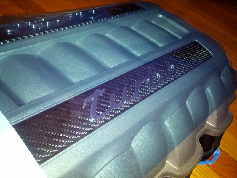

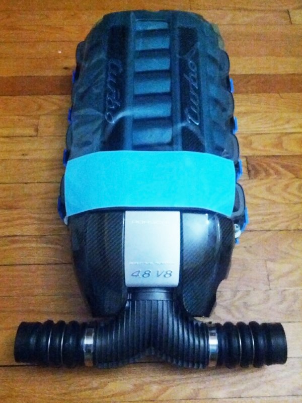

          Update:
          So it looks like I am in a holding pattern until I can secure a 30mm closed-ended wrench for the replacement serpentine belt. I am replacing this as part of my preventative maintenance, along with a new set of spark plugs- not as part of the E81 upgrade package
          Since I have to remove the intake plenum and charge-pipes to replace the serpentine belt, I might as well wait and do it now.
          It seems impossible to get a 30mm wrench locally, so I have one getting overnighted from Amazon
          While I am at it, I might as well try to clean the gum buildup around the intake valves. DFI engines are known for this, so I was curious how bad mine would be after around 40K miles (see pics).
          In the meanwhile, here is a few pics to whet your collective palates:
          Before....
          Throttle body and spark plugs removed
          Intake manifold removed
          Closeup of gum buildup around valves
          Will clean as best as I can around the valve stems with B-12 Chemtool and then vacuum out loose deposits. Afterwards, I will run Techron through the fuel system to help with whatever residue is left. I would not pull the heads to do a proper cleaning, unless there was a problem.
          Besides the carbon badges and color, the intake manifolds do not look too different
          Old intake manifold looks pretty clean
          CTT Throttle body measures just over 78mm
          New CTTS Throttle body measures just over 84mm.. WOW!
