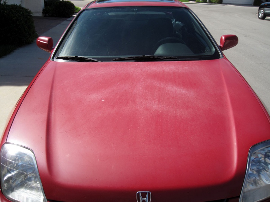

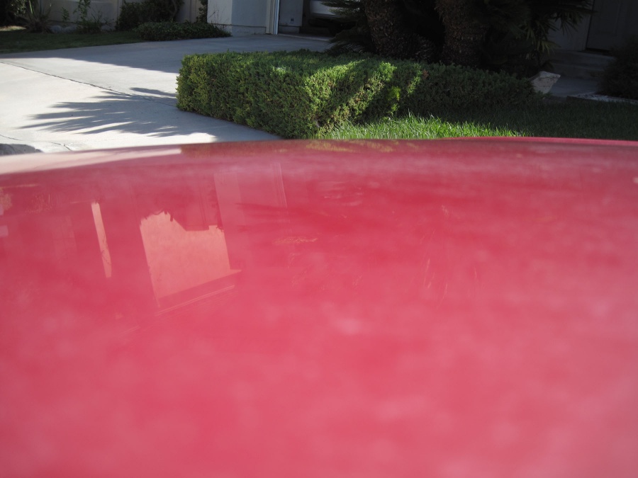

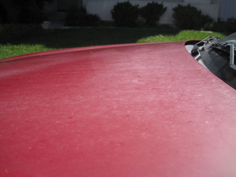

Is there any hope left in this paint??
Hi Moe: Here are some photos of my 97 Prelude weekly driver that has sat outside for the last 5 years or so: Very severe damage to upper facing panels, but primarily the hood. I think the clearcoat is still there, as you can see from certain angles. How, if at all possible, can I correct this embarrassment? I have all of the Menzerna products and pads that I purchased from you. Is there any life left in this paint, or should I not waste my time?? Thank you in advance!
YIKES!!! I'll tell you this....great room for improvement. The answer is YES..you can make it better. I can say this because I do see some gloss on the paint, which tells me the clear is simply oxidized. I forget what pads you have and which polish. But you'll need a yellow, orange, and red gp ccs pad. You'll need Menzerna SIP and Super Finish (Nano Polish PO106), and a good polisher like the FLEX. If you don't have a flex and have a pc, you'll be OK, it'll just take longer and the result won't be as good as a flex.
Here are the steps:
Polish: Menzerna SIP/GP Yellow Pad (optional of Orange Pad/SIP doesn't do the trick)
Polish: Menzerna SIP/GP Orange Pad
Polish: Menzerna Super Finish or Nano Polish/GP White Pad
Wax: Apply a sealant like einszett Glanz
ENJOY: Grab a beer or a glass of wine and stand back at the new prelude

Moe: Thank you for the quick response. I knew you were going to ask! I should have stated up front what I have:
Menzerna SIP and NanoPolish
Orange and white pads
PC
I am almost tempted to purchase the Flex just because I am so lazy about upkeep on my cars other than the GT-3. Thanks again.
