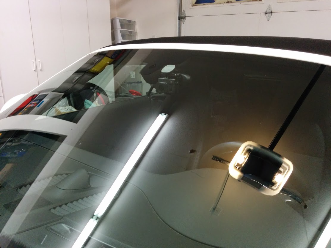

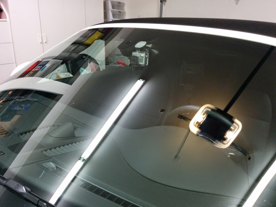

Next I decided to try an adhesive mount on the windscreen, right behind the rear-view mirror. This worked pretty good, much less un-sightly. You get a pretty good field of view without eating much of the driver's line of sight. Two issues though: The glare from Sport Chrono is front and center, and though the mount is black, the adhesive strip turns out to be white, so it's visible through the glass... need to look into possible black tape alternatives. Additionally, the exoskeleton that comes with the GoPro really stands out, for a stealthier option, I purchased the blackout case.
Default:
Blackout:

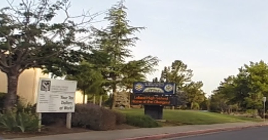

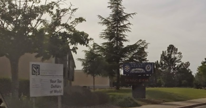

In terms of image quality, I think the 2.7k is clearly better than the 1080p, check out these crops of the same signs:
1080p
2.7k

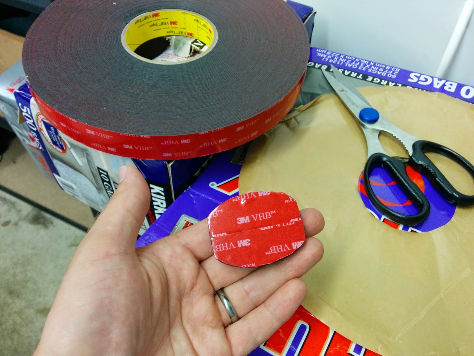

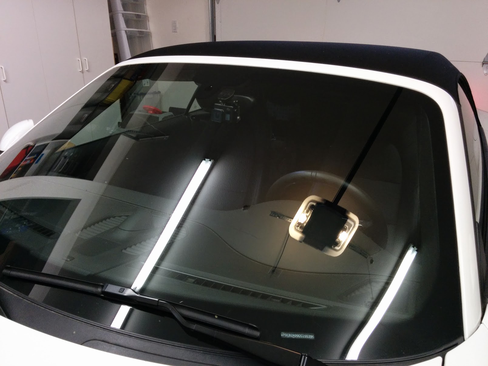

Two updates:
I replaced the white adhesive tape on the mount with black adhesive tape. I ordered 3M 5952 VHB, which is a close cousin to the factory 3M 4991 VHB tape (only available in white and grey). The old mount came off very easy, hair dryer on hot for about 3 minutes and it popped right off. I trimmed the 5952 tape to fit the mount, then stuck it on. I think it looks a lot better, but I might have put it a tad too low... might re-adjust later since it's so easy.
The other update is that I got the extended battery 'bacpac', which is more than capable of powering my entire commute. However, it's significantly bulkier, and I have to use a non-blacked out backing on my blackout case. It might try painting the backing to match the rest of the blackout housing, but I think I'm going to try hard-wiring to the power first.
Here's the trimmed tape:
And here's how it looks mounted:
