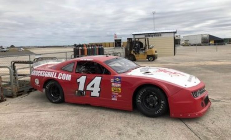

You guys might remember me from way back. I ran and won all the HPDEs and I had a great time, moved into instructing and now I race. But I switched over to something more economical and fun. Porsche 944. I spend $10K per year on racing, and that gets a lot of seat time and I win sometimes, which is awesome.
This car cost me $11K to buy and build, incliding the AIM DASH.
Next year I’m moving to this monster late model stock car, set up for road racing, another $11K beauty:
