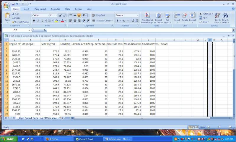

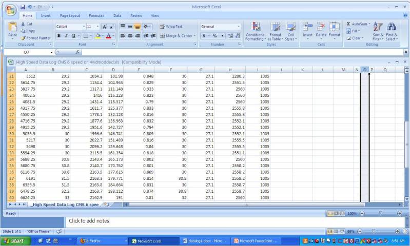

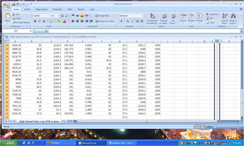

Here are some data logs from champions IC's on a 750hp 997.1 car I think. Not the perfect comparison since cars are different and conditions are different. However, it would be interesting to see the GT2RS coolers in a car of this power level to see what the flow restriction does during a data log of runs.
The jpgs are sequential

Does anyone else here notice that the IAT's for the above cannot possibly be correct for the champion IC's test?
ambient temp was 27 degrees and max IAT was 33 degrees.
I know that the measurement of IAT was probably from maf sensor via durametric or something similar, but this does not make sense?
Also, on the graph below, I noticed that there is a huge difference between starting IAT's. 11C versus 19C much larger differential than the quoted ambient temps of 9C and 12C. This test does not appropriately show apples to apples, unfortunately.
