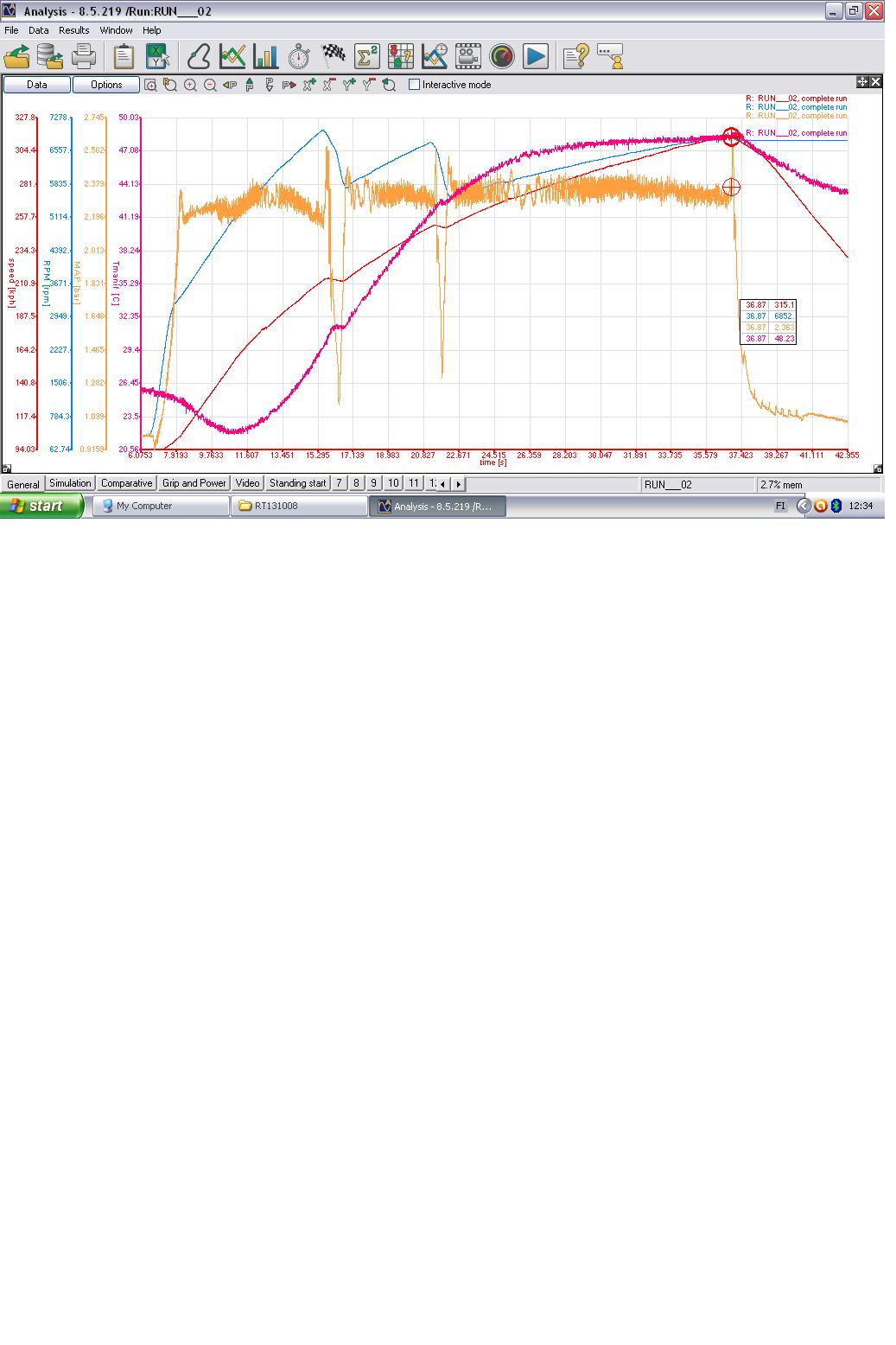

Here's my test of 997.2 ICs:
100-200 km/h 6.57 sec / 280m
100-300 km/h 24.51 sec / 1560 m
200-300 km/h 17.94 sec / 1280 m
100-315 km/h 29.12 sec / 1949 m
-GPS altitude at the start of the run 530 m, at 200 km/h 522 m and at 315 km/h 468 m.
-OAT +13C, dew point +12C, 1025 hPa. (OAT on instrument panel +15C)
-Aral 102 (RON) SuperPlus fuel
-Location: Autobahn A1 north of Nürburg, direction Köln
-While the IAT curve is similar to other full pulls, the delta T is slightly higher. I must redesign my IC intakes over the rear fenders.

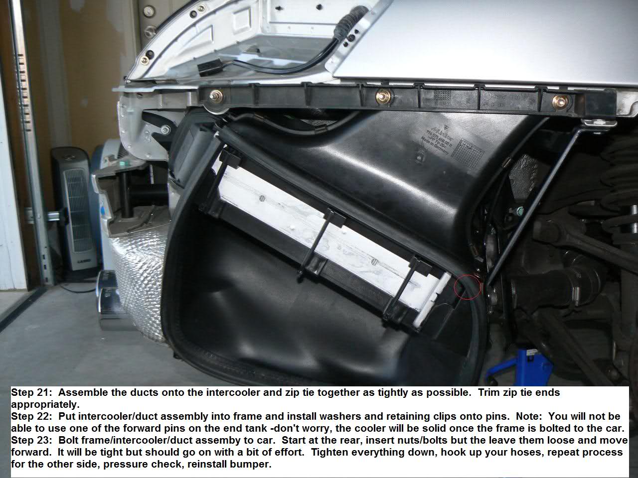

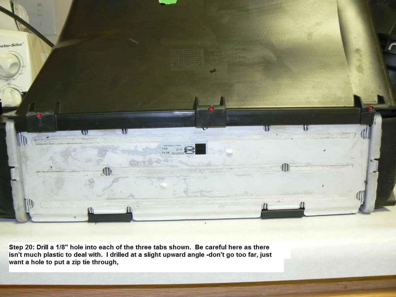

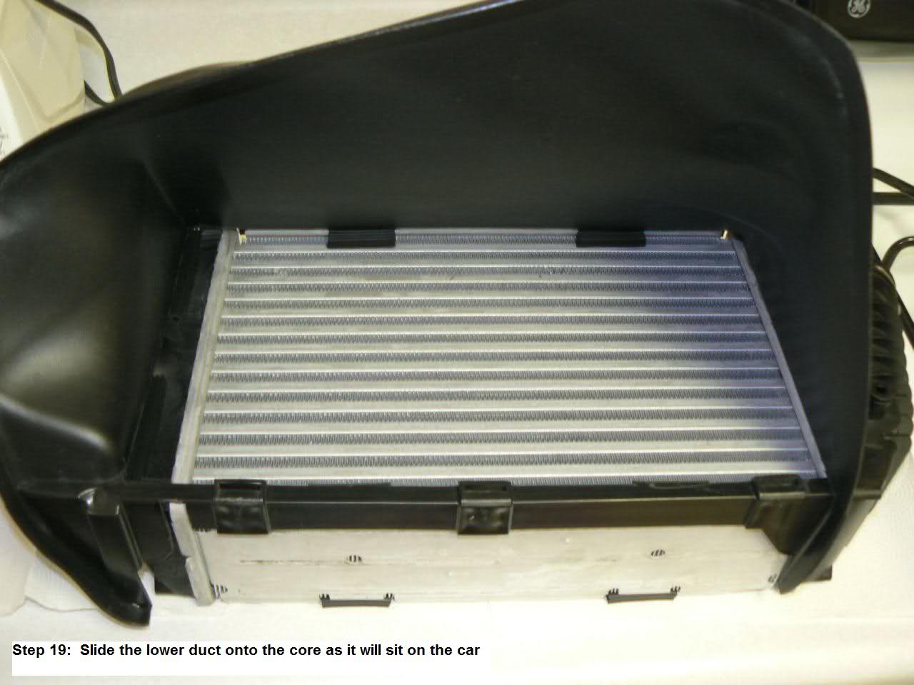

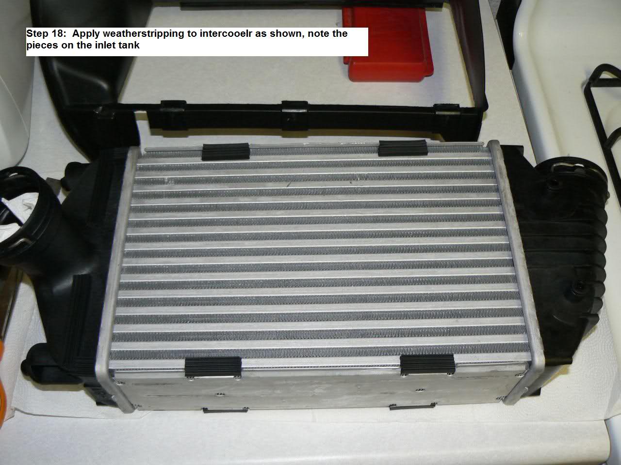

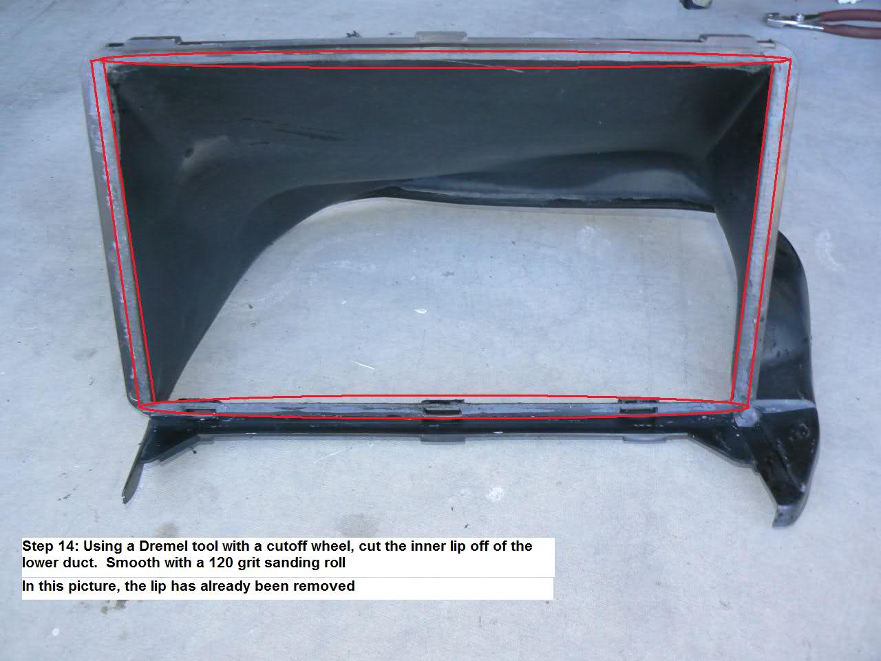

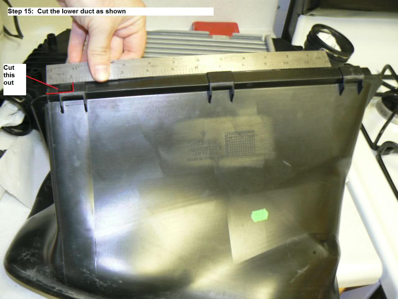

Upper duct done, now on to the lower:
Edit: Step 21.5, you'll need to trim a small piece on the area where you put the stock weather stripping back on (the rubber that goes against the bumper) so it will guide on to the upper portion. I've circled it in red -it'll make sense when you're trying to get the stripping back on.
I know there is no step 5, but does anyone have the pictures/steps for the missing steps (8, 9, 12, 17)?
Any help would be great.
Thanks
