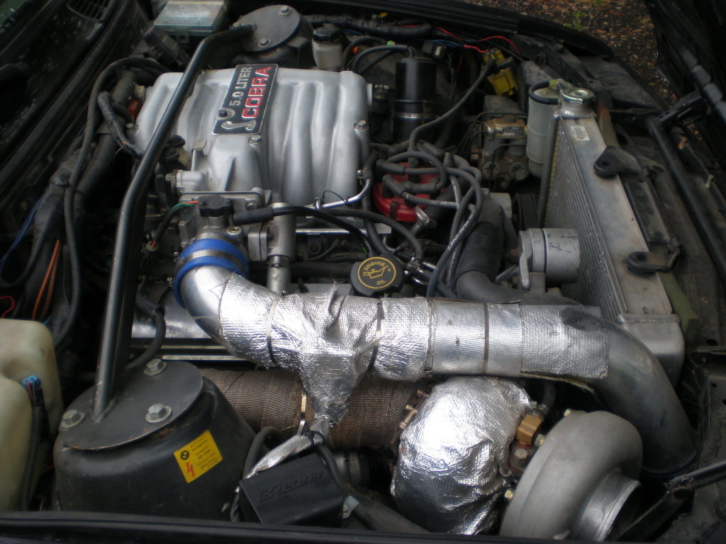

Back in my turbocharged 5.0'ford days, I swapped an aluminum headed 5.0 t5 engine trans into a 91 BMW 318is, and topped it with a 66mm turbo. At 15# it would lift the heads and push water, dropped to 12# it would not. While I agree that once the head is lifted the gasket is living on borrowed time, this can go on for some time without knowing. The last set of gaskets did the same thing for about 6 months before I replaced them. It made 509whp at 11# and did so with stock internals and an engine put together from 3 separate engines.
As you can see I am all for budget builds, and just put an LS1 into an 03 996 cabrio automatic for my wife, because of the cost of rebuilding the 3.6 with scuffed numbed 6 cylinder. My theory on the boxster engines is all or nothing, simply because they r ally weren't designed to be rebuilt and it is expensive to do so.
