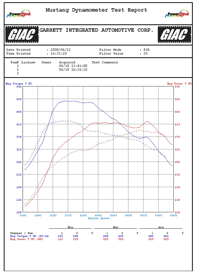

Thanks to the crew of GIAC, I had a day in paradise for a car enthusiast yesterday: Watching the pro’s tune the ECU of my Turbo.

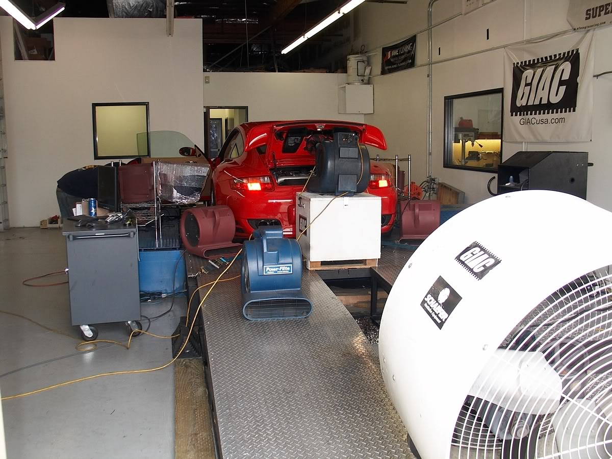

My impression of GIAC, having spent a day “infiltrating” the office and facility: A serious, very tightly run, very well organized operation. That said, the guys were at heart car guys like all of us here. I’ve read about what Garrett has done in the past, and it’s a pleasure to finally meet the G of GIAC (Garrett Integrated Automotive Corporation). I found out Garrett is a Porsche nut like us, owner of a rather well tuned 996 Turbo, and even better yet, is a graduate of Cal Berkeley. This has got to be a big plus as it seems some smart people go to school there (ha ha, nudge nudge wink wink, go Bears!). The crew was enthusiastic, helpful, and spent time explaining & answering my amateurish questions (Thank you!). I still forgot to ask what that curve Motec AF is, and which way is good. LOL.
Garrett, Andrew, Austin, and my mysterious test driver whose name I don’t remember (sorry) worked on my car. There were a few dyno runs with the stock chip, then the program is loaded onto a spare ECU (My stock ECU remains original and "untouched." The spare ECU is avail. for $650 from Sunset Porsche, plus 200 or so from the dealer to load the original Porsche DME program, then the flash goes on top of this.), and then the crew went to work fine tuning the curves, with tuning dynos in between. For those with Cargraphic exhausts, this means GIAC now has a file that’s specific to the exhaust and I believe you should make a point to ask for this file specifically.

A lot of people have reported on ECU tunes so I have very little to add here, especially since mine is only a modest stage 2. But a few points for those on the fence, my preliminary subjective evaluation (specific to my car and personal preference and not meant to be "authoritative" in any way, shape, or form; we all have different goals for our cars):

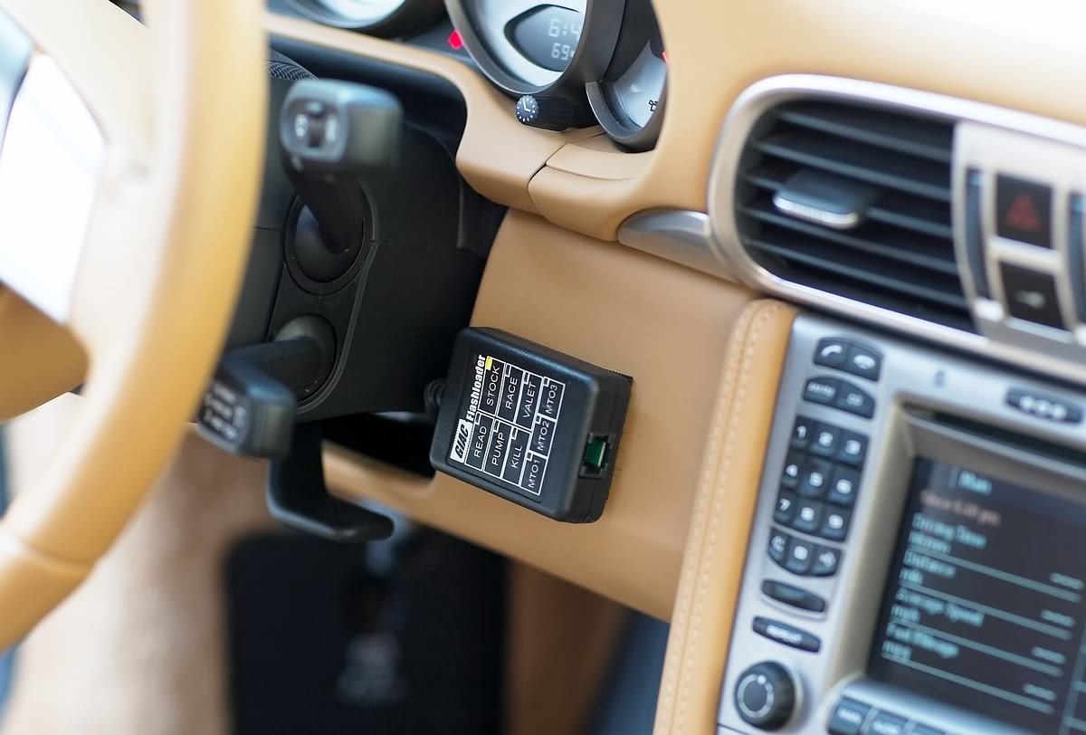

It's interesting to note that when you switch the car from Stock to Tune mode using the wonderful Flashloader, it doesn't feel faster until after a while (I don't know how long this adaptation takes; I've not tested it enough.). I've been told this is because the DME does take time to adapt.

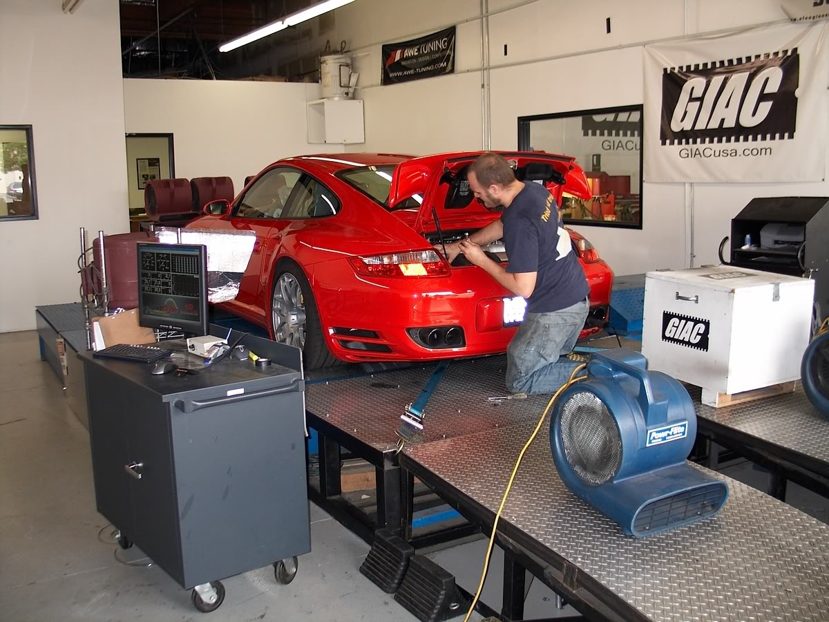

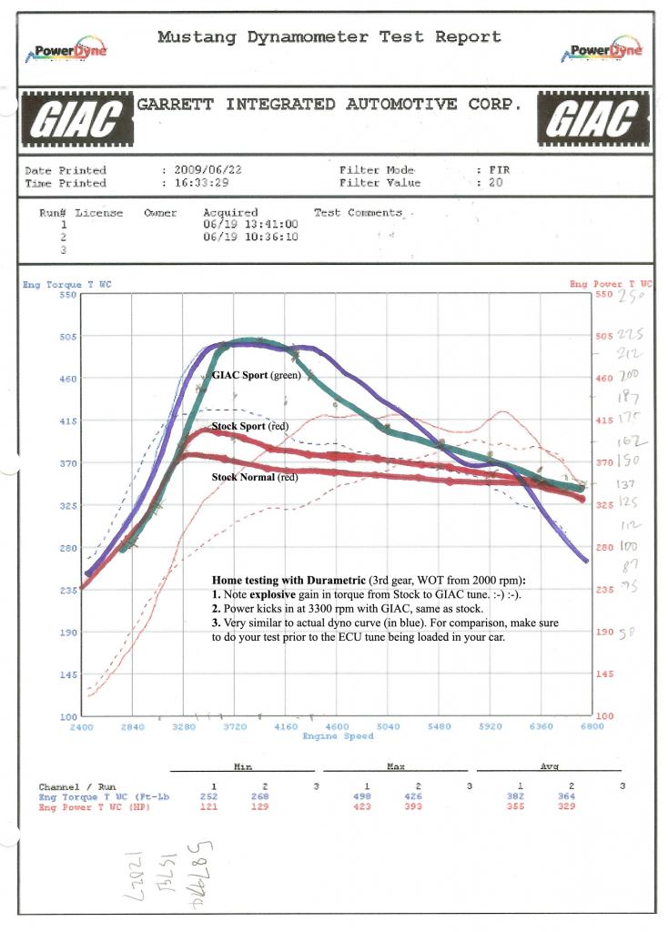

Dyno result and my confirmation by Durametric testing (clutch did slip in one of Durametric runs and possibly during Dyno):
Note significant build-up of torque early on at 3300 rpm which is same as stock (important for street driving), and nice wide torque plateau
. The car is a "humble" stage 2: simple tune + exhaust + lousy 91 California fuel, and yet you could clearly see what a HUGE difference this simple change makes. The Durametric testing is done by myself so there is no mucking around with the data. What a powerful and fun tool.
GIAC Time Improvement as measured by Durametric:
From 2500 to 6000 rpm (approx 38.5 mph to 92.5 mph)
Stock Normal 6.07 seconds
Stock Sport 5.88 secs
GIAC Normal 5.73 secs
GIAC Sport 5.38 secs
Below is Mustang Dyno of my car; in the second graph I confirmed the finding using Durametric. When you evaluate dyno, look at the whole curve, from low to high rpm to see the the true gain. You would like to see a broad fat curve, for example the torque curve in the graph below. Don't just look at the max gain, because this is just one point in the wide rpm band; a tune could have high max gain at one point, but rest of the curve is not as good, and that would be bad ("peaky").
Below is my Durametric testing of "Engine Load" parameter, overlaid on the chassis-dyno graph from GIAC. The red and green curves are from Durametric graphing the parameter called "Engine Load," the blue curve is torque curve from actual dyno. Note how the green Durametric curve for "Engine Load" follows the blue Dyno curve for torque - this is how you could use Durametric to test your car, a poor man's chassis dyno!
The bottom line is still Vbov time, or same day/same setting before and after dyno's, but Durametric is a lot of fun and a way to confirm what you tuner has done to your car. My max engine load is around 220 (stage 2 - exhaust only, shiiity California fuel), see if you could beat it
. Note also the huge jump in torque - compare green curve to red curve: "horsepower sells cars, torque wins races."
Dyno of my car: below, I've included both original GIAC dyno curve, and my own Durametric confirmation of the hp and torque gain using "engine load."
Durametric time measurement of GIAC tune from 2500-6000 rpm, actual Durametric measurement Here - Post 140 & 148 (Extremely interesting
, read it!)Durametric testing and resulting curves: Here - Post 138
. The car is a "humble" stage 2: simple tune + exhaust + lousy 91 California fuel, and yet you could clearly see what a HUGE difference this simple change makes. The Durametric testing is done by myself so there is no mucking around with the data. What a powerful and fun tool. GIAC Time Improvement as measured by Durametric:
. Note also the huge jump in torque - compare green curve to red curve: "horsepower sells cars, torque wins races."Last edited by cannga; Aug 4, 2016 at 03:00 PM. Reason: Updating of the initial review now that I have more time with the car.

Picture of the flash loader:
