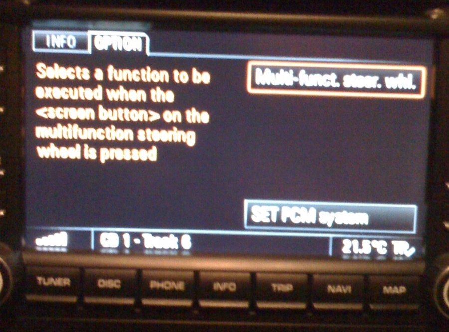

Originally Posted by JohnAMG
I told my dealer the MF function needs to be activated and they knew exactly what to do. I was charged for 1 hour labor. Everything works but I was expecting to see the MF configuration tab in the INFO section of PCM and I didn't see it being listed. For those of you whose car came with MF wheel, do you have the MF configuration tab in the PCM?
John
I just had my dealer install the multi-function upgrade that I purchased from Suncoast. Like yours, JohnAMG, everything with mine works, but there is no "Multi-function" configuration tab in the PCM for me either. Is this the case for you other guys who installed the upgrade?
Just as JohnAMG asked, I would also be interested in hearing from anyone who has the factory-installed multi-function wheel as to whether they have the tab that is described in the PCM 3.0 manual (this tab is supposed to let you select a specific PCM screen to appear when you press the "Page" button on the steering wheel, as opposed to the default mode of cycling through the various screens with each push of the button).
Yes, mine has the option available. Select Info / Options and it's there.
BTW, my 09 C2S shipped from the factory with a standard C2S wheel. I had the multi-function added at the dealer after I saw the car so it was essentially the same as yours apart from my car being a 6-speed rather than PDK.
Thanks. Sounds like a return visit to the dealer is in order for me.
Is the option that is available just to select which PCM screen you want to assign to the button, or are there other choices as well?
Just the one choice as attached. Pretty poor photo sorry.
