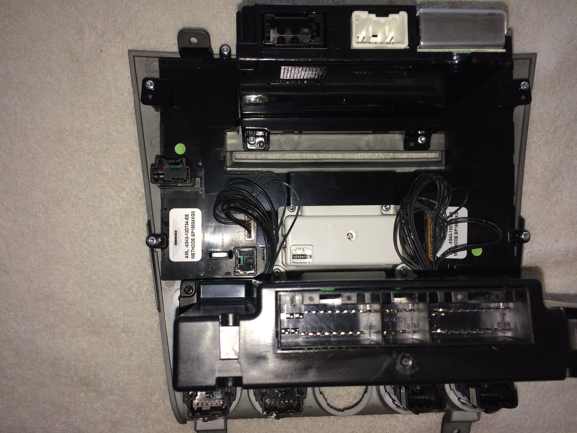

Here's a picture from my 2006 DB9, so should be the same as your 2007 Vantage. Note the tabs at the top & bottom where the infotainment unit bolts in. The top tabs are hidden under the ski slope, so it has to come off. The bottom ones require you to remove the center console to access them.
The wiring to the bottom buttons is really short. Be prepared to lose some skin off your knuckles.

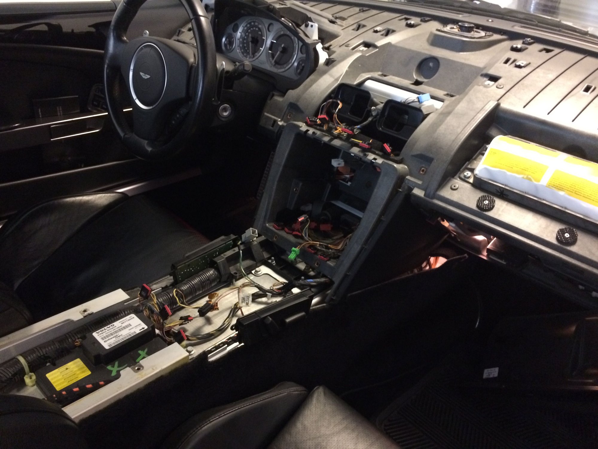

More extreme than what you need to do, but this is what it looks like under there...

Ok, that is very useful...I'm concerned about the ski slope removal, it's the piano black and they're notorious for cracking. I know there is a detent point to remove it, but I have never successfully located it in the vent. How are the switches retained in the stack? friction? I don't see a spring clip but I imagine the short harness would keep them well in place though.

The switches have flat metal "prongs" that are anchored at the connector end, and spread behind the fascia. Squeeze close to the fascia and push from the back to pull it through the front side. You'll be lucky if one or two don't break off. I was able to superglue the prongs back on.

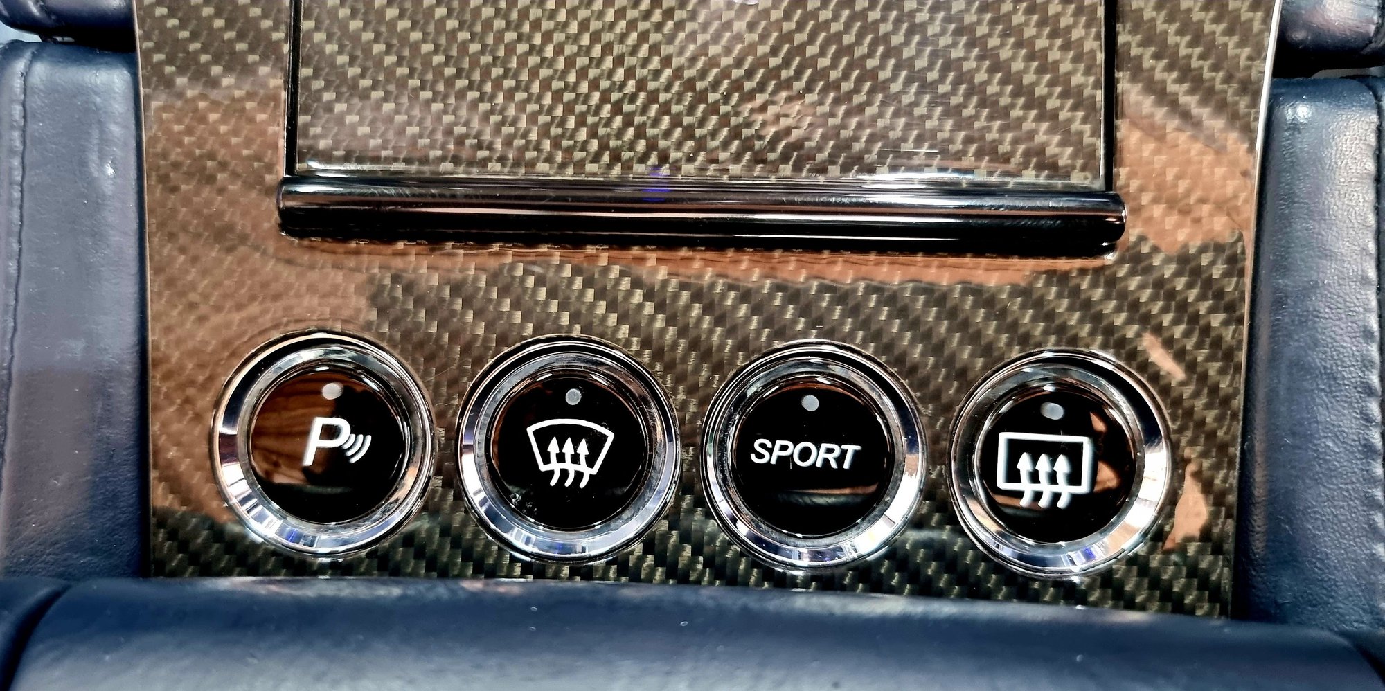

I understood that Bamford Rose had stopped doing the customised glass switches (As Aston Martin only did the Glass Switches on th emuch later cars a lot of them are not available, such as AirCon, heated window etc.) which is why I did my own - much cheaper, details below
https://db9s.com/aston-martin-custom-glass-switches/

I’m just creating bespoke glass switches for my DBS. Most of the templates Paul provided don’t work for DBS, so - inspired by his results - I’ve got a local sign writer to make some up for me (took him 15mins) and I’m just waiting on the vinyl prints now. I’ve also found that the glass switches from the DB11 are almost the same as the VH cars - they come apart the same way and then the crystal bits fit into the original VH switch bodies. As the VH car glass switches are all very expensive, I am saving myself about £50 a button.
