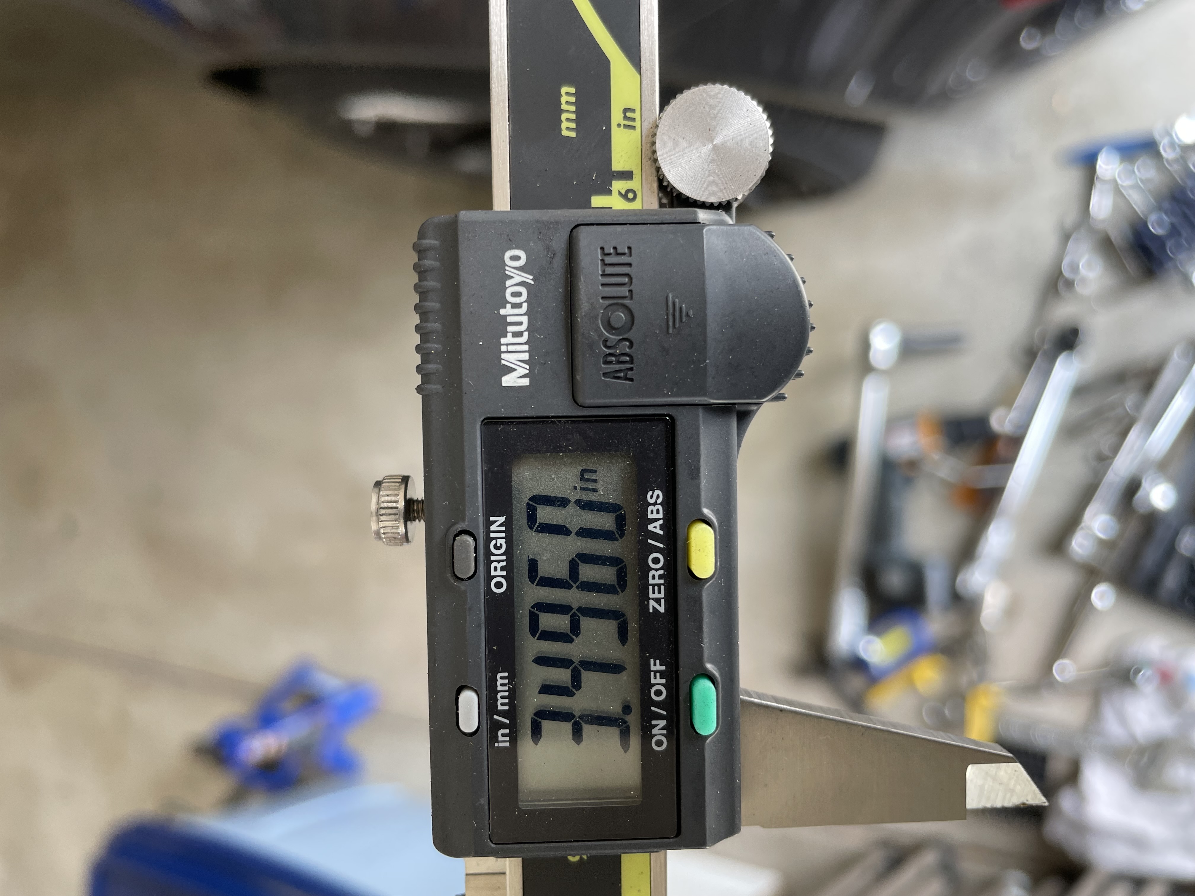

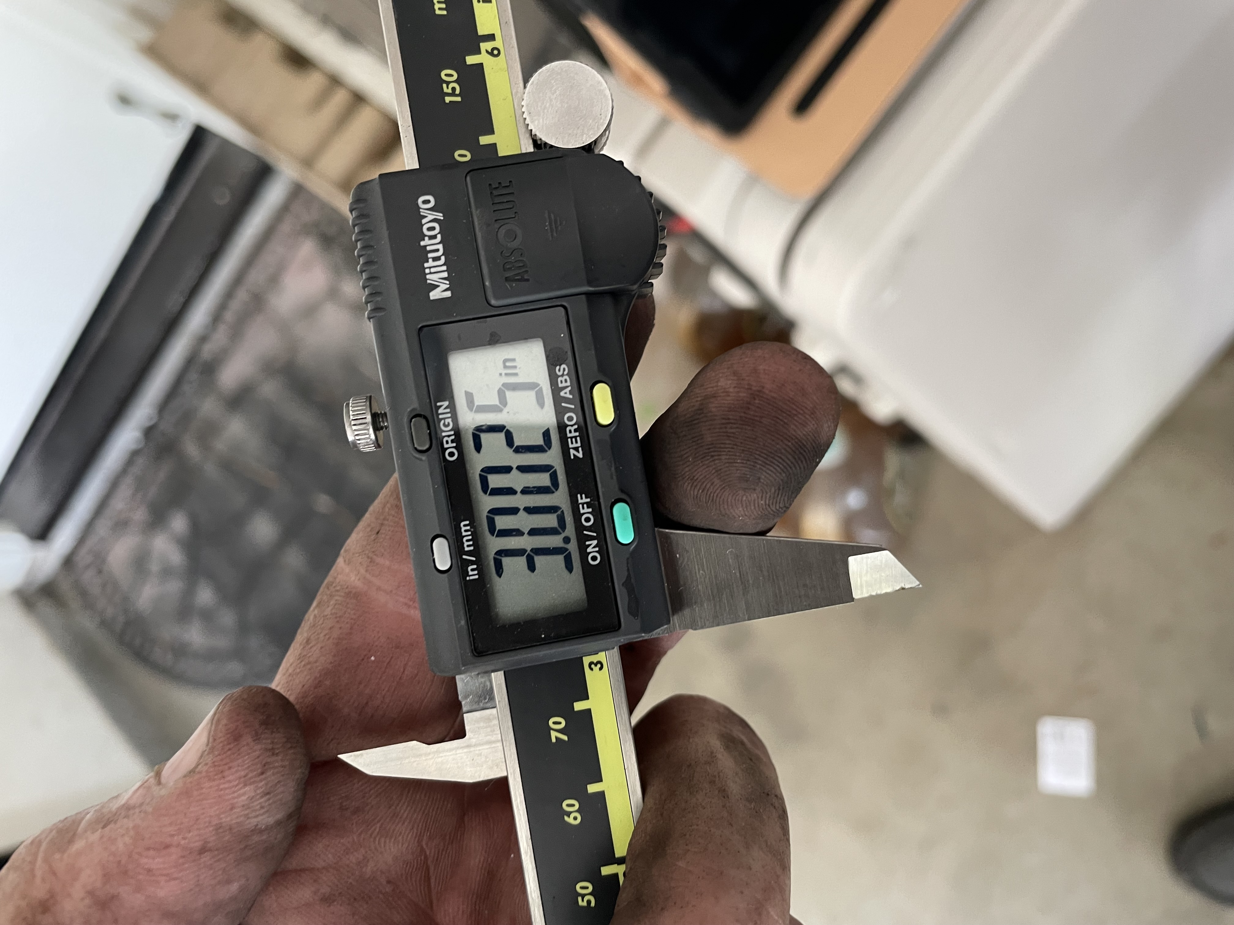

Nope, I used a caliper to set all the height and worked perfectly on the first try. I used the stock uncompressed height and started there to see what the total height should be on the coil overs. Then measured old vs new to get the height I wanted, using the caliper to make sure both sides were equal. After I was done, I thought to to set the rear a little lower but it settled nicely so I left it alone. These are the measurements I used between the adjustment rings. I don't recall which measurement is front or rear. The last picture shows the original height with OEM shocks/springs and the new height with the coli overs. Yes, I should have been wearing work gloves :-)

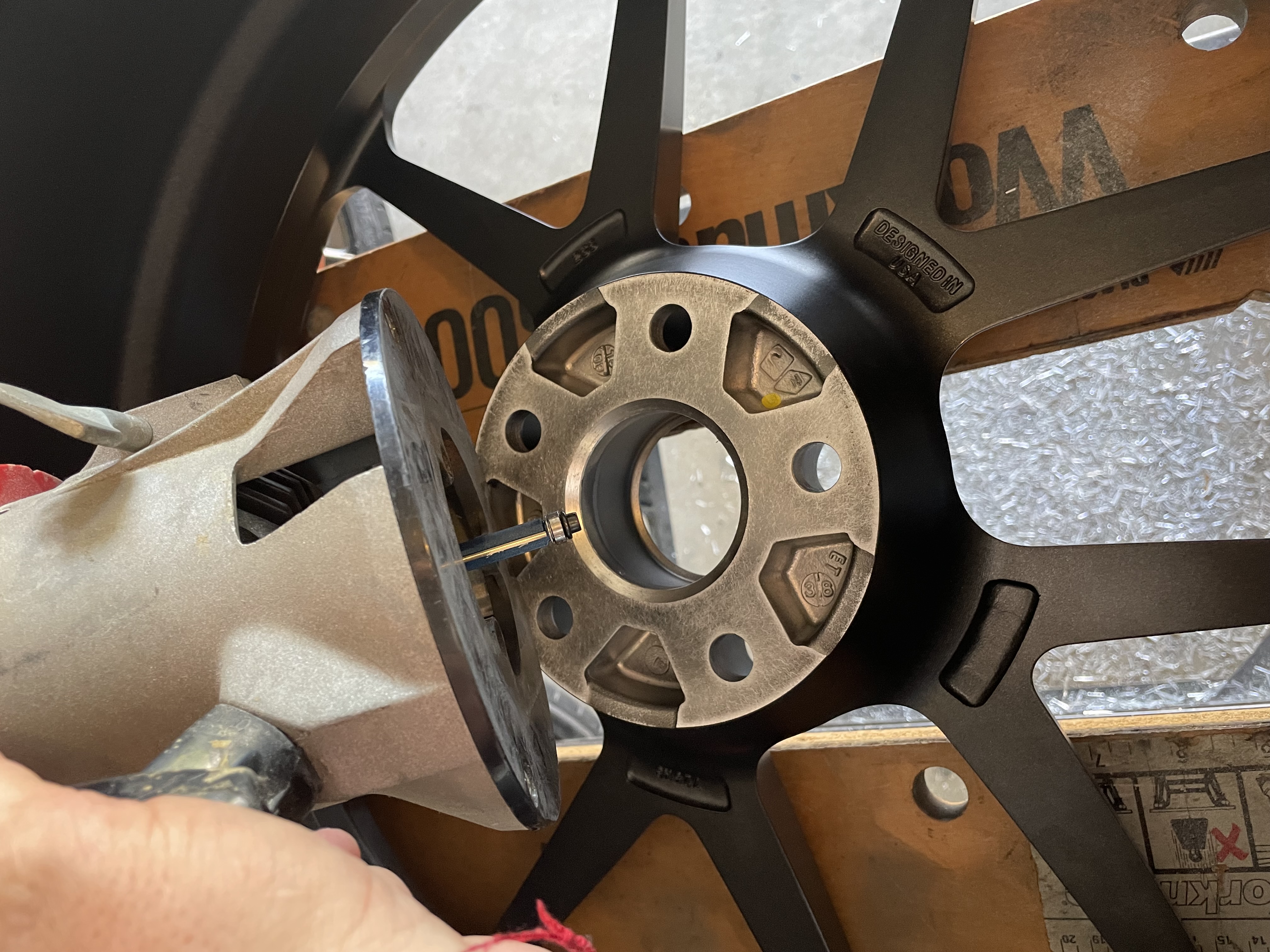

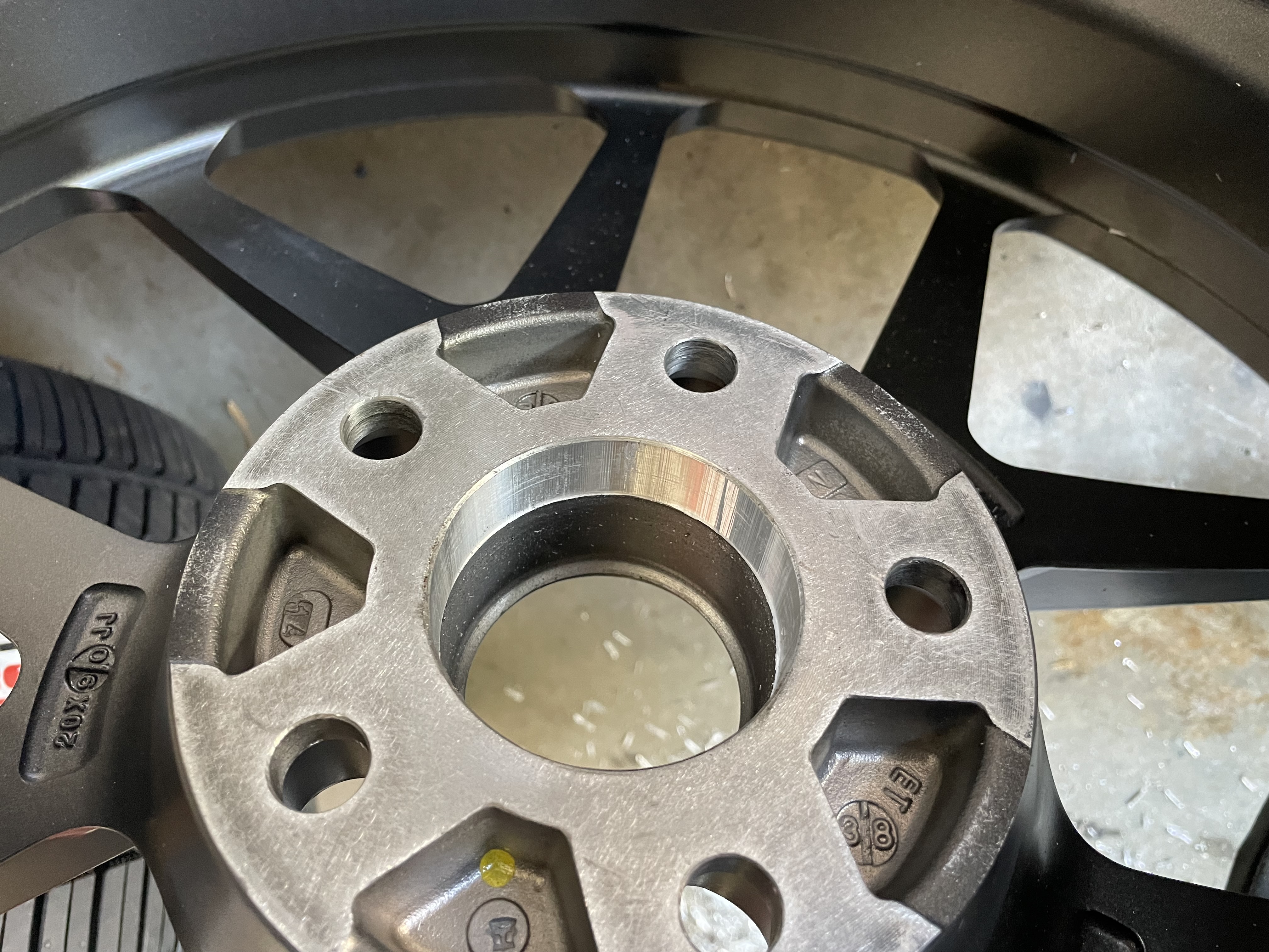

Yes, they are Vorsteiner V-FF 101 20x9 et38 front 255/35/20 tires and 20x11 et50 rear 305/30/20 tires. The hubs on the rear were 2mm too small, so I routed them larger for a perfect hub-centric fitment. :-)
