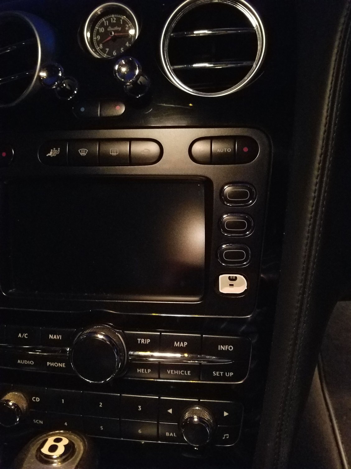

Somehow today I was checking tire pressures and when I pushed the select button on the radio to reset tire pressures, the button popped off. The silver outer part of the button I have but the inner blank part with white edge dropped in The car and I cannot find it. I have attached a pic I found online, basically it is the button next to the Select button in the pic.
Anyone know where I can get a new one?

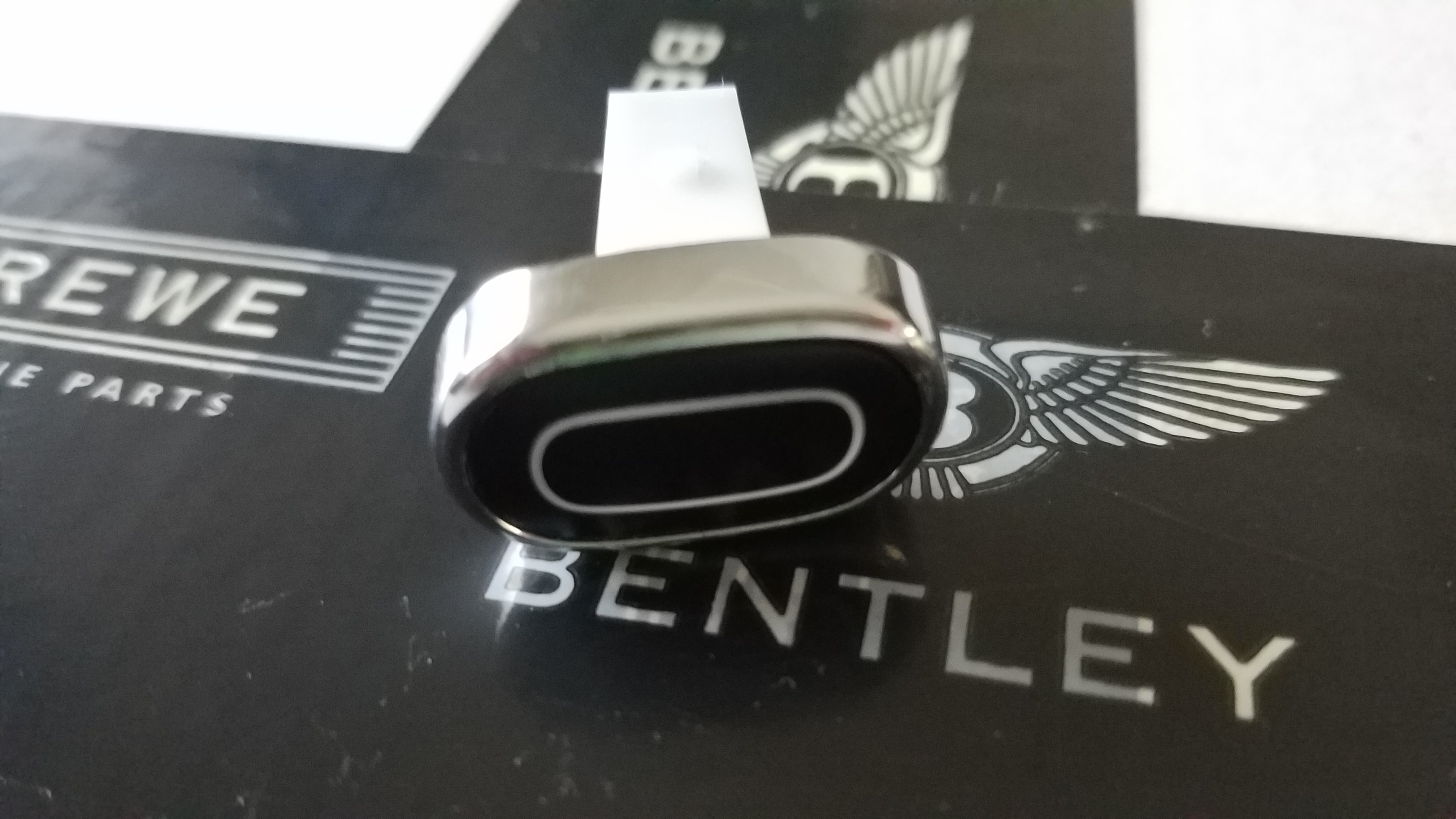

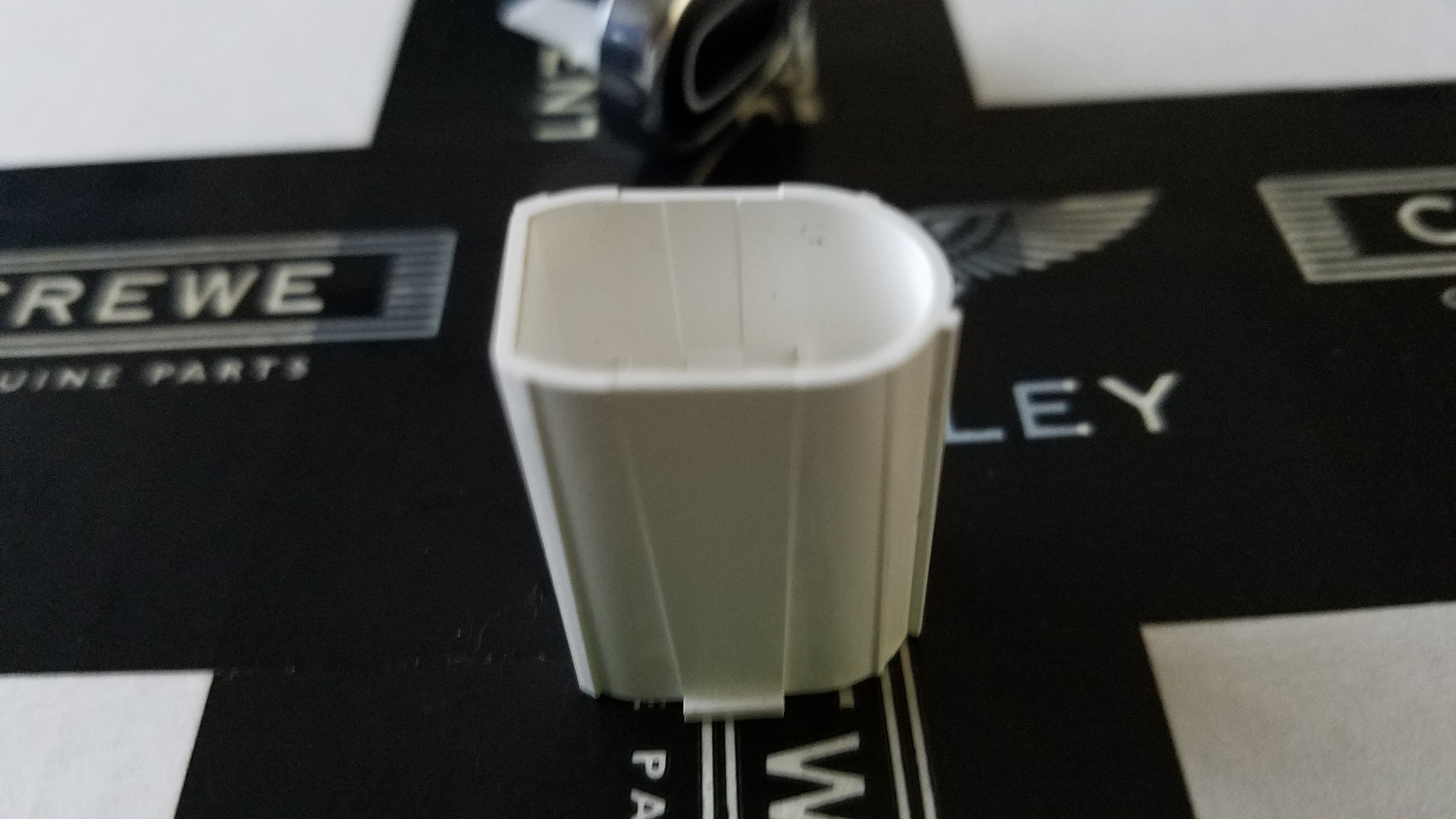

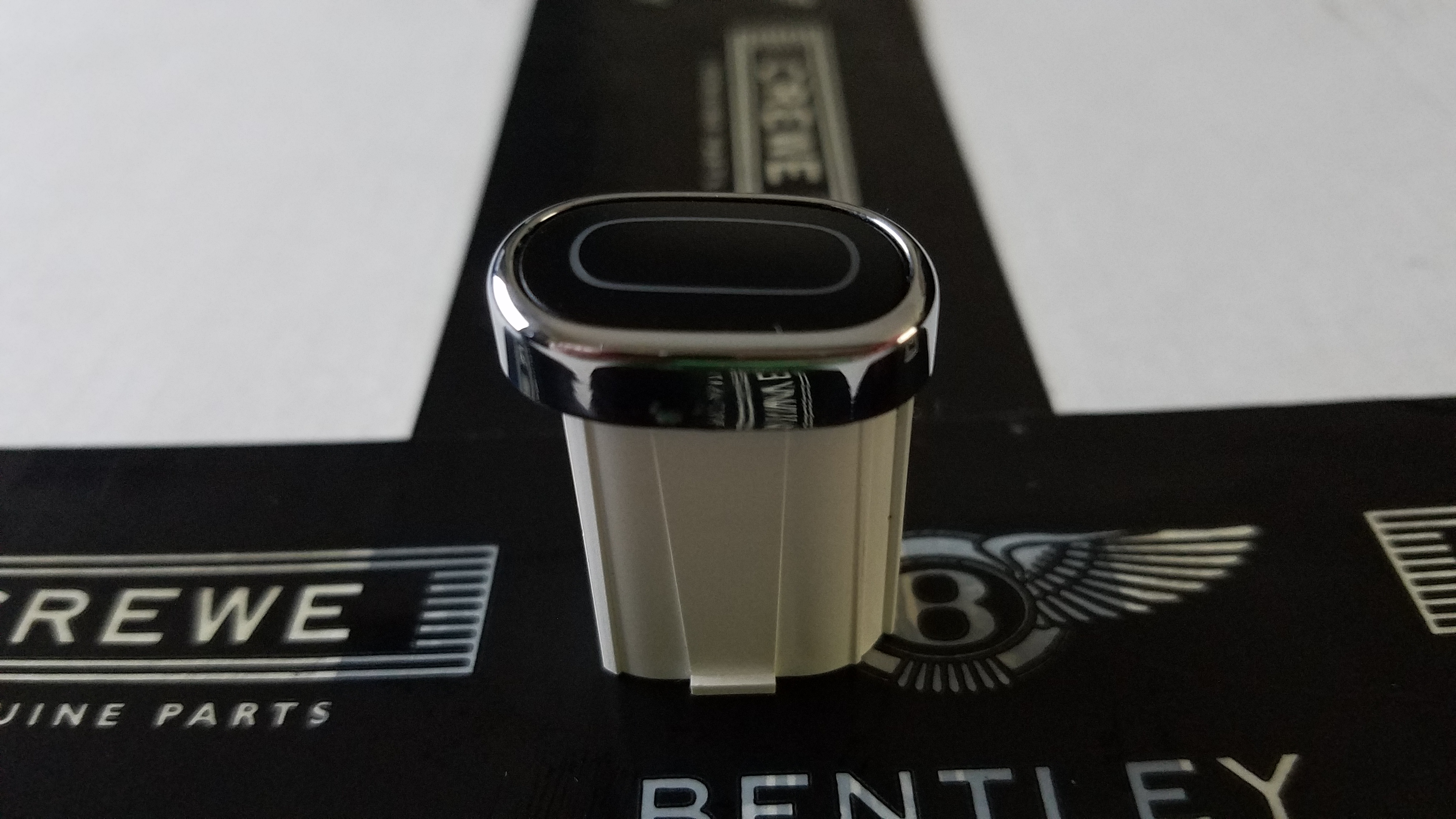

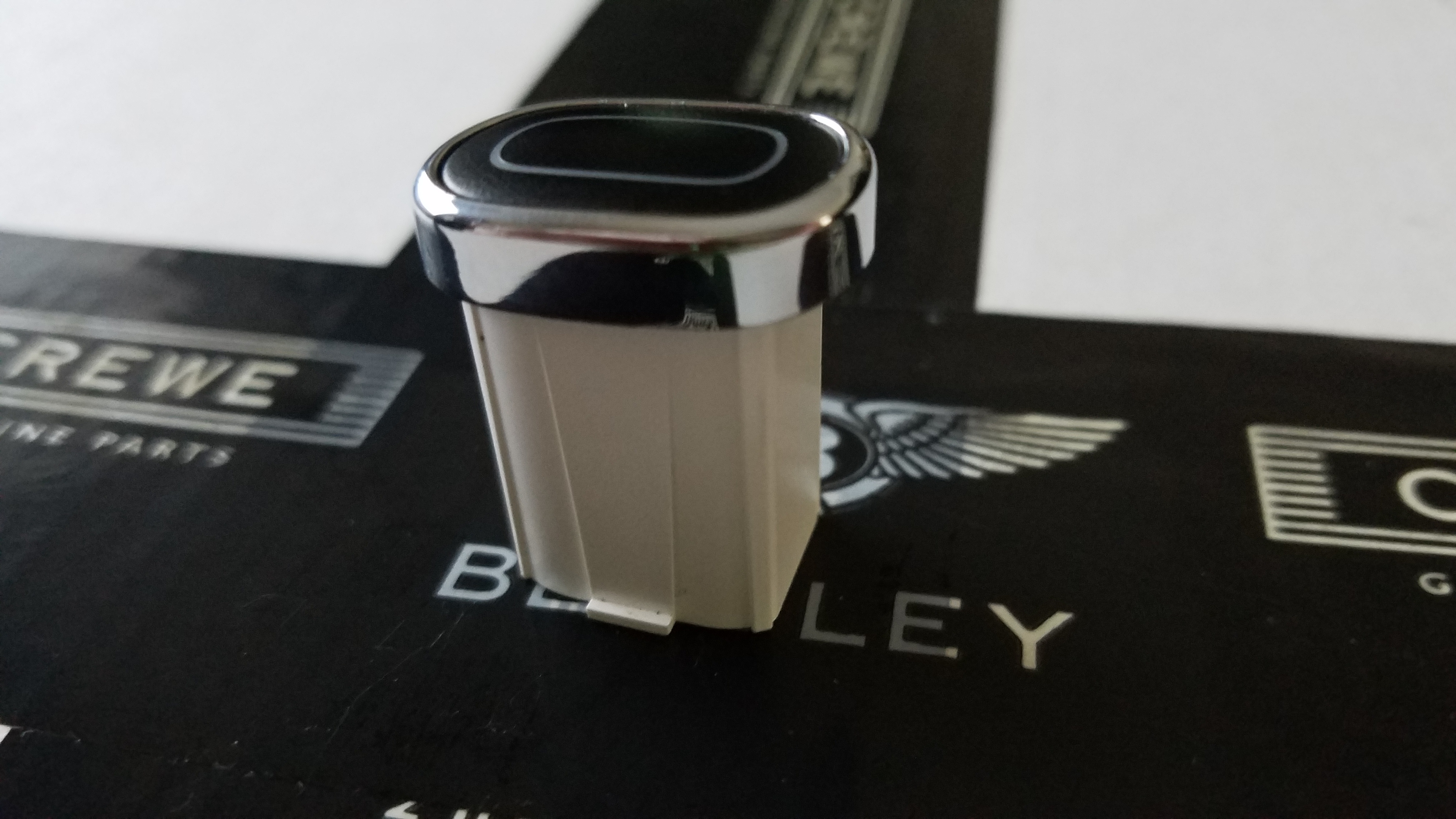

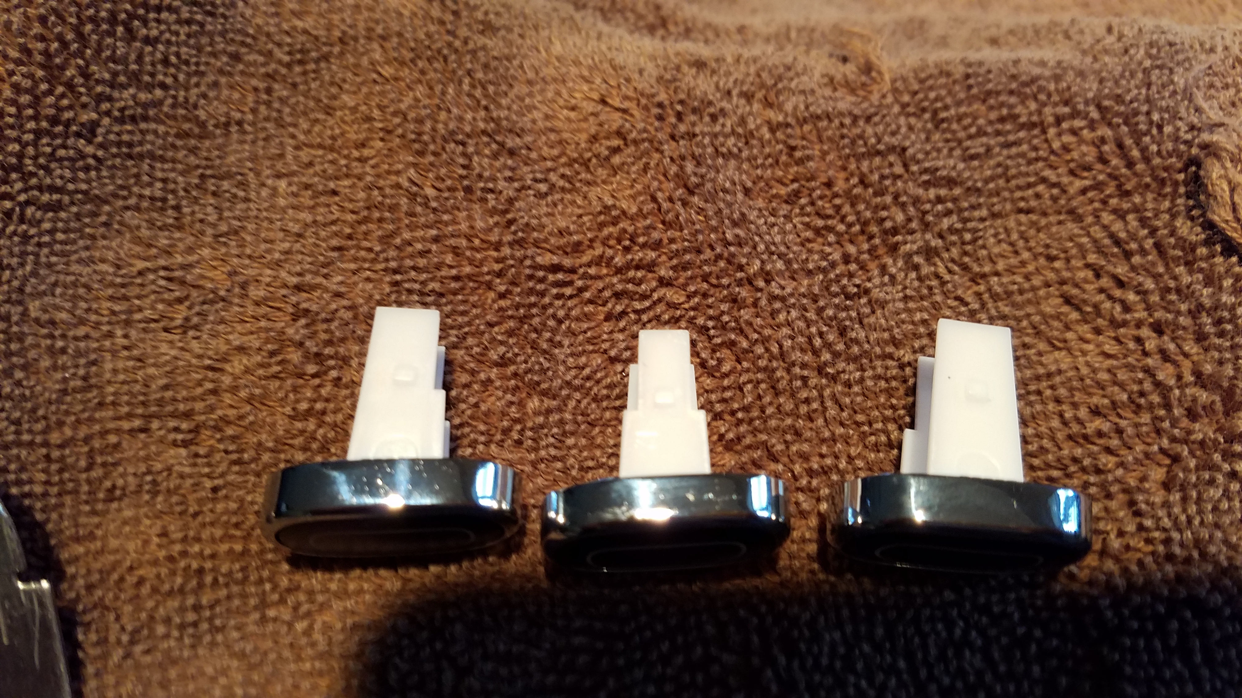

Hello Remy,
I have the buttons, would you believe each one is different, see picture of 3 buttons lying on their sides and notice the three different cuts of the stems.... now that's ridiculous !!

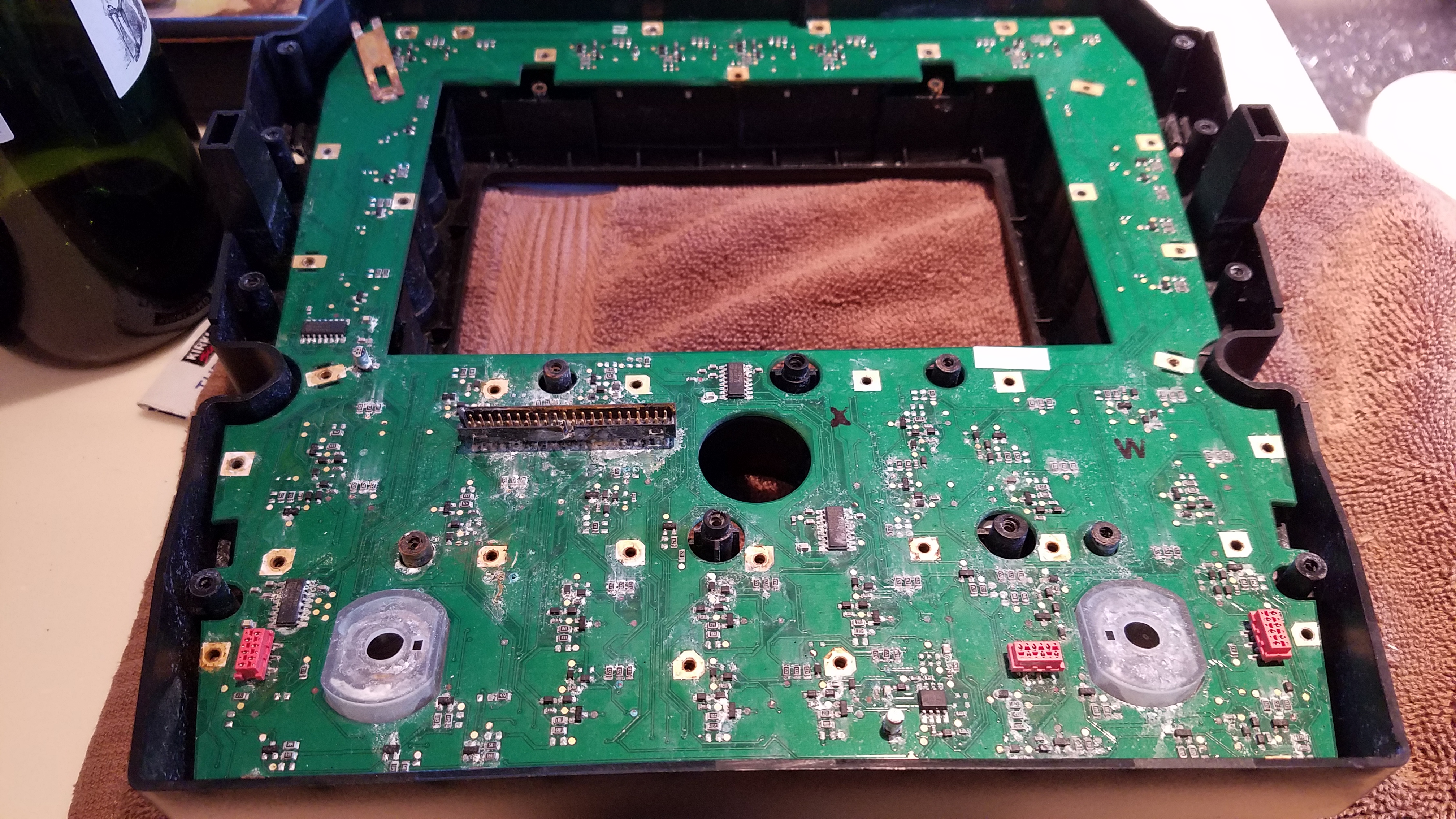

Now if just your button popped off and the retainer is good, you should be fine, BUT if the retainer is worn or broken for some reason then you must totally breakdown the face to expose the retainer located behind the circuit board, which alone is held down by 40+ tiny screws.
I will trade you for the bumper.....
You can PM me or call me at 908-507-6357, I will also be adding them to my listing in the marketplace.
https://www.6speedonline.com/forums/...arts-here.html

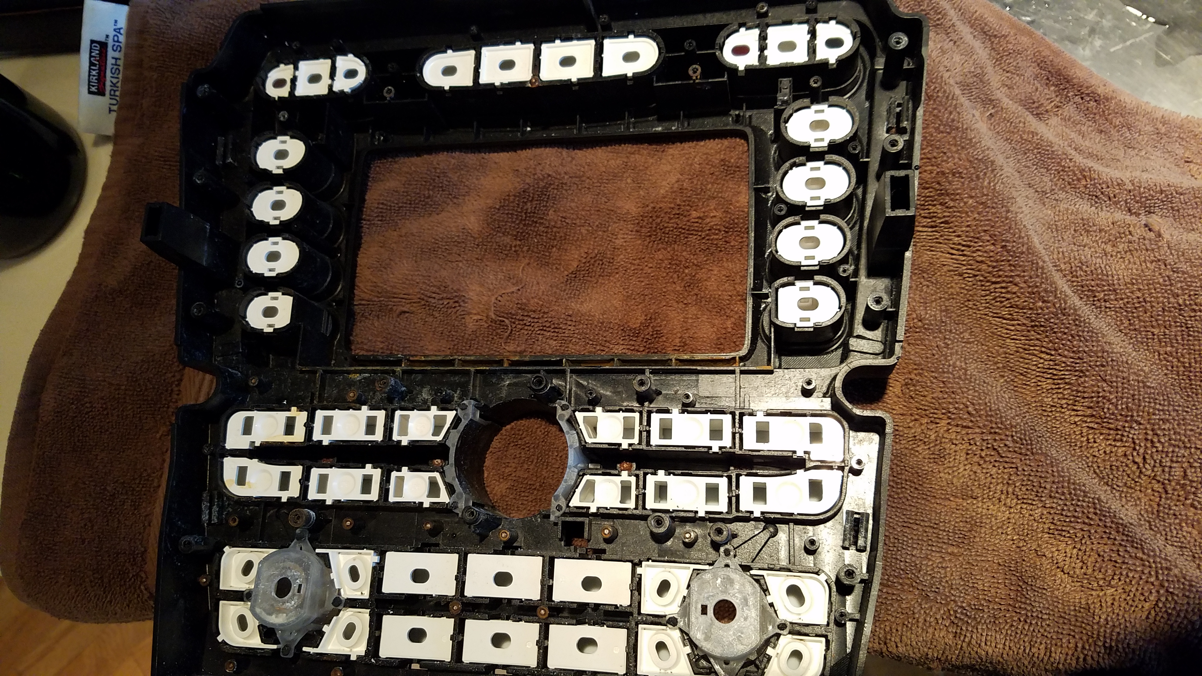

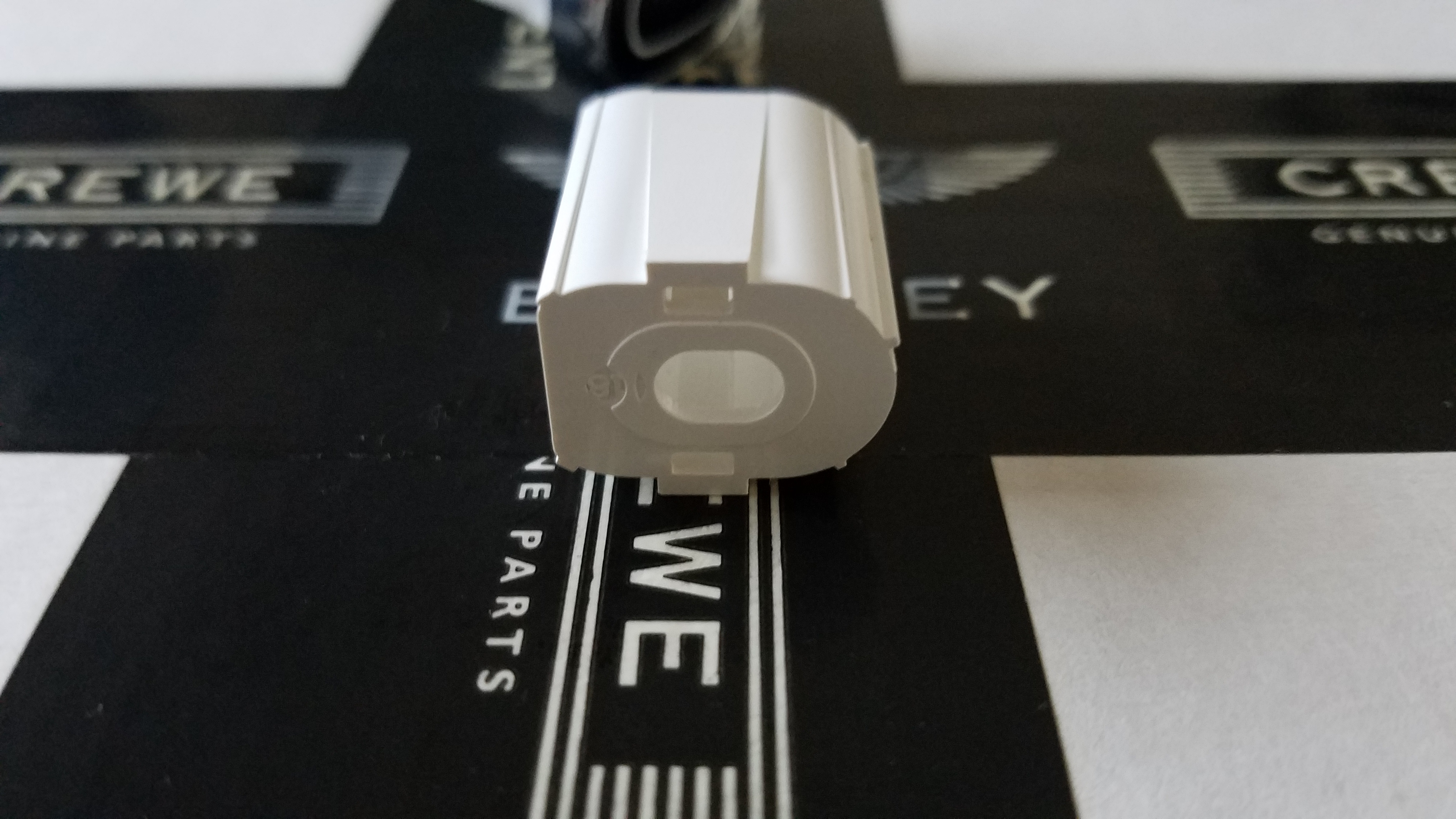

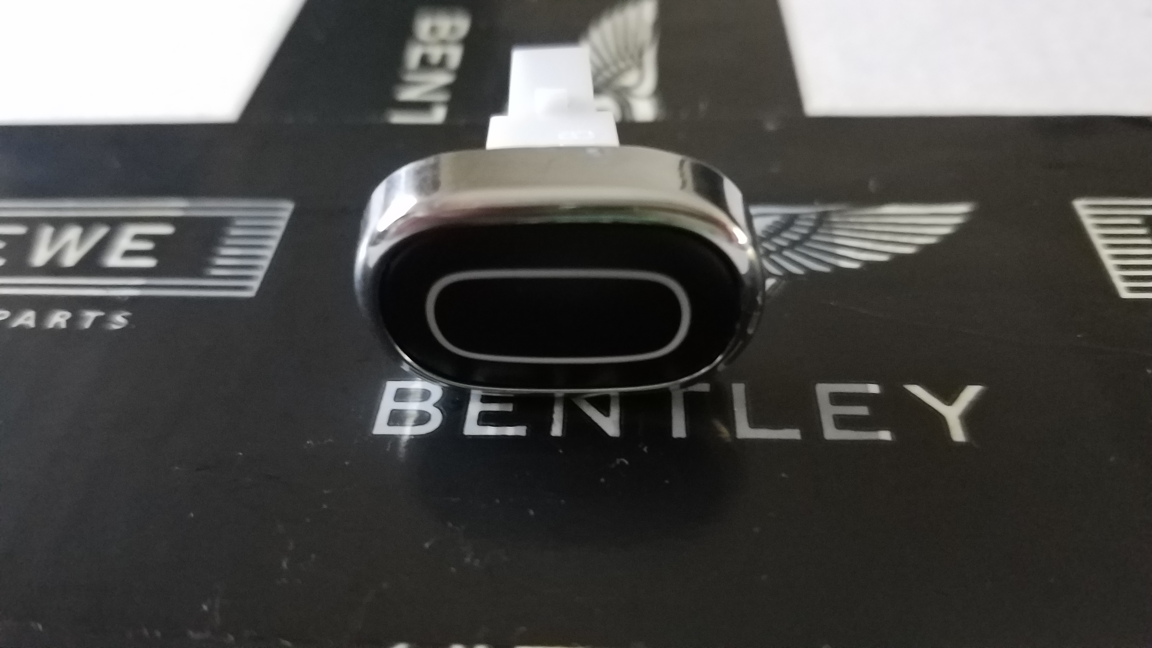

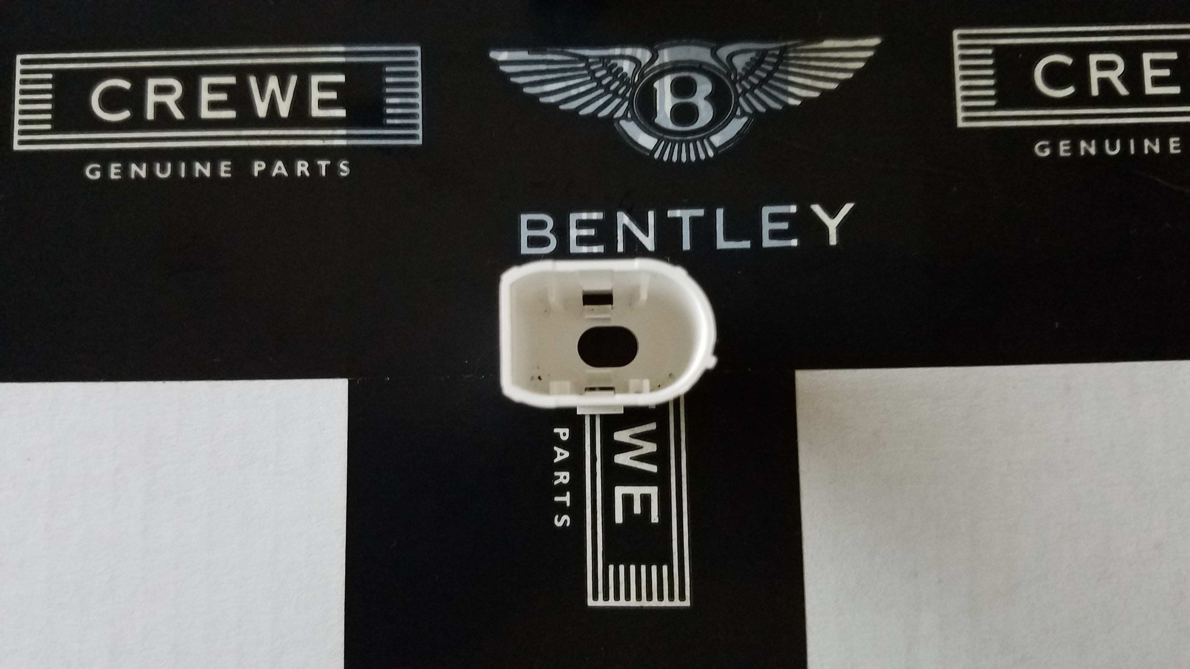

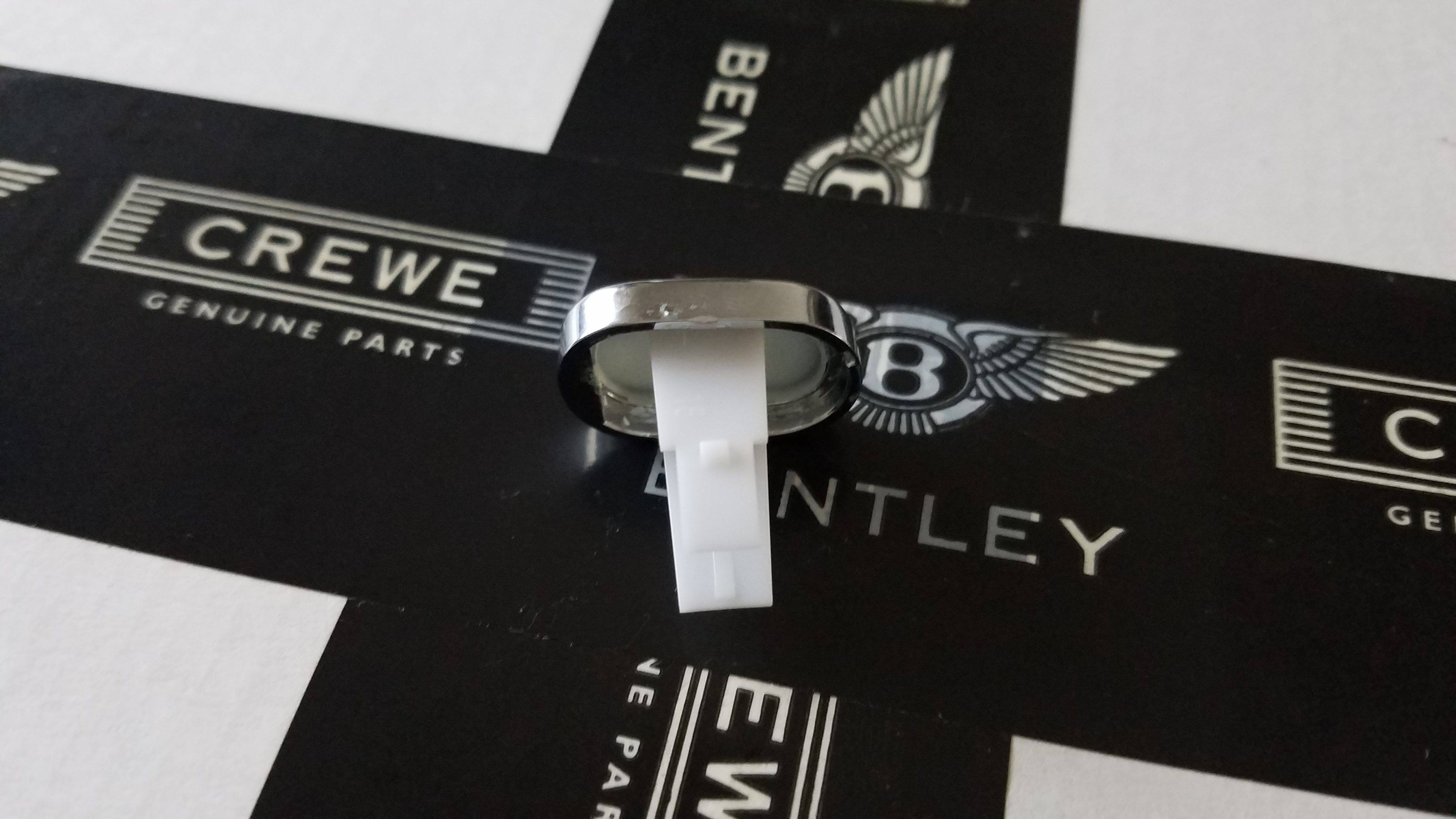

For Remy.

Johnny,
This what I have
Old Aug 28, 2016 | 07:23 PM
Johnny Hotspur GT's Avatar
Administrator
Joined: Jul 2014
Posts: 3,969
From: Montgomery NJ
Rep Power: 1002
Johnny Hotspur GT Is a GOD !Johnny Hotspur GT Is a GOD !Johnny Hotspur GT Is a GOD !Johnny Hotspur GT Is a GOD !Johnny Hotspur GT Is a GOD !Johnny Hotspur GT Is a GOD !Johnny Hotspur GT Is a GOD !Johnny Hotspur GT Is a GOD !Johnny Hotspur GT Is a GOD !Johnny Hotspur GT Is a GOD !Johnny Hotspur GT Is a GOD !
Great !
Please be sure that when you insert the replacement button that you take notice of the position nub at 4:00 on the retainer as shown in your picture, that nub must align with the receiver slot in the chrome ring for proper orientation of the button.
