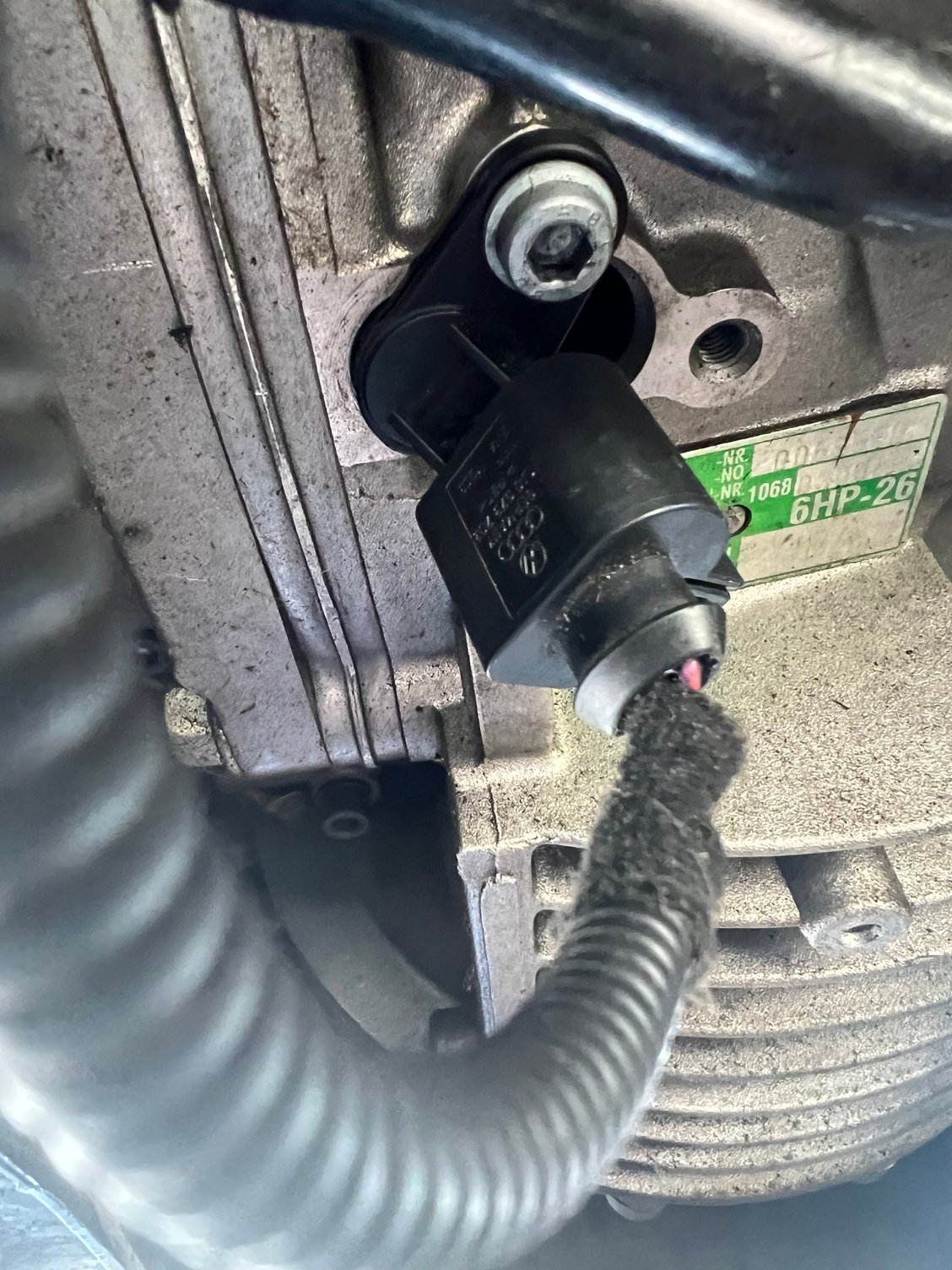

As to your issue, please see engine 2 fault code P0322, whereas you have a "Crankshaft Position Sensor" fault, as in "no signal", please check the 3 pin connector at the bottom of the transmission where it meets the engine flywheel as pictured below.
Replace the CPS if needed, post a picture of it as it stands now, possibly broken, disconnected or failed.

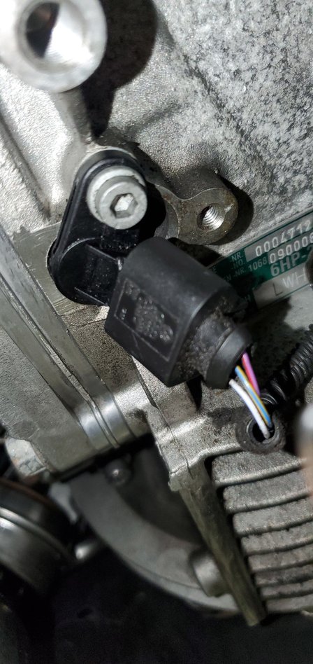

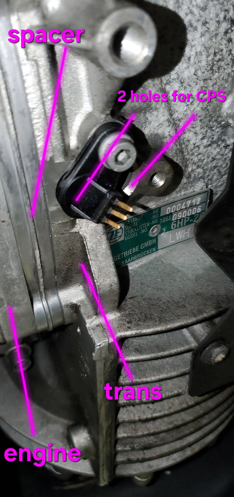

@Quinton27 ,
Your picture looks a little odd to me, and if your 2007 FS, has the same setup as I have pictured from my 2005 GT and 2011 GT Supersports engine transmission setup, then your CPS is in the wrong hole, as I have the engine block, the spacer, then the transmission, and the CPS is in the hole closest to the engine/towards the front, so, you may have the incorrect sensor in the incorrect hole, please remove the sensor and look in either hole for the slotted ring on the flywheel, the sensor should line up with the slots in the ring.
I will post the wiring diagram in the morning, but, please pull the sensor to confirm correct position.

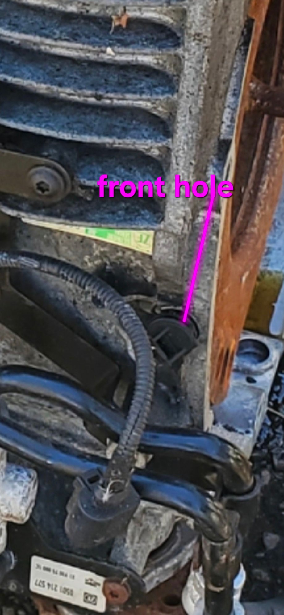

Quinton27
I’ve verified that the sensor is in the front hole, closest to the engine. I believe the previous owner replaced the sensor while attempting to fix the fault code. I believe that pin 3 is ground, 2 is 5v supply, and 1 is my signal wire. I’m showing a constant 5v from the signal wire even when the sensor is against metal. I would imagine where the sensor is new this is not likely the cause. Is there some sort of wiring issue that could cause my sensor not to drop the voltage as it should?

Quinton27
With the sensor in the front hole it is lined up with the flex plate ring
