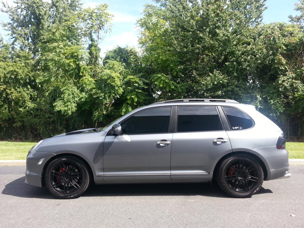

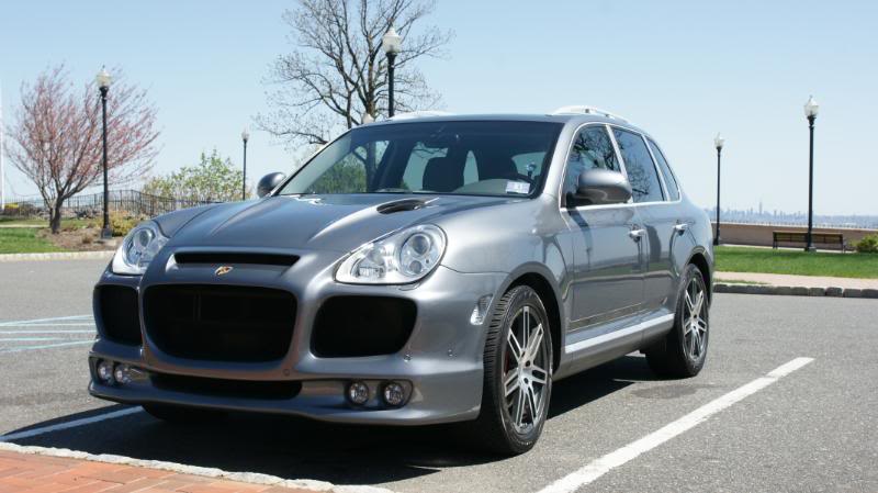

>> My 05 CAYENNE- TONS OF MODS, PICS, TUTORIALS, VIDEOS <<
Here is a index of every project done to my 2005 Cayenne S which started it's life as a bone stock S.
I am hoping this will be a journey to total bad-assness and I wont jump the shark at some point .
Feel free to ask any ??? you like, I am always avail to answer.
THE CURRENT STATE OF MY S (this will change frequently)
as of: 9/21/2013
PRIOR GLAM SHOTS

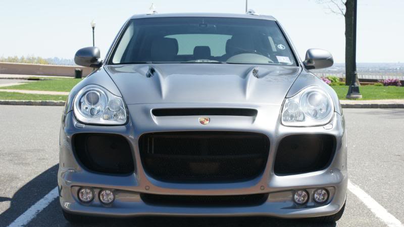

1. Front Nose Replacement (Jubily fiberglass):
http://s412.photobucket.com/albums/p...view=slideshow

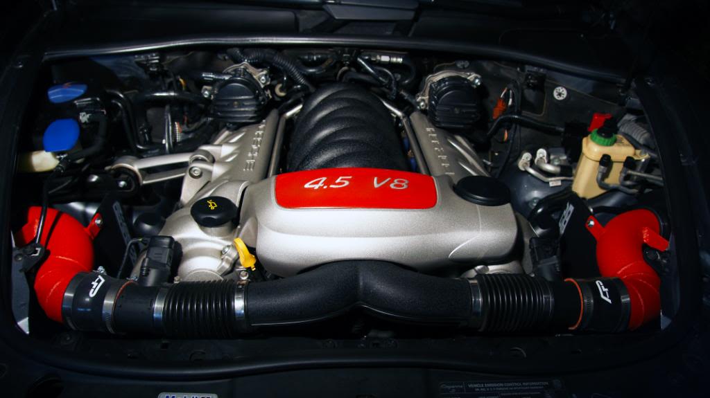

3. Agency Power Intakes: https://www.6speedonline.com/forums/...s-install.html
4. EVOMS Intakes & Sound Files (SOLD): http://s412.photobucket.com/albums/p...view=slideshow

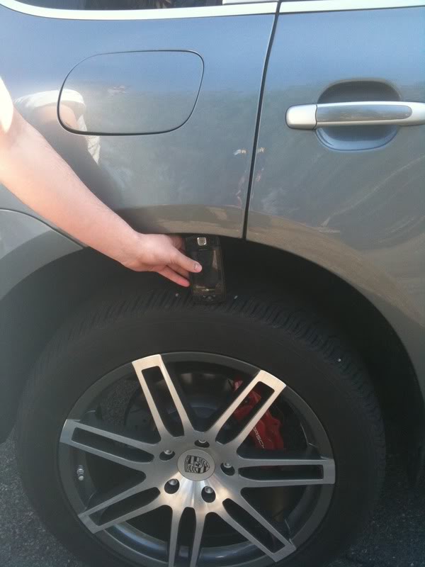

7. Clear marker lamps (Link Only): http://s412.photobucket.com/albums/p...view=slideshow

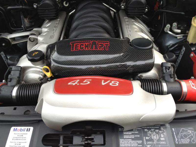

13. Carbon Fibered by Engine Cover: https://www.6speedonline.com/forums/...ml#post3524430

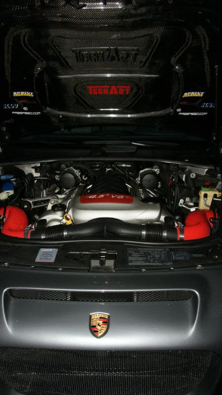

+ Evo Intake: you WILL notice a performance increase: Sound = like the new AMG 63 - Deep throaty growl that will make you smile from ear to ear. Total install time = 1 hour max. (The clamps are missing in the picture so no comments please)Purchased from Porsche dealer in PA (was listed on ebay).
+ Jubily Nose & Hella Lights with 7K bulbs: PROS: Looks for sure and the fit is amazing - direct bolt on/ CONS: Had to make a special bracket for the lights. / Had to make a custom wireing harness for the lights. / Had to paint the grills myself (they were silver - thats dumb) / Had to drill the sensor holes (but they were marked so not so bad) / Had to custom fabricate the headlight washer covers as the stock covers are too small. Also left the light washer mechanisms off as they would show through the grill. Purchased from Vividracing.com (Very, very, very good service - fast ship and great price).

+ Clear markers: Super cheap upgrade ($50) and looks bertter then orange for sure. Bought from bumperplugs.com / Excellent service!

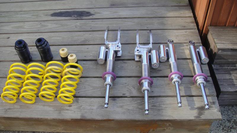

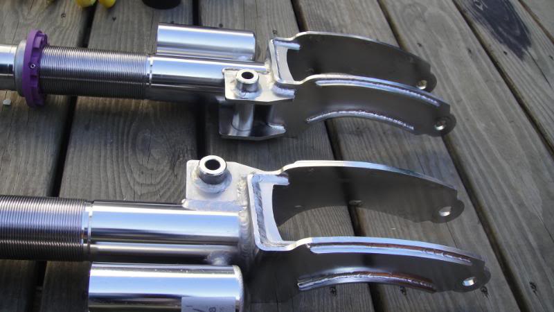

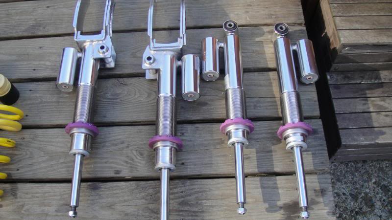

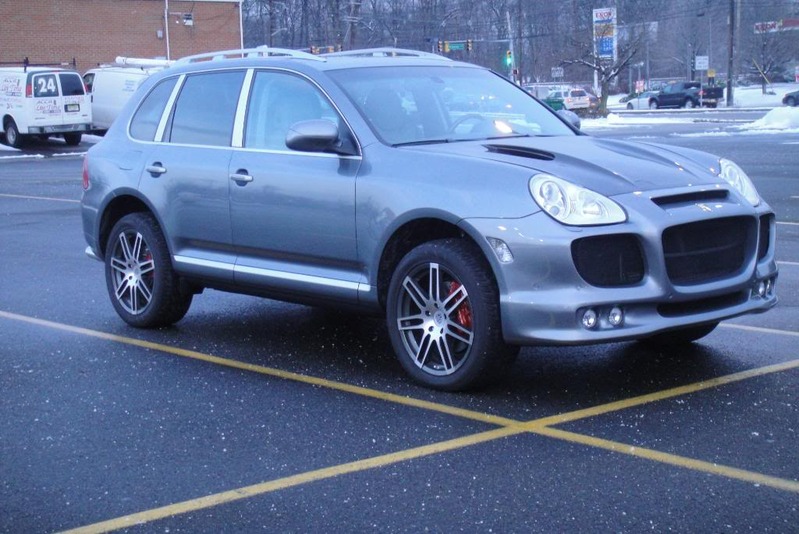

+ KW Coilovers: Bought 4 months used right here on this here forums! Install and align was a same day deal for me. Started at their highest settings and then spun them down 2 inches.
Took it for a ride, felt OK so dropped it another inch. Lowering them after they are in the truck is not that hard thanks to gravity. Raising them is a major Biach and it def requires the vehicle to be in the air. After 2 months at 3" I think I am ready for another 1" - then again, I am on 20"s . This was my favorite mod next to the Fabspeed exhuast. Screw the "sports button"!
Overall ride - Same smooth ride on the highway, bigger bumps are more jaring. Handling, well, lets say I am now at the limits of my 20" rubber and not the suspension. ZERO body roll. BTW - I set all the damper adjustments dead center.

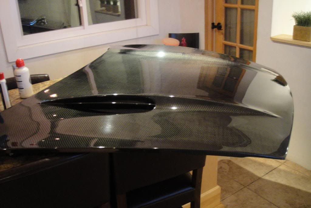

+ Carbon Fiber Skin of Dashpod: If you can work with fiberglass than CF is about the same. Bought all materials from carbonmods.co.uk. From UK to me in 3 days

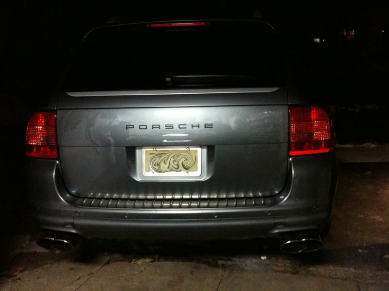

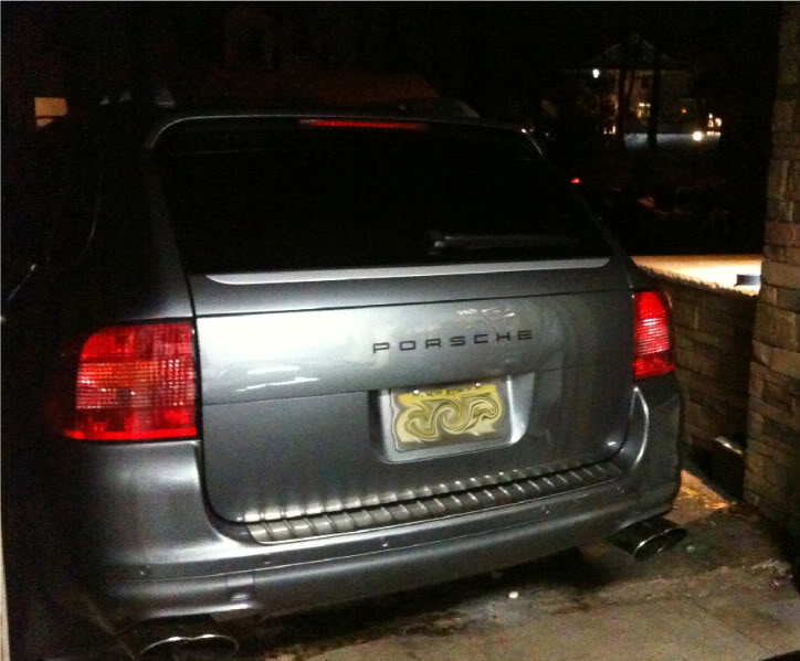

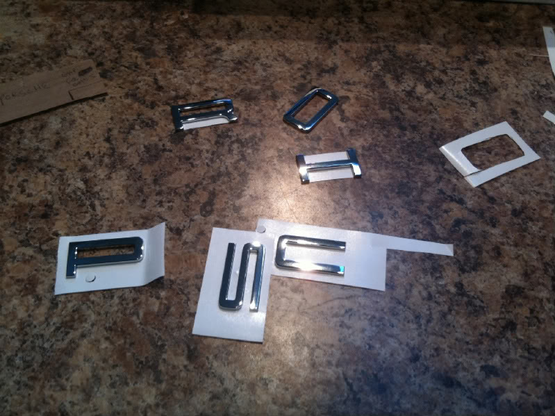

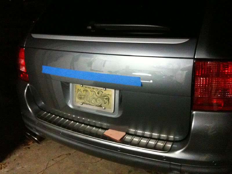

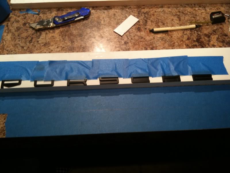

+ Rear "new style" Porsche: Love it, but the letters must be very carefully aligned before you install them. If you suck at math, stay away from this mod! For reference, the Part Number is: 970 559 235 01

2. Installed Techart Hood
3. Installed 20" rims and 275/45/20 yokos
4. KW Coil Overs (Dropped 3" and then later spun down to lowest settings
BEFORE:
The KW kit (minus the wrench)
AFTER (with the 3" drop - not full drop)
5. REAR LOGO ( PN #970 559 235 01 ):

Intakes - They are evolution motor sports and I installed them myself. I found them on ebay being sold by a Porsche Dealer. Cost was a steal at $410. Here is the link to the manufacture http://www.evoms.com. Here is a link to the cheapest I found them (its a retail store in florida that will dropship them to you): http://www.vertexauto.com/ShowItem/2...ler%20Kit.aspx
