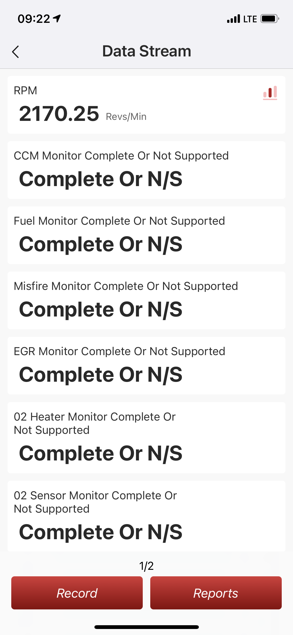

ThinkDiag OBDII reader and code P1000
Hello. I have not been able to clear P1000 to get the car smogged. I did clear misfire codes from 4 and 7 by moving the coils to 3 and 6 to determine if they were bad. They have not thrown codes since the last clear (72 km) I think that clearing the codes also resets P1000 to start over again? Does anyone know if these are the monitors that need to be completed for the code to go away? The reader and software are good, only that there is very little info or support on it.

Yes, those monitors need to run after you clear codes to remove P1000

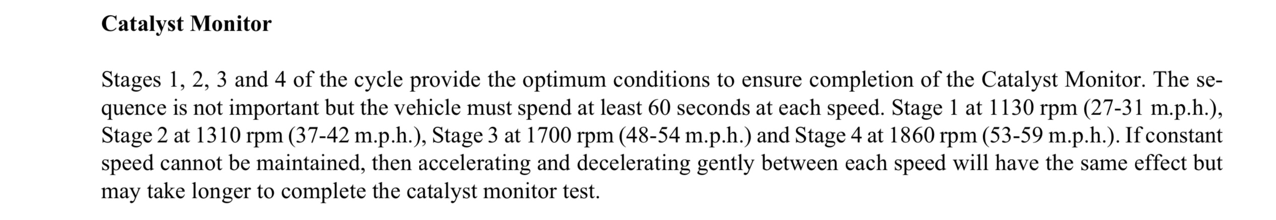

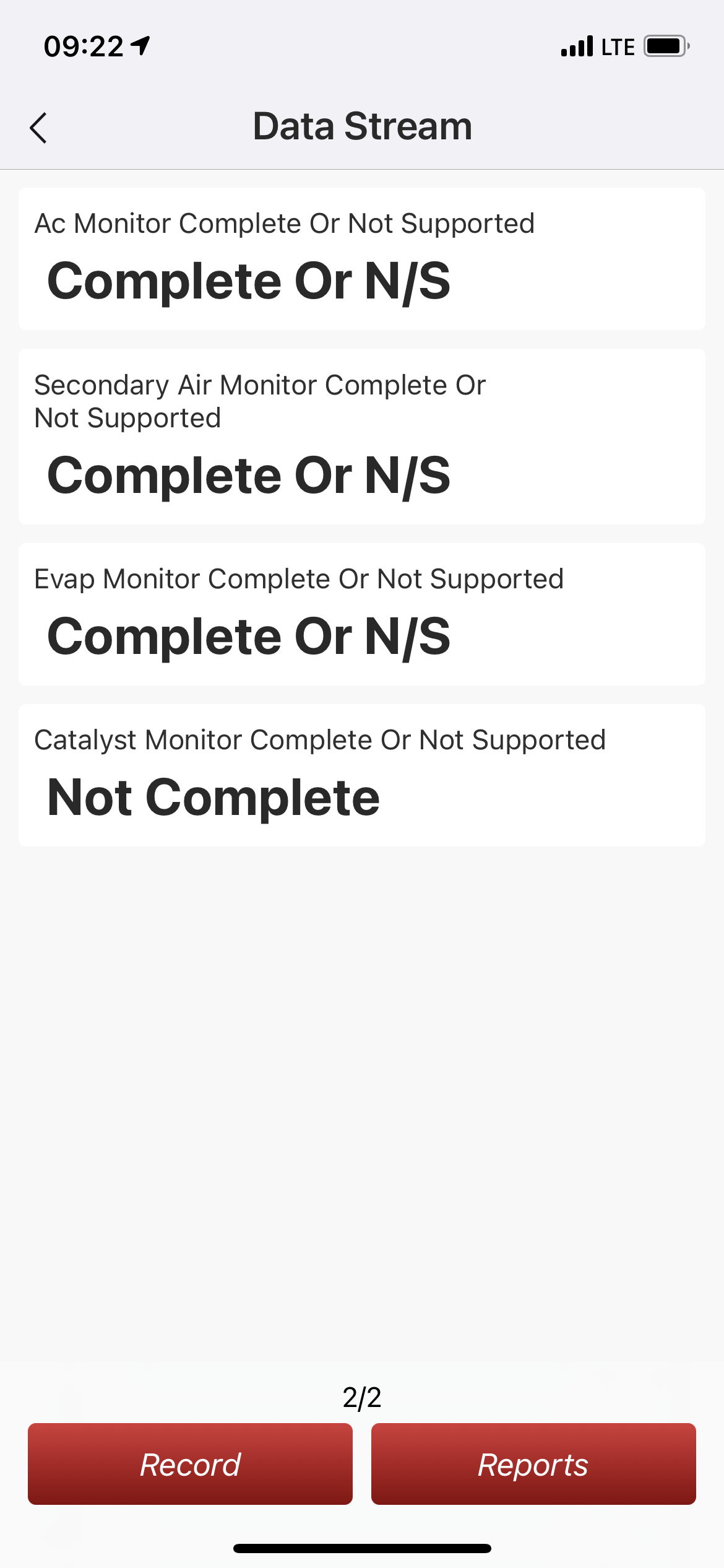

I have tried and tried to get the Catalyst monitor to reset and simply does not. I am following both the V8V and the Ford procedures below. Do you know how hard it is to keep 1130 RPM for 60 seconds?? What were they thinking of!! Anyway, I am going to try again later today. Its not easy to find a road to do all this jumping through hoops either. Any other suggestions are welcome.

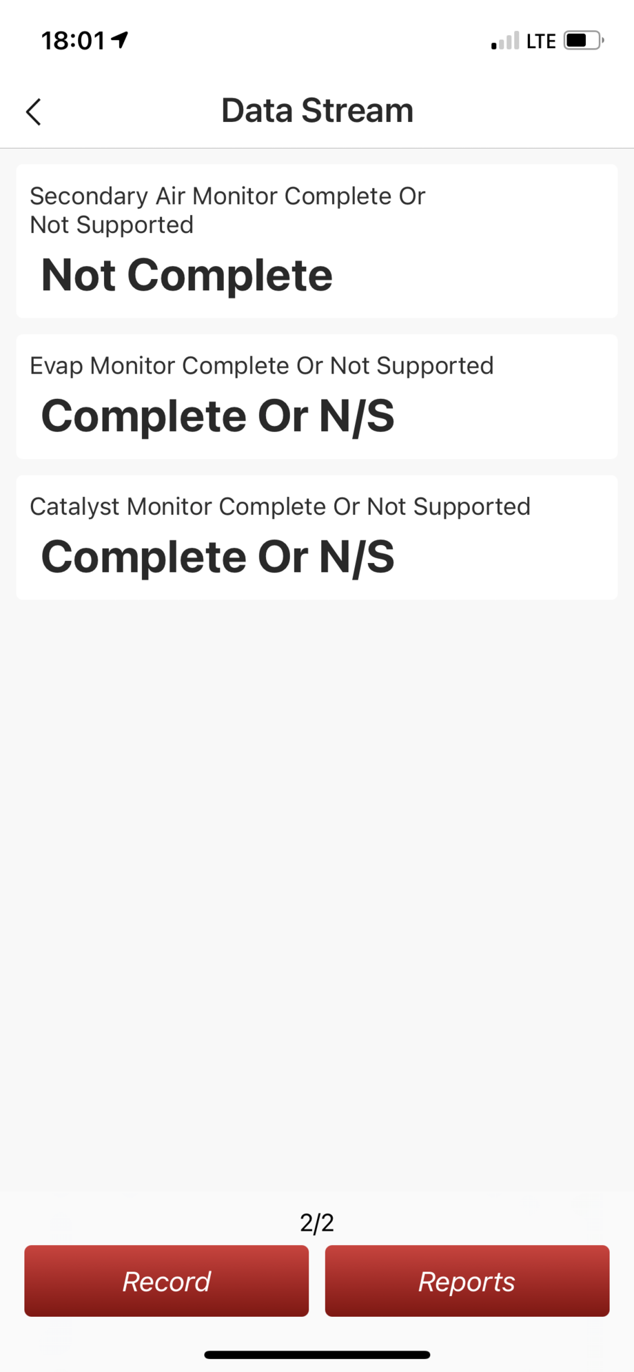

Aaarrggg!! Finally cleared the Catalyst monitor and now the Sec Air Monitor is not clearing. Let’s see what happens tomorrow.
