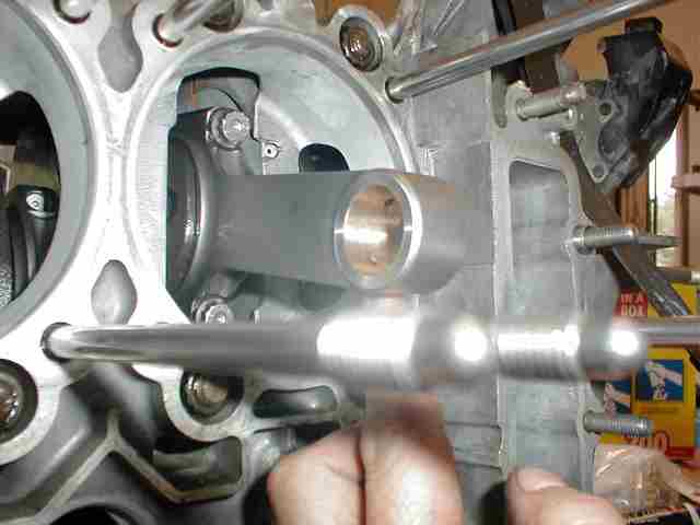

Old Aug 29, 2003 | 06:09 PM
  #73
PorschePhd's Avatar
Posts: 3,670
Rep Power: 189
PorschePhd has a reputation beyond reputePorschePhd has a reputation beyond reputePorschePhd has a reputation beyond reputePorschePhd has a reputation beyond reputePorschePhd has a reputation beyond reputePorschePhd has a reputation beyond reputePorschePhd has a reputation beyond reputePorschePhd has a reputation beyond reputePorschePhd has a reputation beyond reputePorschePhd has a reputation beyond reputePorschePhd has a reputation beyond repute
Next should be a set of these.....
Old Aug 29, 2003 | 06:10 PM
  #74
PorschePhd's Avatar
Posts: 3,670
Rep Power: 189
Then 4 more of these....

Stephen,
Already have my rods. What are you trying to say in the second pic?
