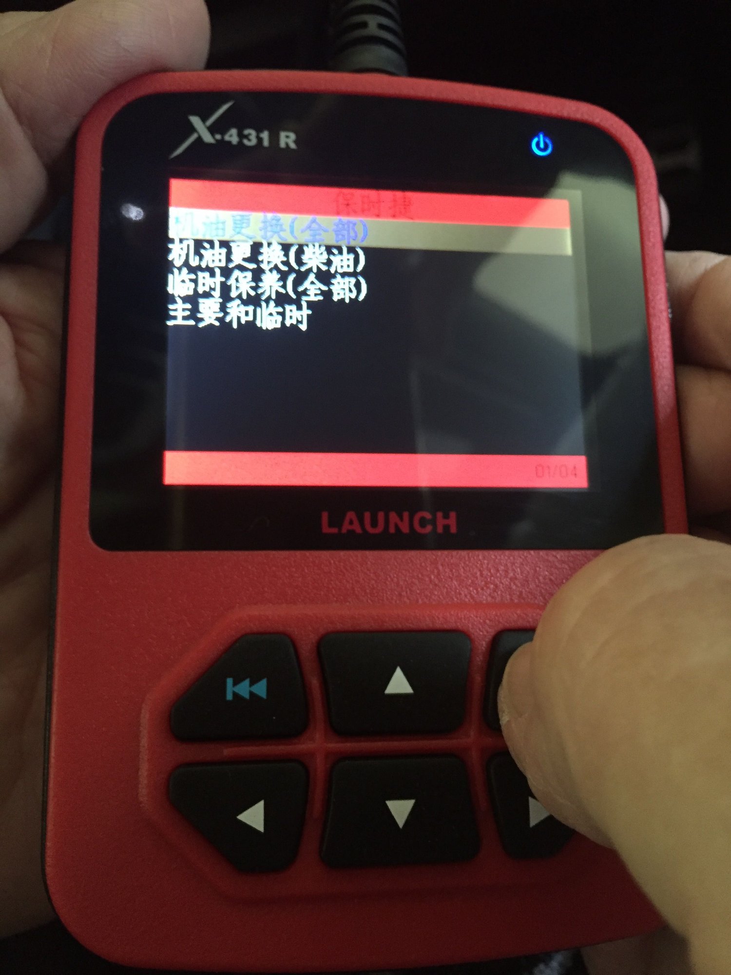

Oil Reset using X-431 R tool
Reset my Cayenne 2012 Oil Change warning using the X-431 tool:
Worked for me today on my 2012 CTT and others on other posts. Plug the X431R into to OBDII port. Turn on key.
Mine came with Chinese menu and instructions. Here's the way to get it into English menu. You can also access the menu by plugging micro USB cable into port on bottom and connect to power supply, then press the blue button to exit to the normal menu where you can use these instructions to set English prior to bringing out to car. Chinese is in same position as English.
These are the English equivalents of the screens.
First screen take the second to last item down (Tools)
See below:
If in Chinese, scroll down to second to last item and press green return button.
press green return
select language press green return
on third page second item down is Porsche
After completion you will see a place where you set the date and choose interval. I did the reset in Chinese so I don't have the English equivalents.
reset interval?
set date to go from.
progress menu
porsche in chinese
